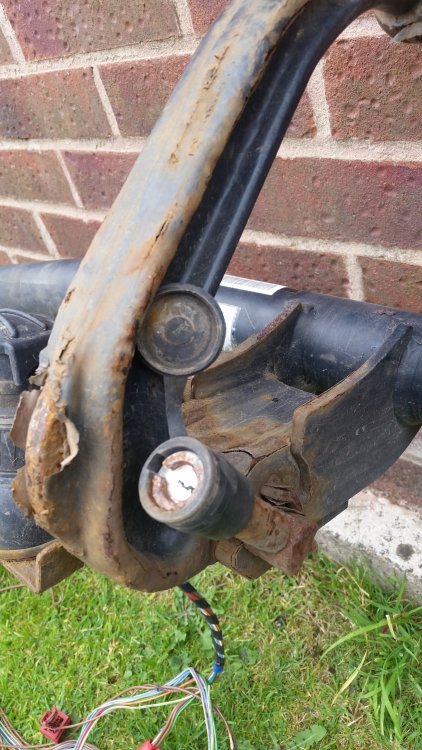

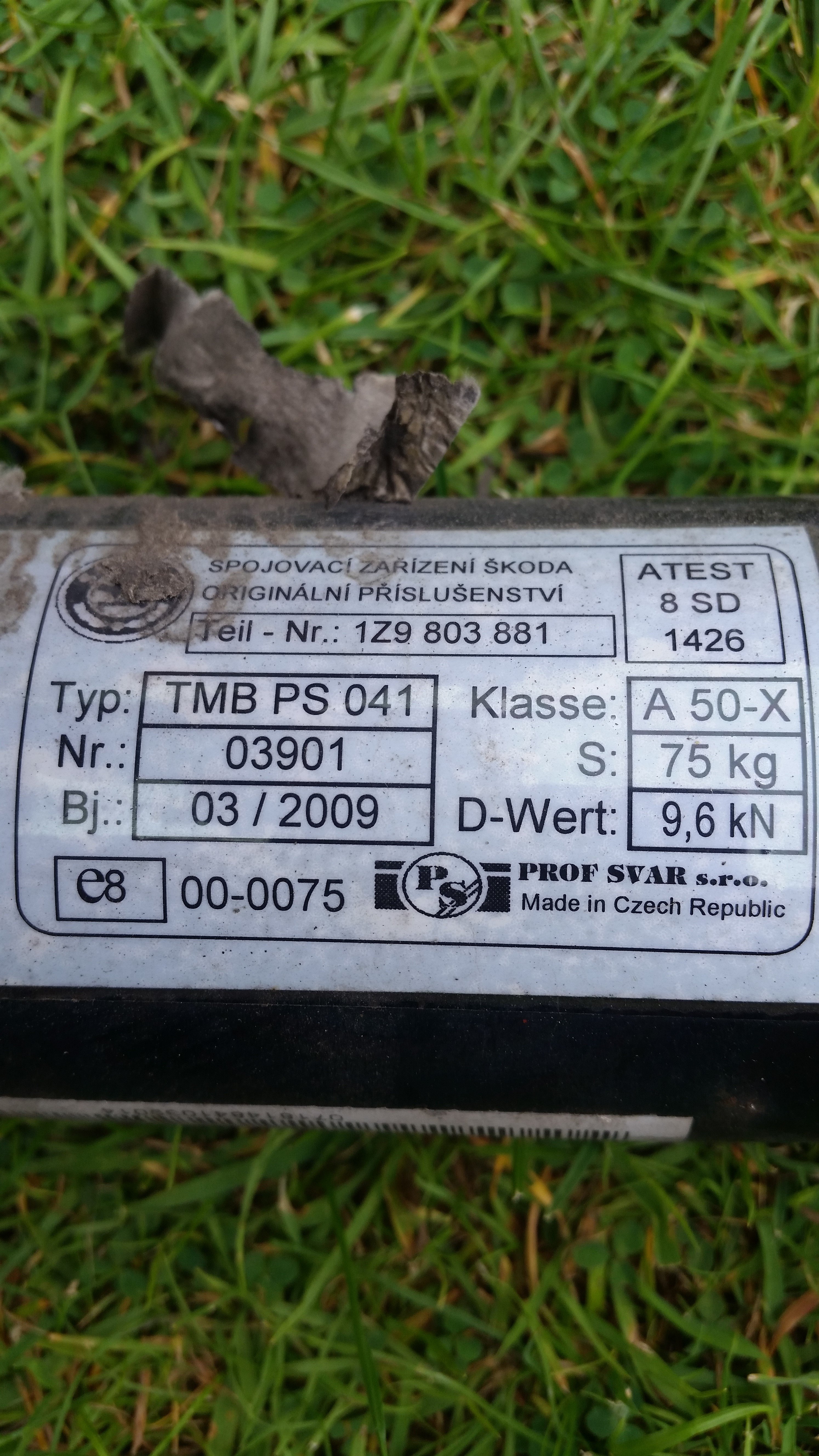

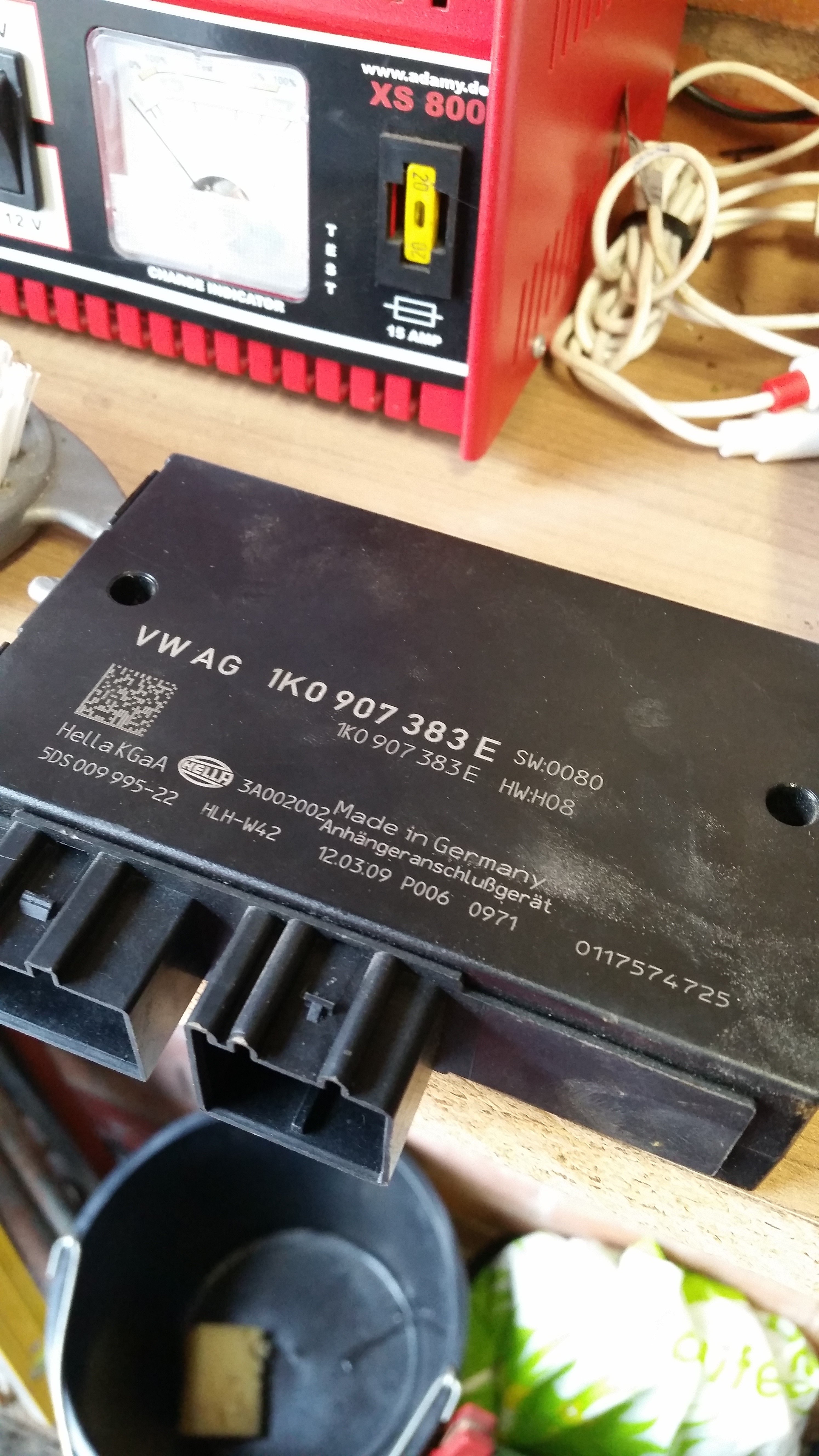

hi ive got a 2009 ovctavia vrs tsi petrol and ive fitted a genuine removable towbar to it and now im after a bit of advise please with the relay control box thats been supplied with it , ive no idea where it plugs in , it looks like a plug and play type , ill try and add some pics , any idea where it would have sat in the octavia it was taken off , plust its a removable towball but i havent got a key for it so its locked on permenent and now my rear parking sensors aresounding like mad , where do you think i can get akey from , cheers
That's a genuine towbar module not a relay module.
If your car wasn't ordered with towbar prep, you'll nee to run wires the length of the car for power, ground and CAN at a guess. I'm not sure if Skoda sell a wiring loom separately or not :)
Might be easier to use a bypass relay and not bother with this module .just sell it on .
I only need the lights working for my bike rack .don't need for a caravan split charging or anything ...would a bypass be a llot easier
ebay item 191916631605 is a complete set up including the wiring, module etc if you want a plug and play solution.
Thanks that will be easier .hopefully my bulb warning won't pop up
