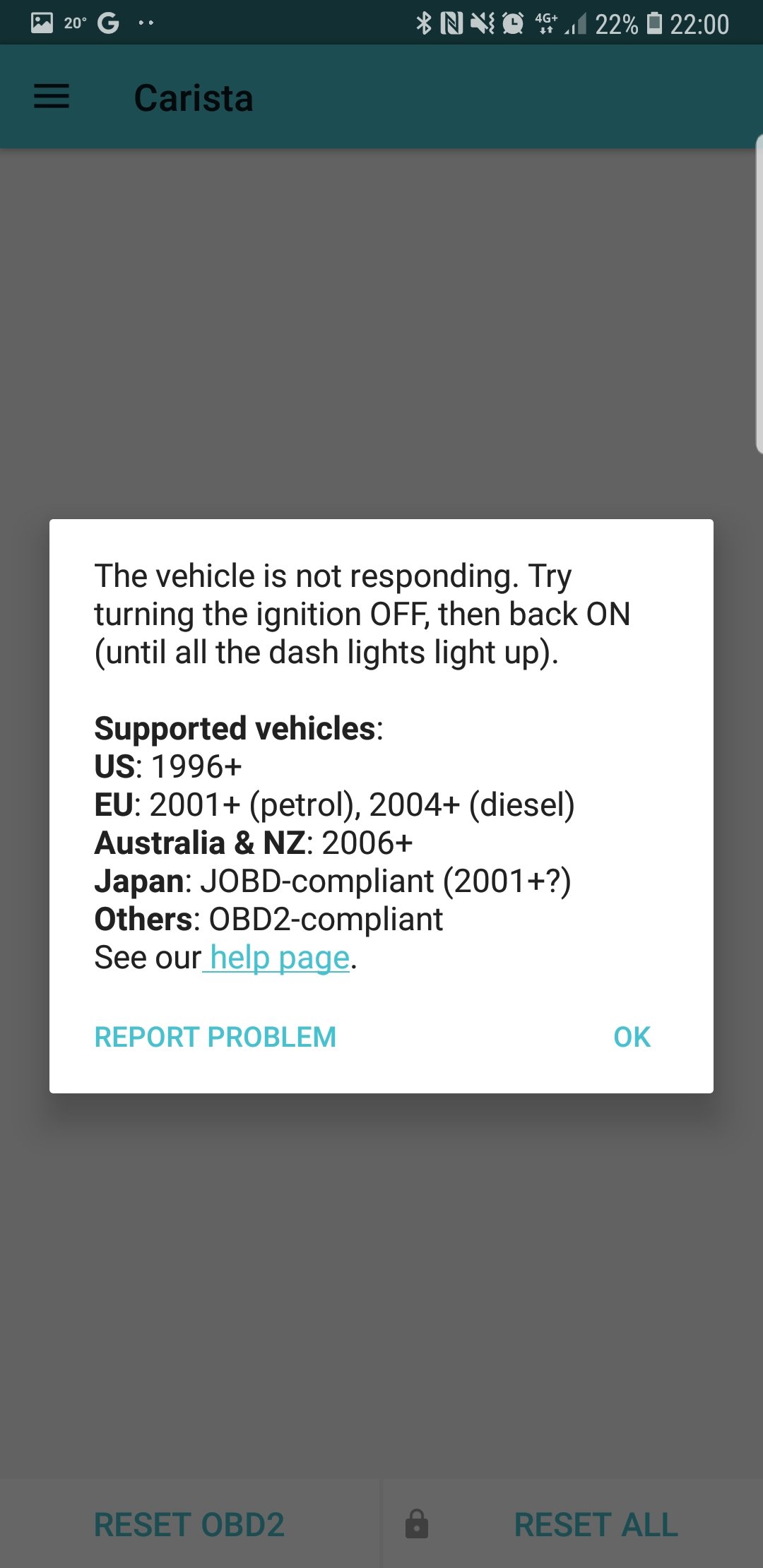

Well i cant seem to get what appears to a very simple process to work...
Has any one had teething issues.
So plug it... red light after a little blue flash.
App downloaded...
Ignition on... fire up the app....
Nothing..
Code reading gets 30% stops
Customisation gets to 5% before going to a list of car makers .... so im stumped...

I dont stop it or interfear with it. I let it run is course...
Ive tried a couple apps.. and so far it seems like the bluetooth connection works. Its just not reading the ECU... which is odd!
Ive attached a screen shot of one of the errors.

This was my thinking and iphone acted the same! Horrible feeling the car is the issue....
Ive been sent a new one and all working.
