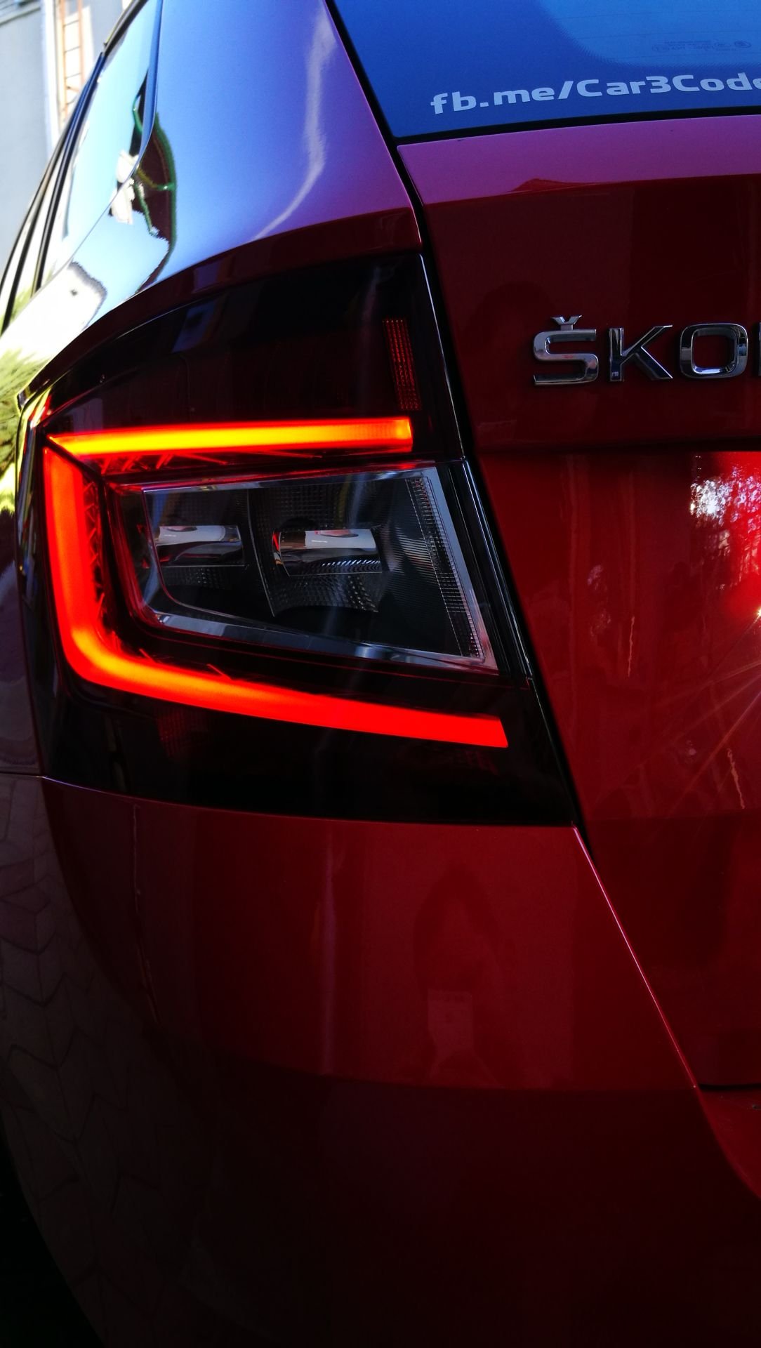

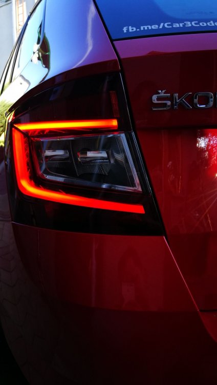

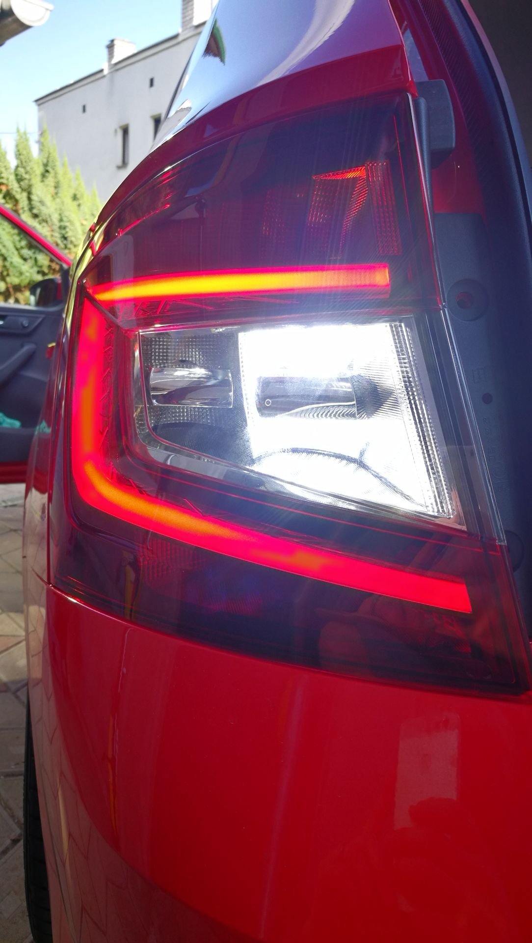

most of them have noticed that the full LED rear lights will be used on the new facelift version. I had the opportunity to shrink the rear Full LED lights from the facelift version to ours before the facelift. my friend ordered them and had them mounted first, but without lighting. let I say that:
I´m first successfully light on, mounted and coded the facelift lights ... :)
I can prepare an article over time, this is just basic info and photos. the car is available for viewing in the east of Slovakia, in the Czech Republic is friend in Prague (but I do not know if it will be willing to show it)

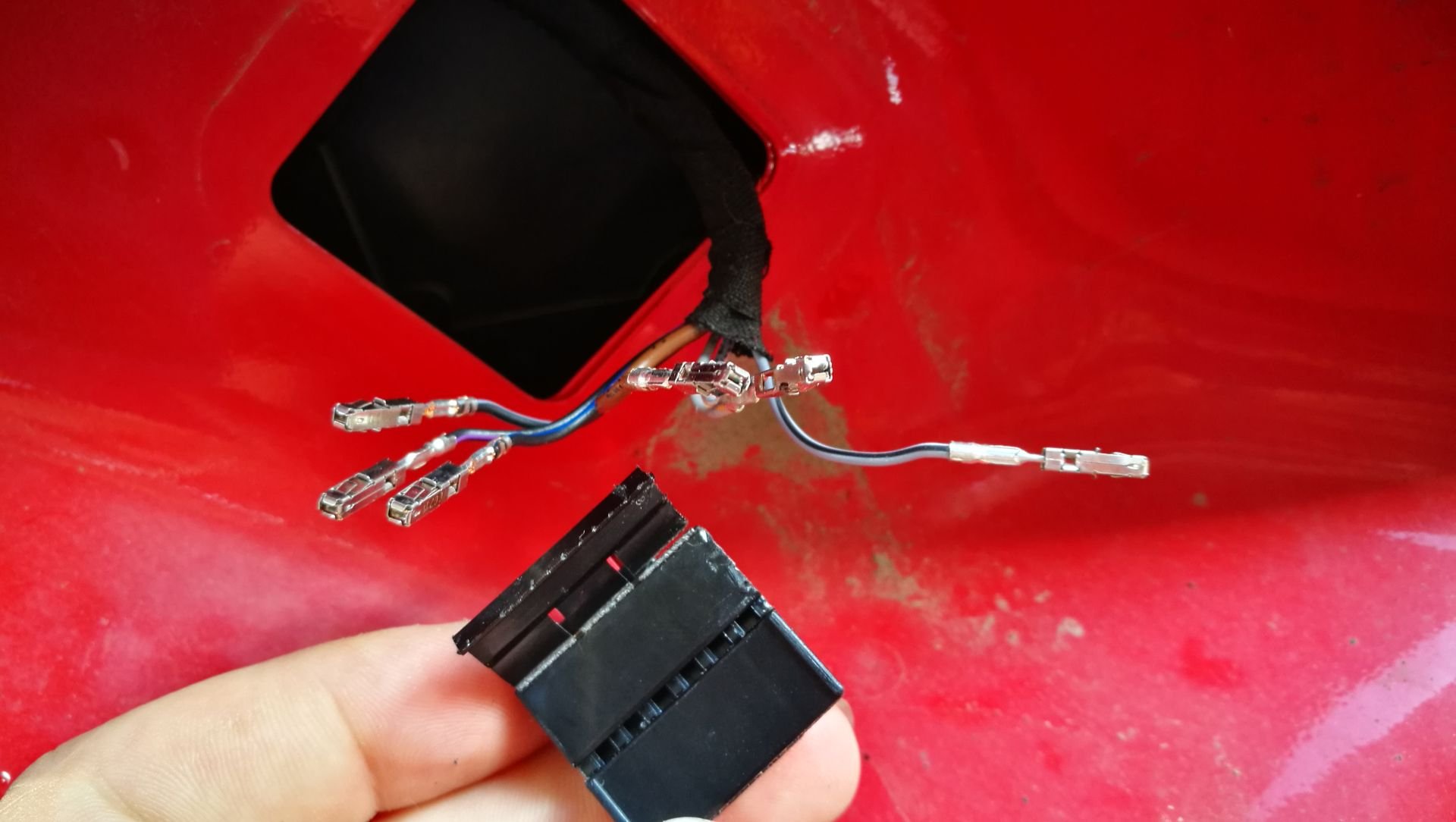

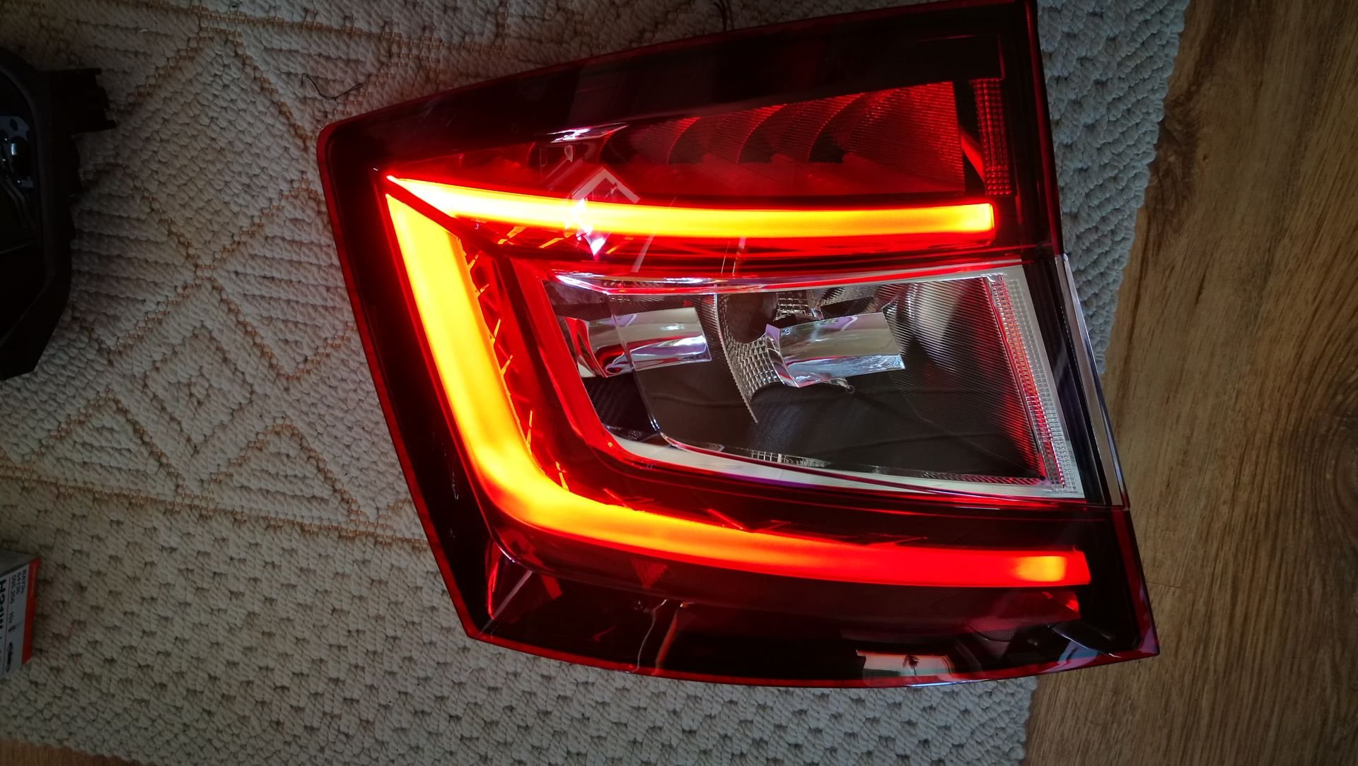

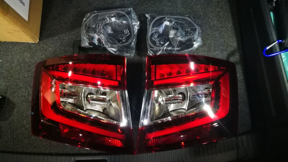

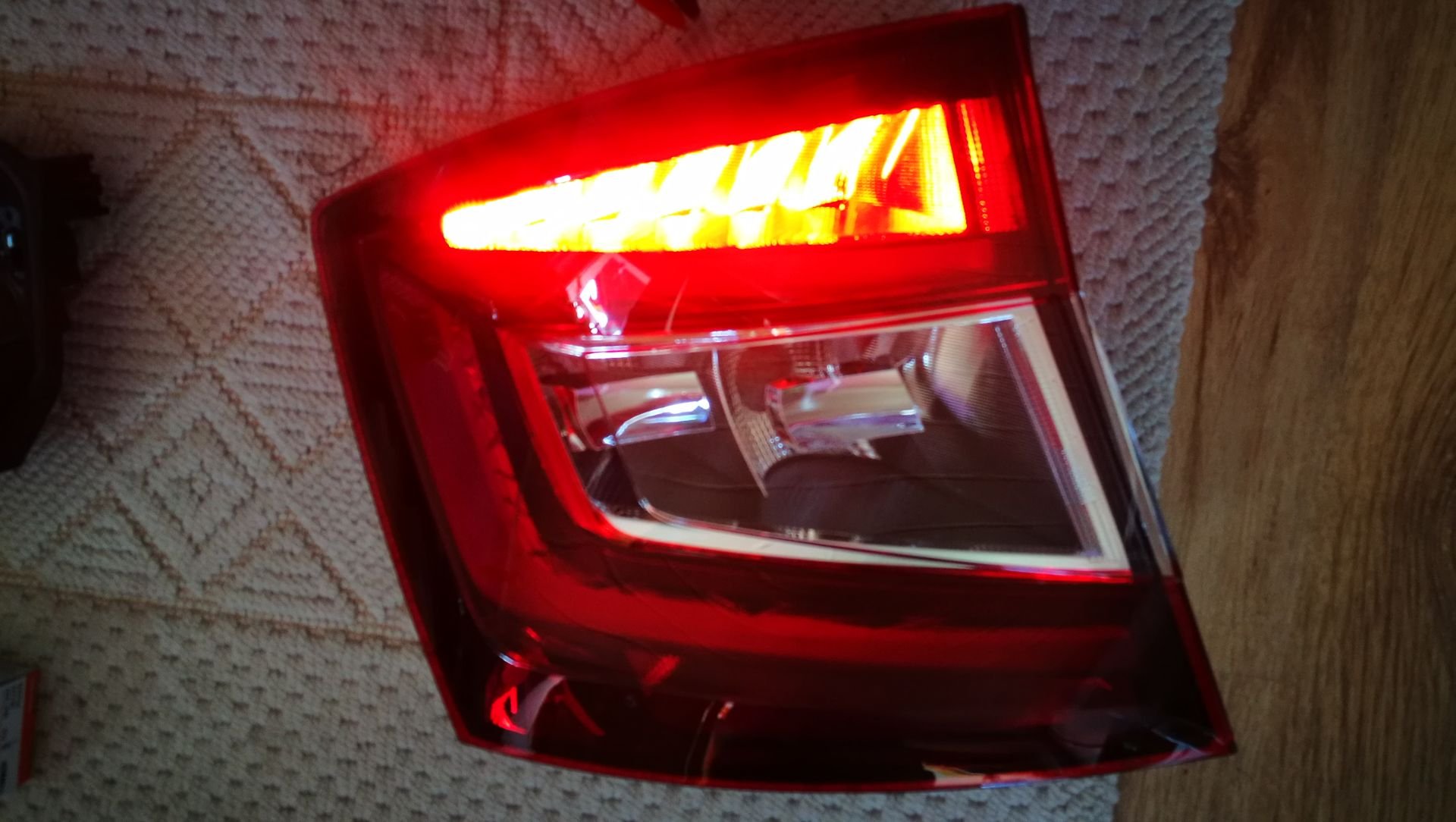

unwrapping / test in living room on battery / pinout:
001.thumb.jpg.4ba9659f04795cdc0230500a5e759b15.jpg 002.thumb.jpg.20275cac0bd76aeab3282eff13ba648d.jpg 003.thumb.jpg.1a74c29c7fc8177ecae6ffcf8e7ed8da.jpg 004.thumb.jpg.2ef74360c73ec749f22085a983cec6b8.jpg

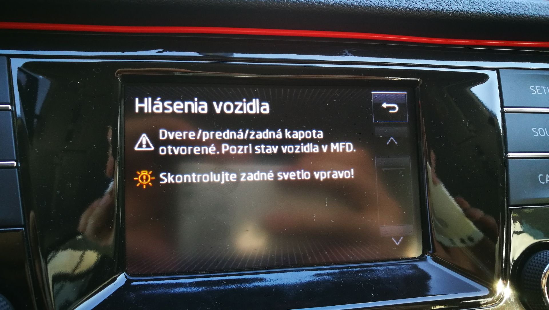

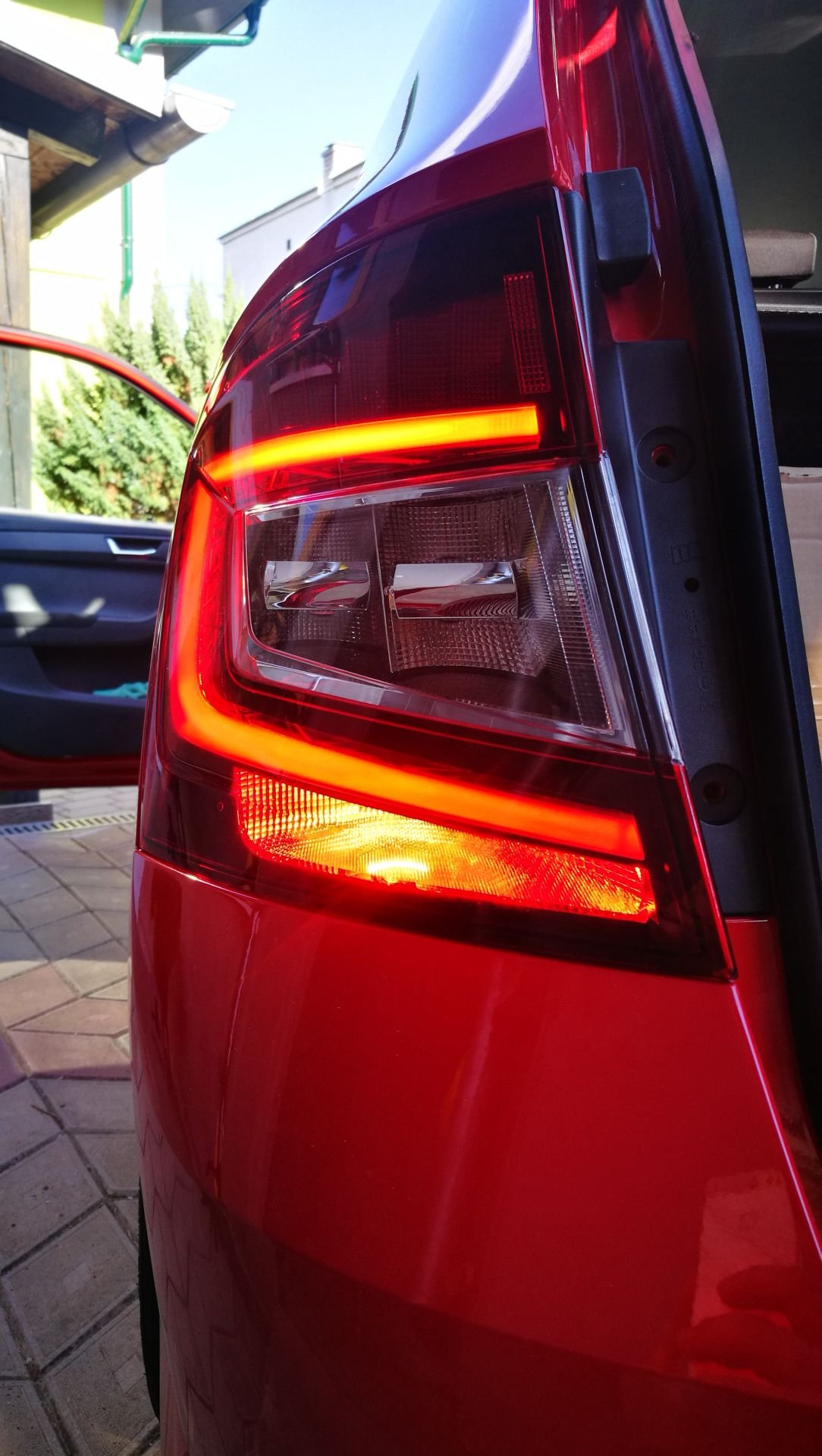

test in car - left Full LED, right without any lights -> error, check the rear lights

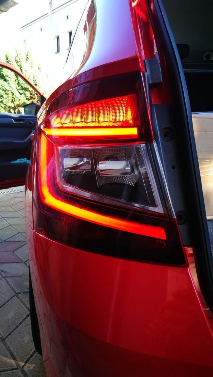

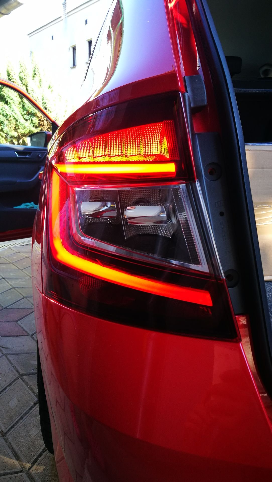

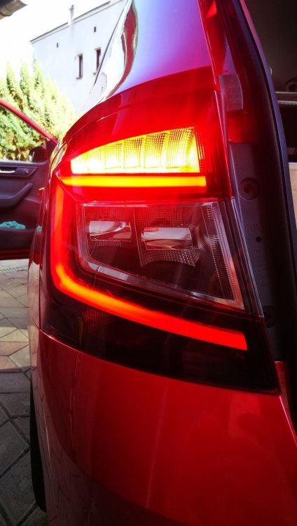

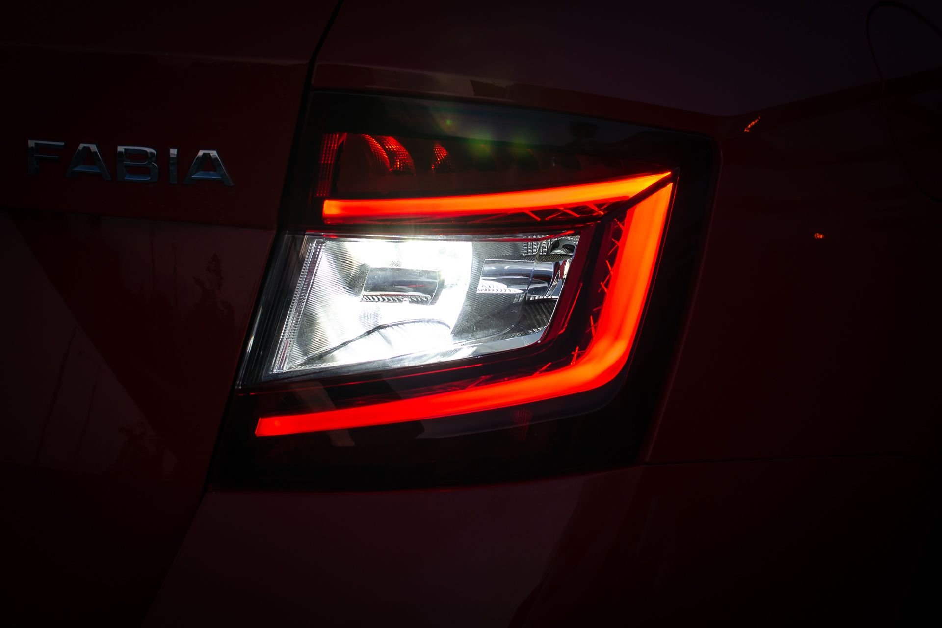

without coding / after coding / fog / brake / backup:
006.thumb.jpg.0900c4d2c07801abf97e9c58dfc01739.jpg 007.thumb.jpg.5a86d9f9a77d8122a020c5730c750330.jpg 008.thumb.jpg.a6f4b0f8a6e4331b696d1d00e8f0cc99.jpg 009.thumb.jpg.fbe2e7dac3fcbfda5510ad98c06f1088.jpg 010.thumb.jpg.a8222c8ab8d8be606d2f0bb9197409e5.jpg
off / on:
011.thumb.jpg.c32e34145971c1ed02afc27f501d62e7.jpg 012.thumb.jpg.8d7afa0abd3e2f1322c64f48e33e9fc7.jpg

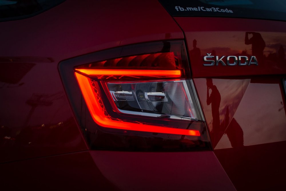

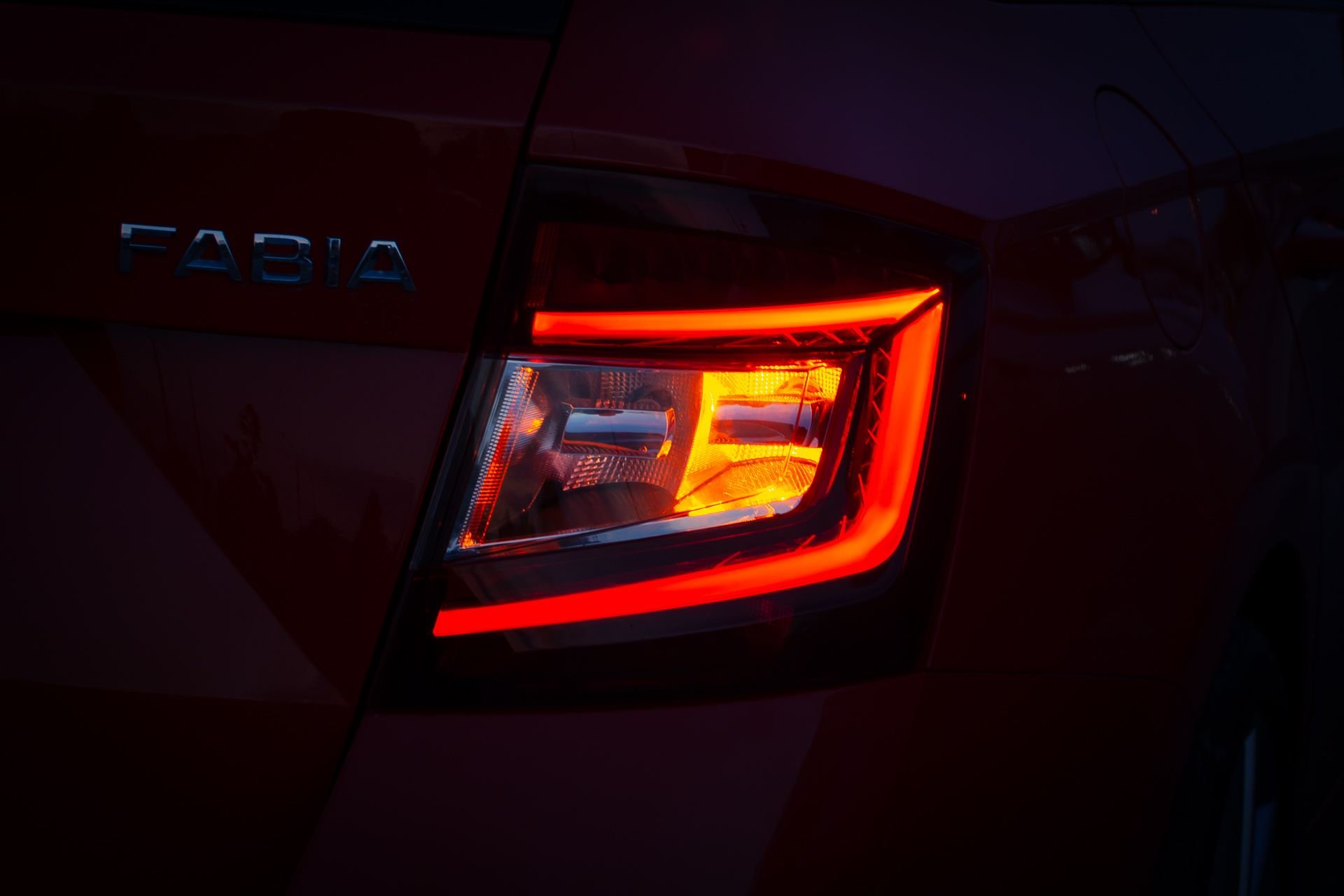

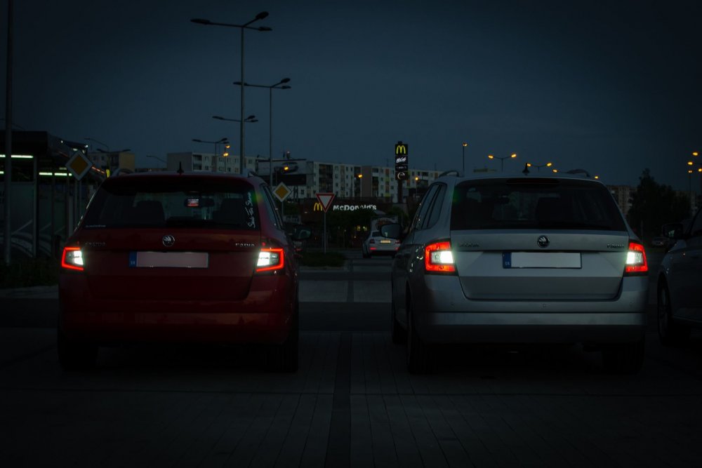

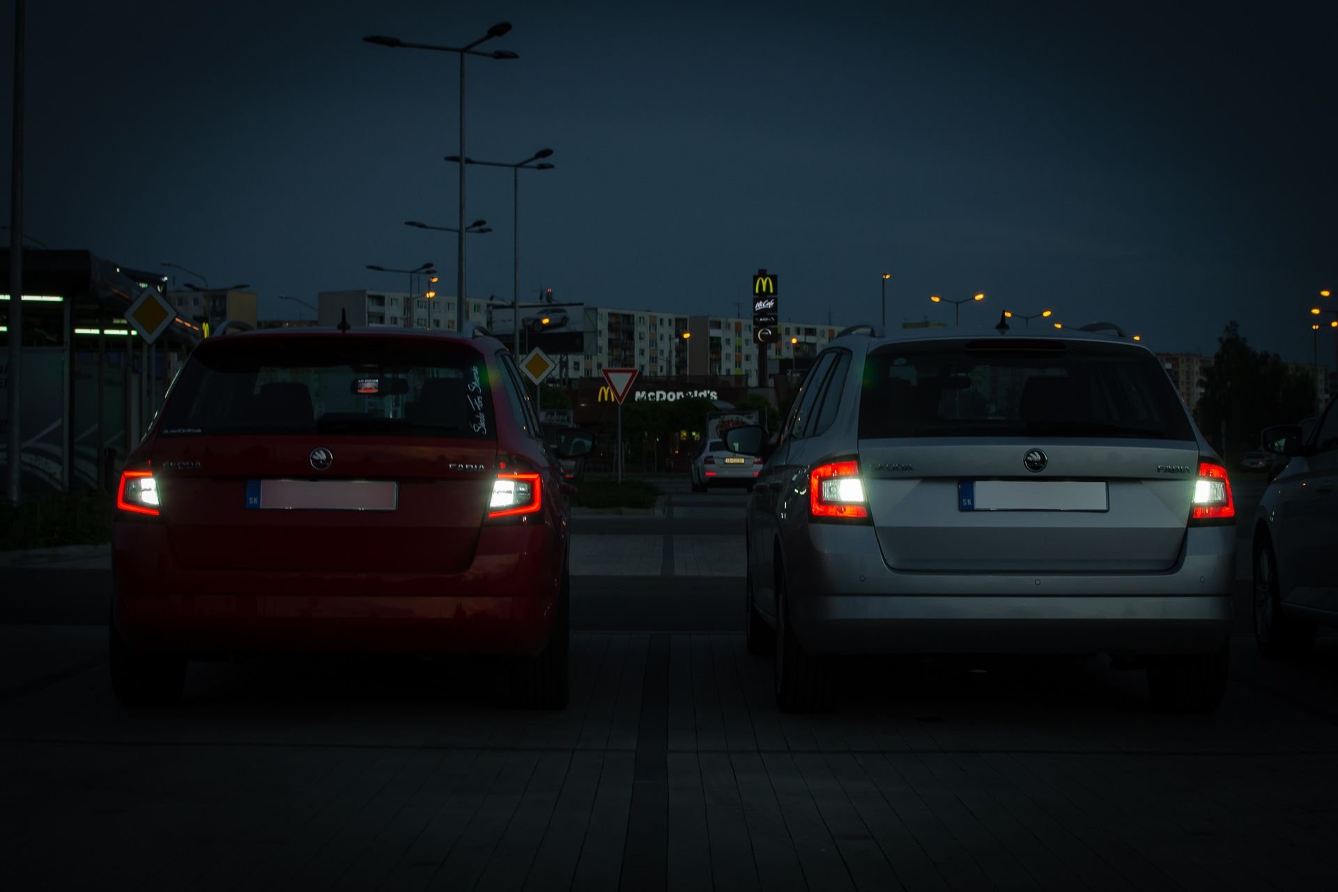

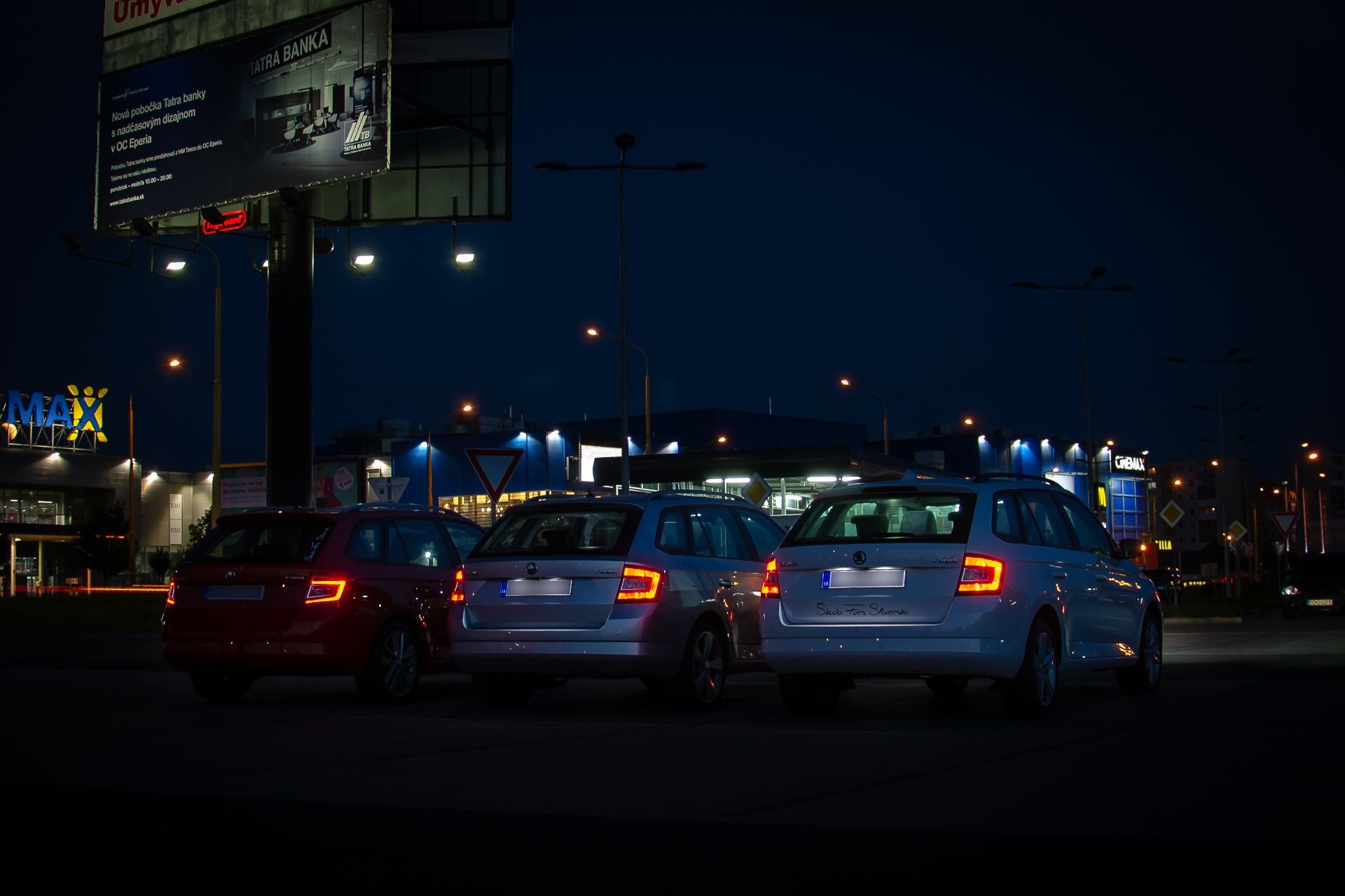

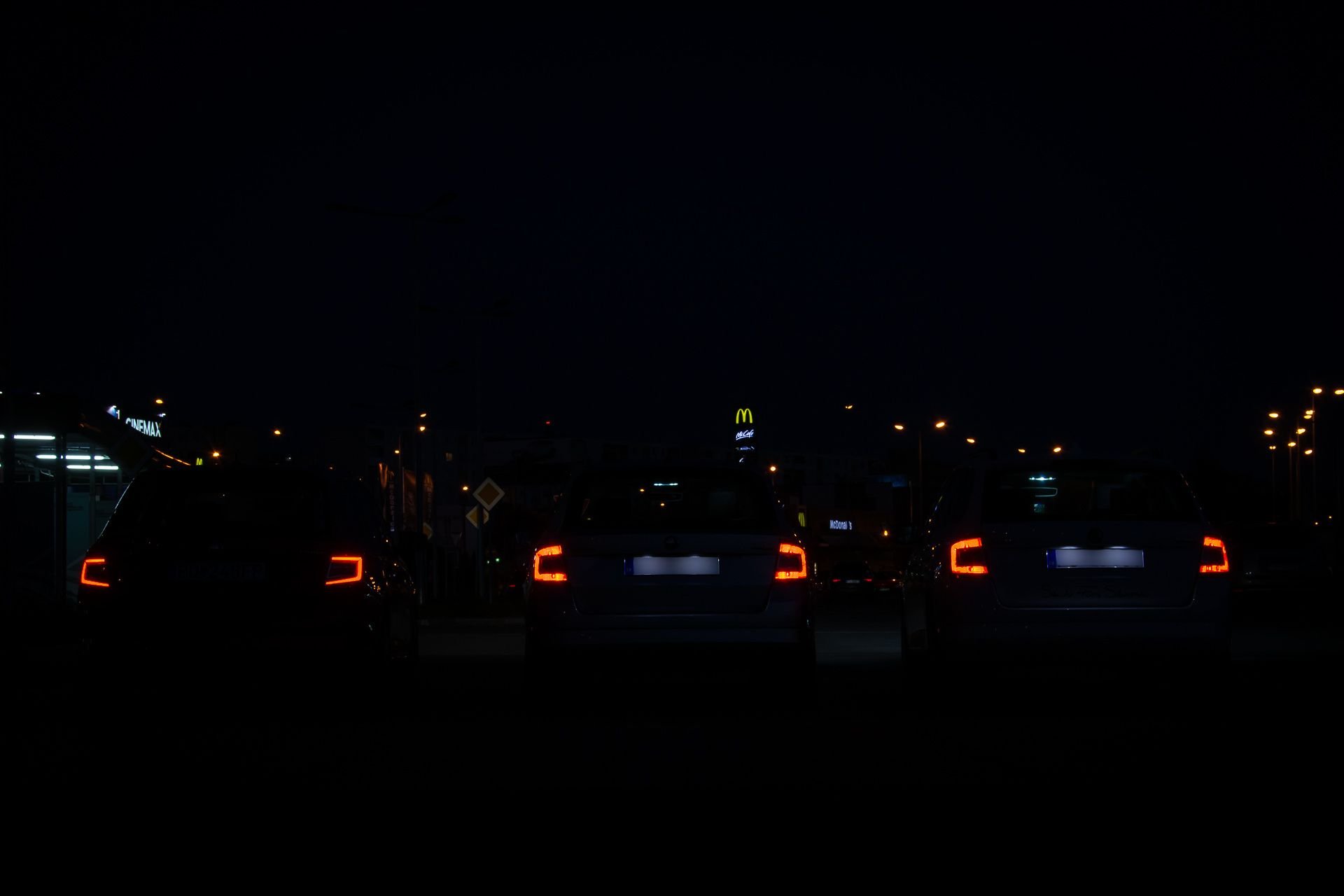

another friend offered himself earlier to capture better night shots, including comparison with regular lights
013.thumb.jpg.d6234308c28a83dc0137d8dcb6dff945.jpg 014.thumb.jpg.3a5b5c40260b86ea0a1614677b82ba45.jpg 015.thumb.jpg.200dd3849b18c3005c500532a9c42c68.jpg 016.thumb.jpg.5019f245bd90adf67859c99a5432ed65.jpg 017.thumb.jpg.5a4cac4c68ce6a5618ed5412ffbb027f.jpg

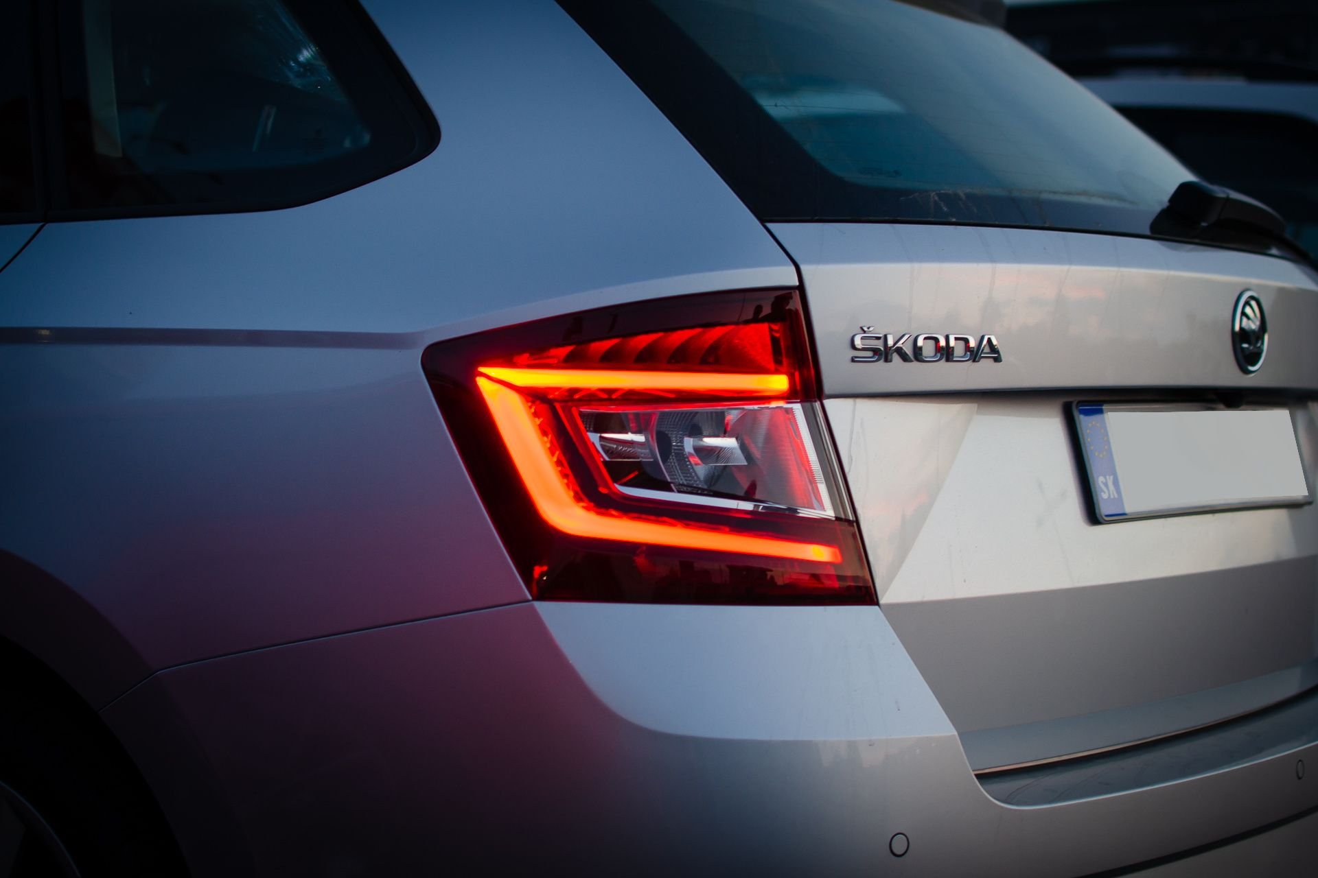

test on silver and white car:
018.thumb.jpg.bf0f76eed72cdbe3fe11f2bcecc7bbaa.jpg 019.thumb.jpg.31eb51cca342887d03a74531e58f4ad2.jpg

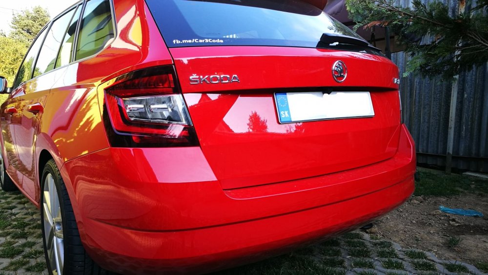

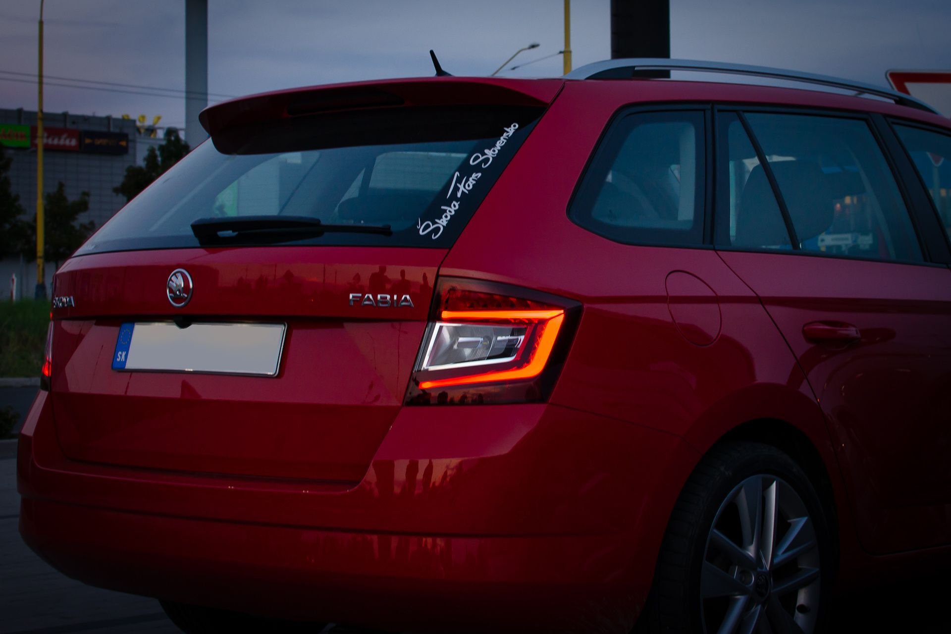

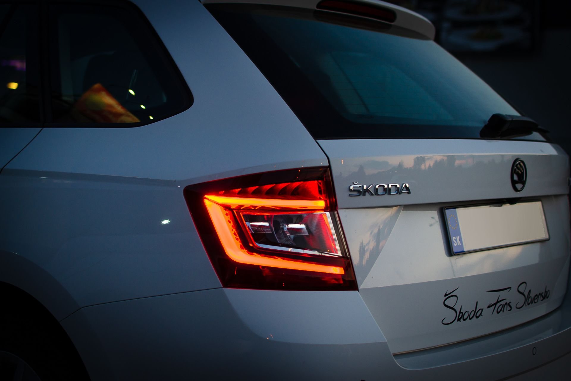

final photos:
020.thumb.jpg.4556cceedb413dc1b1fcb85a18fd1bcb.jpg 021.thumb.jpg.b30f442e2d38fab94ddf3aa66d9e2373.jpg 022.thumb.jpg.8e30c53fee964883cd248faf2f7f9e79.jpg
price: about 300 - 320 € of pair
exchange is not complicated. it is necessary to change the order of the pins in the connector and to encode it. the difference is in the fog lamp, the designation H21W BAY9S. directional and reverse are identical, just replace
sorry for my terrible English. if it is my power, I will answer the questions
Edited by wirer

Very nice retrofit ! I am about to pull the trigger on the tail-lights myself and would really appreciate if you could detail the necessary coding . Do you happen to have the pert numbers for the lamps for the estate variant?
Thank you !

Hi,
Can i replace from my Skoda Octavia 2014  Led rear tail ligt to  LED Rear tail light from Skoda Octavia 2018

Hi, Iv ordered a 2020 fabia colour edition and have ordered the LED lights for a Monte Carlo, will the lights be plug and play or will I need to code these (have you got coding) also will the wiring pins need rearranging?
All the info is in the original post.
