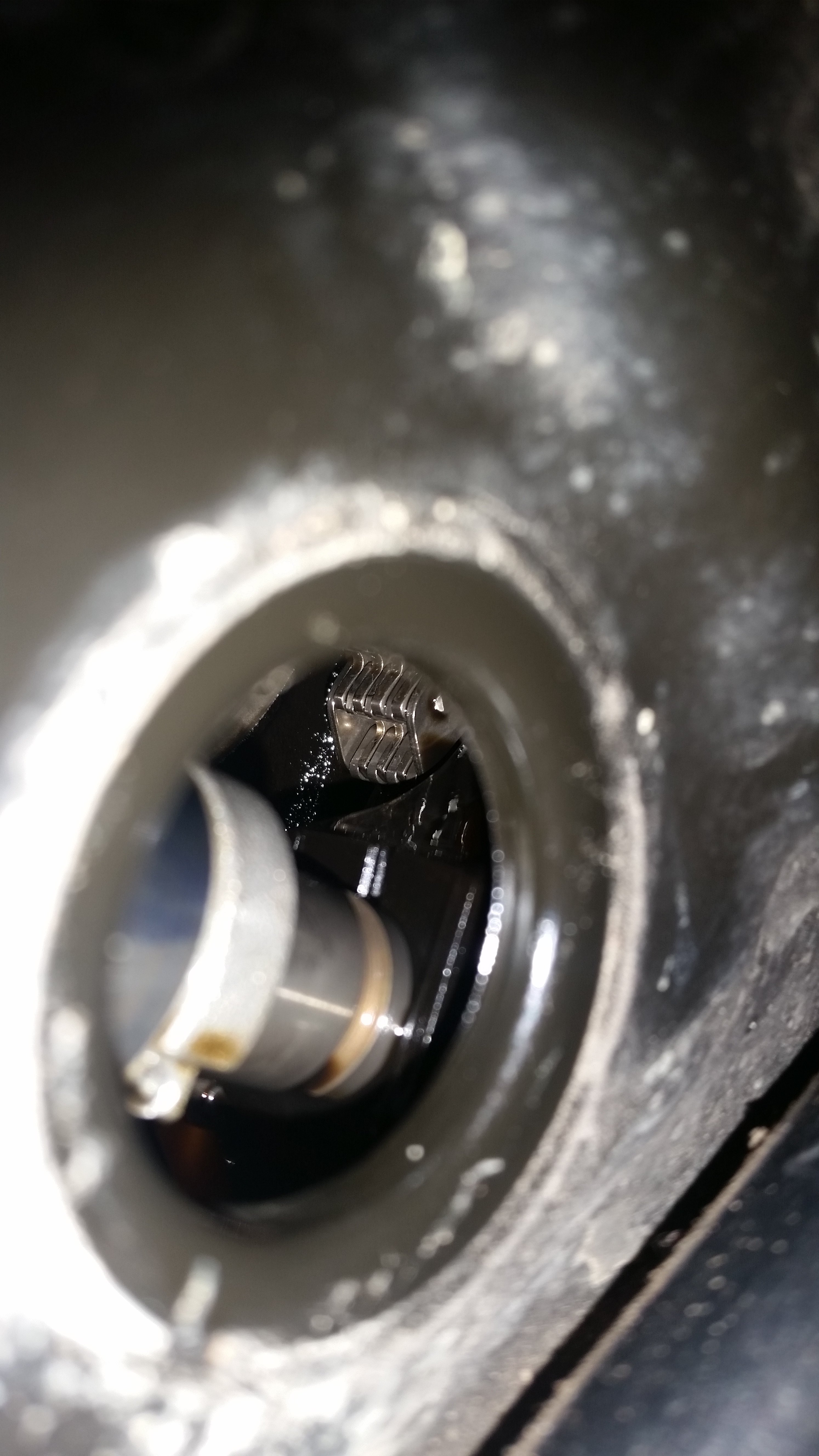

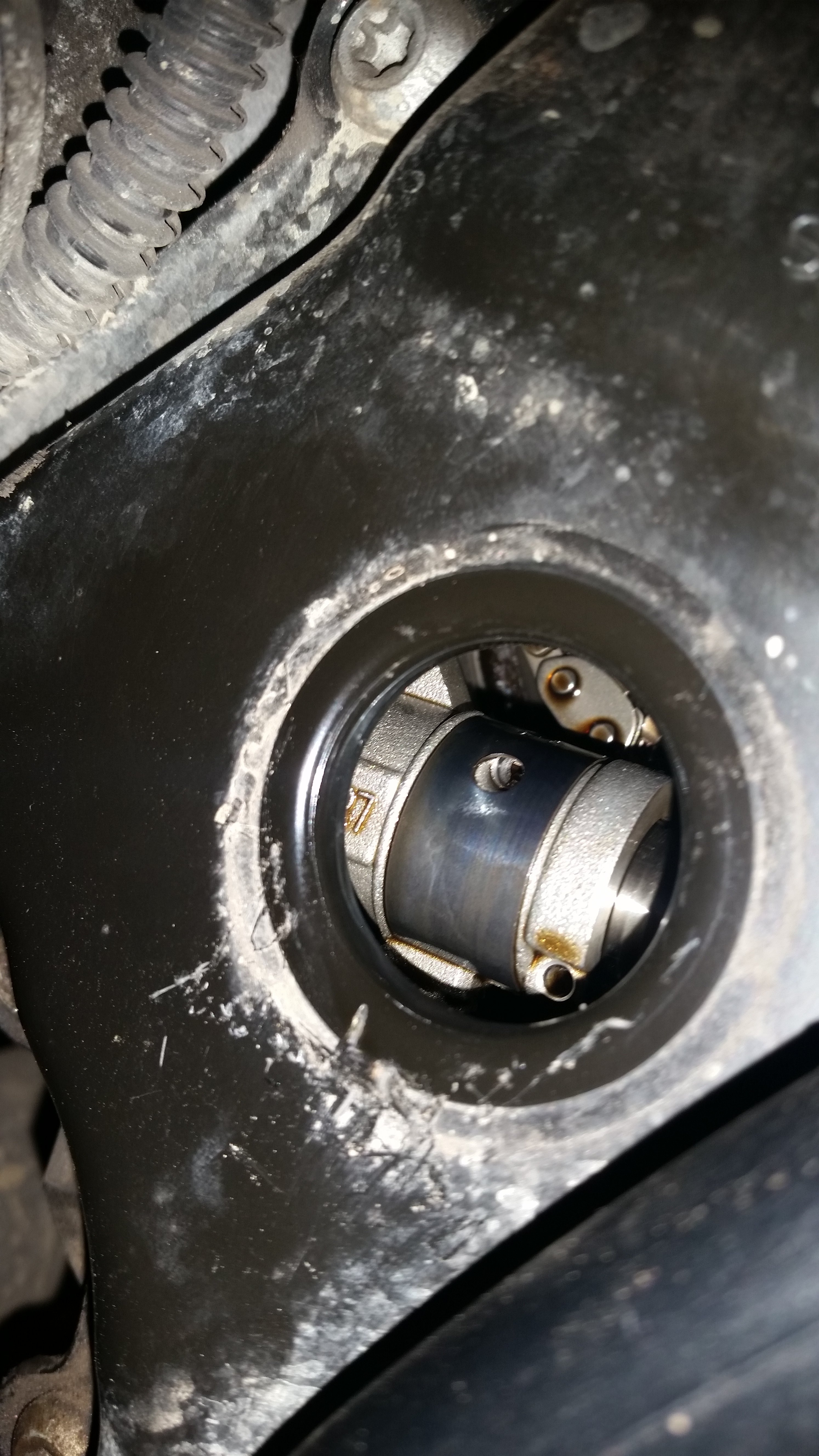

heres a pic or 2 of mine through the hole , it doent really look that extended and with 90k on the car should i take the plunge or just keep running it and see , i got the car cheap at 3k aswell beautiful vrs estate 200 horses aswell , just his daft issue when it should have been on a recall
Mine is a 2010 and it let go on the previous owner over the winter at just shy of 93k miles. At £3k for a TSI vRS, that's a bargain. Just wait until it kicks itself in the nuts then. :cool:

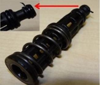

"it's the oil that runs back from the upside down filter" This must not happen. What to do to resolve the issue? Let him to check the o-rings on the pin under the oil filter
1.jpg.caceaf1184f4a13230f23fa4a5f33e23.jpg 2.jpg.0221f892ea282f58d04e1c09c1bcc06b.jpg
and then the famous reduction valve on bearings saddle
