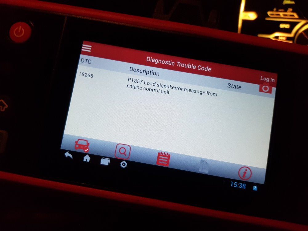

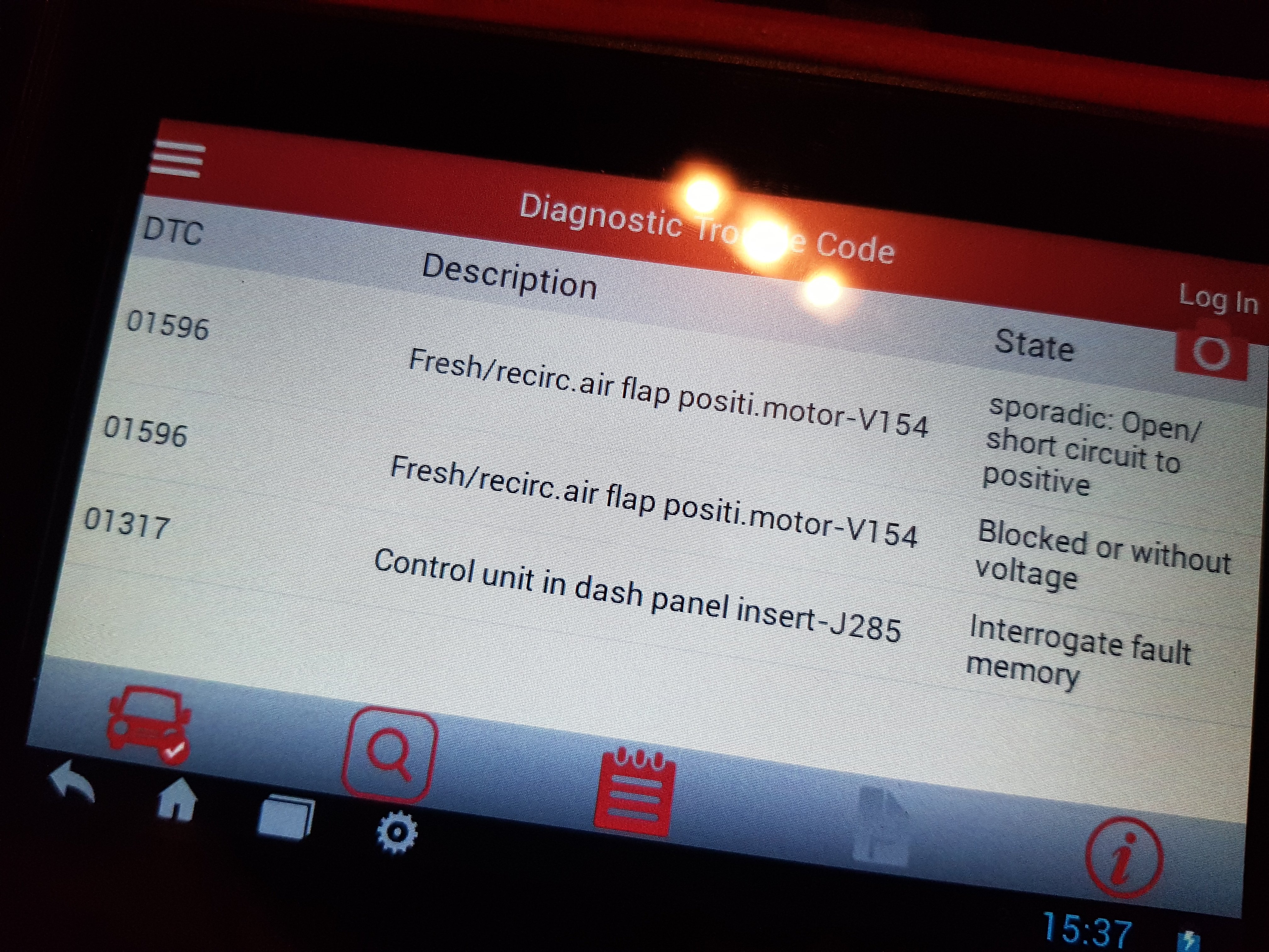

Can anyone help with these codes
What do i need to fix these codes all i know is mg windows dont go work and its really annoying. Any help would be appreciated thanks
Those aren't fault codes. Those are messages telling you that there are fault codes stored in the relevant modules.
How would i go about getting these fixed replace the modules and  if so what modules are they?
You need a full scan of those modules to see what the fault codes actually are. All you have there are notifications that there are fault codes. What diagnostic tool are you using?

Ok, do a search in the mk1 fabia subforum for load signal, and you'll find lots of info about the first one. Recirculation flap faults are also almost universally common (and probably Not worth fixing).
 Not sure what the last one is about but doubt it has anything to do with your windows.
