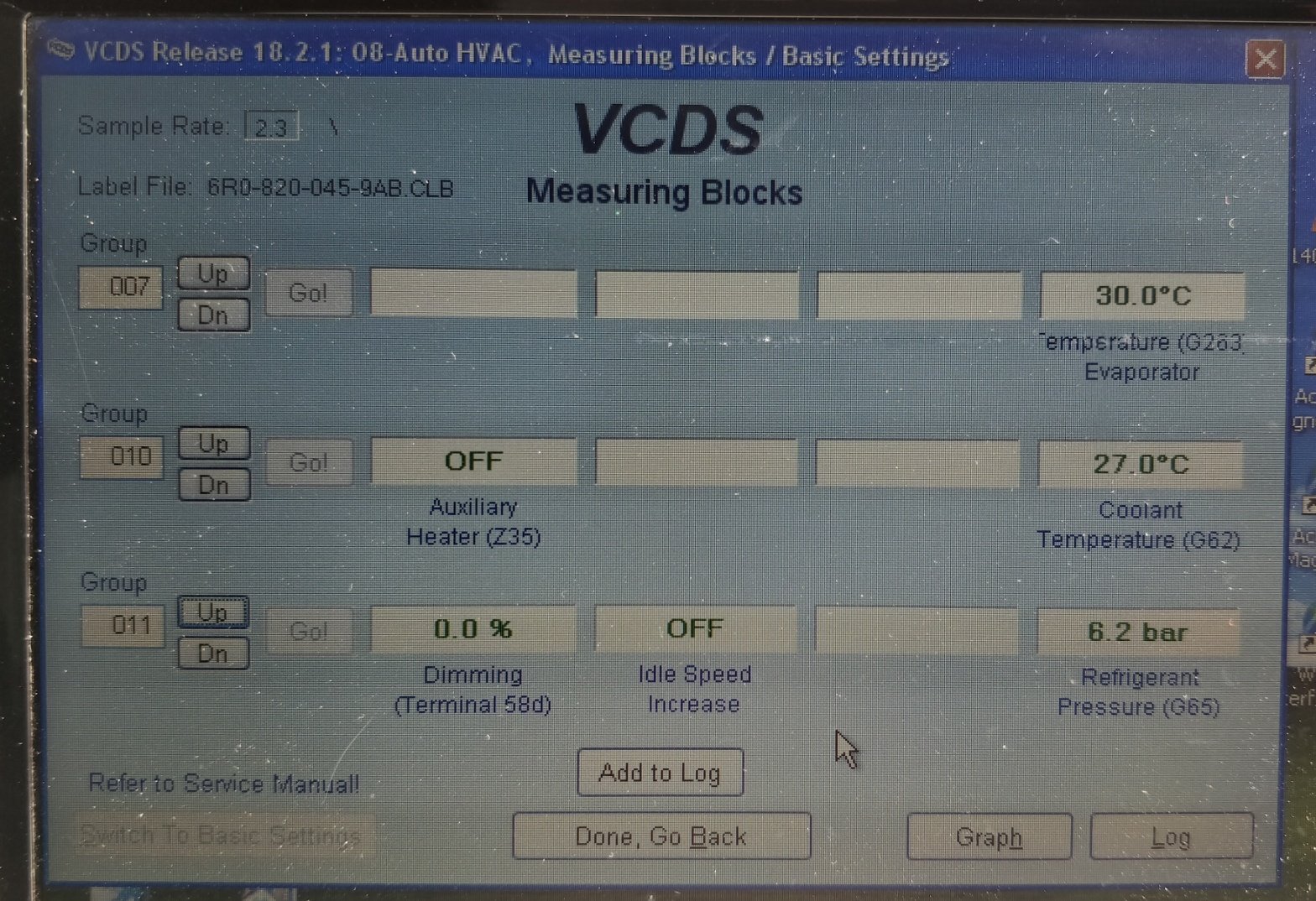

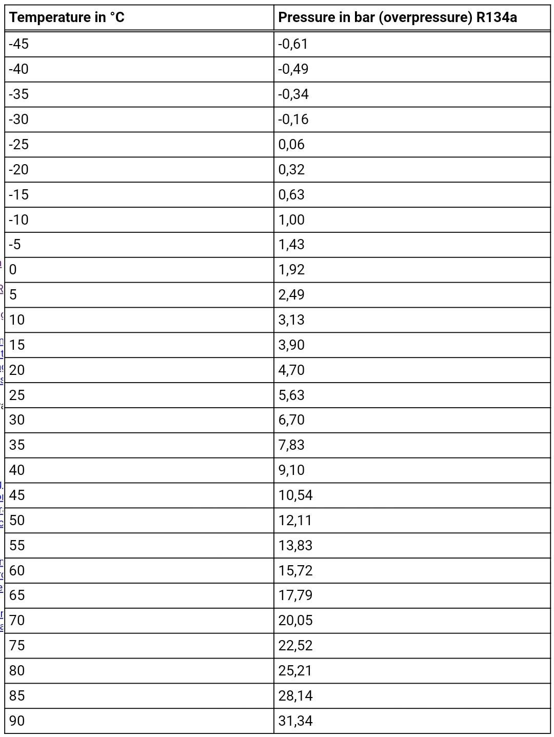

It does just screw on to a schrader valve. I replaced one unnecessarily. What does your sensor read in vcds measuring blocks. It should read as per outside temp in this table. This was mine and it was fine.
Hi, I have no access to VCDS so don't know... I found the fault code on the a/c panel on the dash, where you press recirc and econ buttons to get the codes listed...
