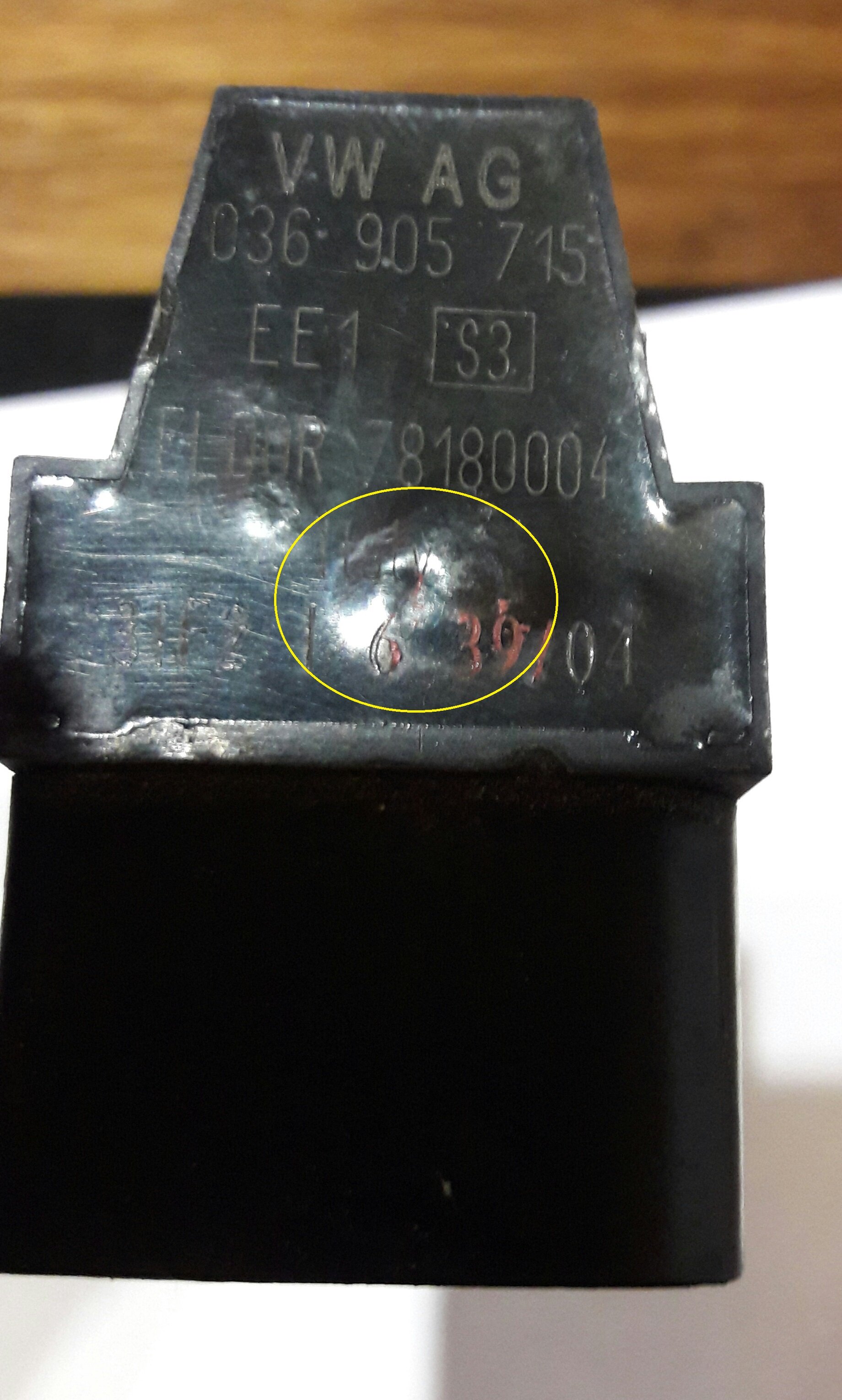

Sounds like a failed pencil coil to me. Which engine again?

Take the engine cover off, and have a look at the tops of the three coilpacks.
See if one of them has a raised, blister-like appearance like this:

Could've been worse!
Lol thanks Wink took engine cover of all 3 coil packs look ok. Did notice middle coil pack may have been replaced at some stage as the other 2 had Volkswagen part numbers on them middle one did not.
