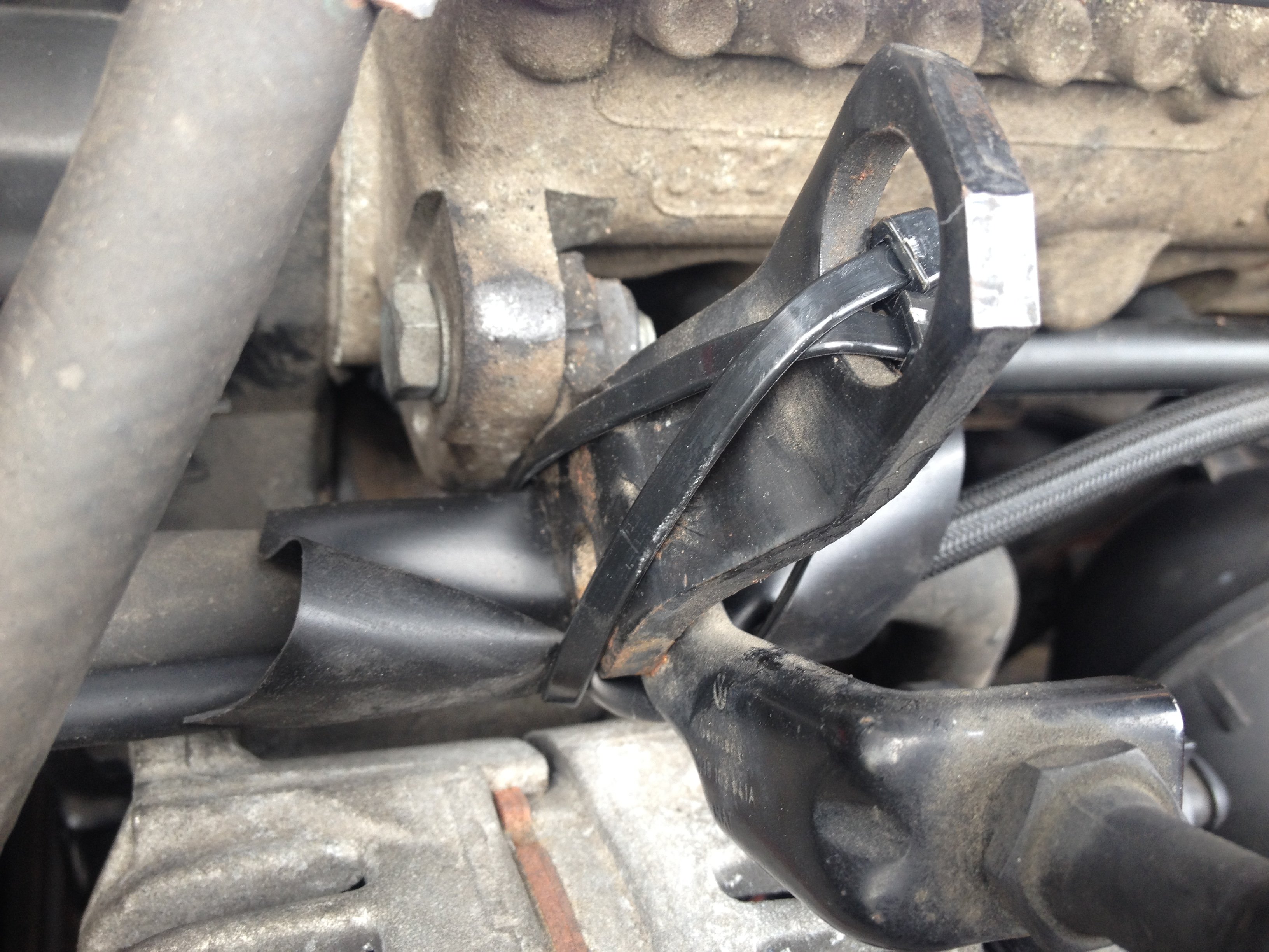

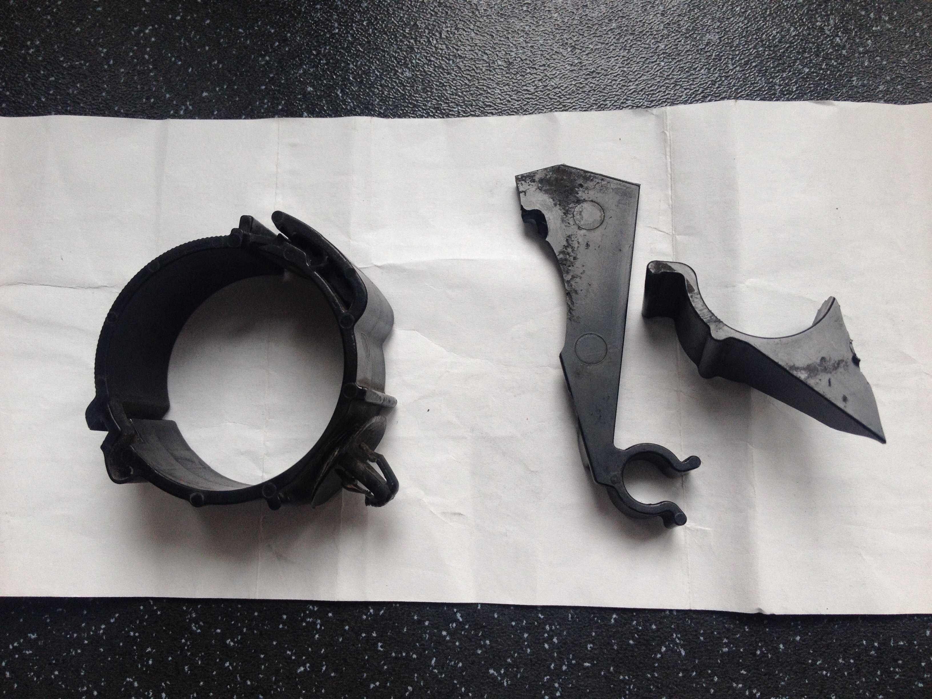

I did about 30mls.today and the car definitely warmed up MUCH quicker and no leaks so that seems to have cured that problem.I went to the nearest TPS to me and tried to buy a couple of hose support brackets.They could not find them on their system.I looked myself last night on an online parts site but to no avail.I have put a couple of pics on to see if anyone has any idea what the part numbers are.One is the bottom hose support just above the sump line and the other supports a coolant hose and the vacuum hose to the vac.tank and is located behind the alternator.Thank you in anticipation.(Somehow the second photo went to a new post)

Part numbers are usually somewhere on every component, if you look carefully.
Hello Wino,I have looked carefully on the nearly complete clip,nothing,also on the remains of the broken clip,zilch.I even tried a temporary repair but they are so brittle it just shattered.The parts bloke at TPS looked also and he couldn’t see anything and his eyes were at least 50yrs.younger than mine.We looked together on his screen and nowhere was there any pipe clips listed.Looks like I might have to make a couple up instead of the tie wraps that are on at the moment.I even thought about going to a breaker but I reckon the clips would be as brittle as mine.
