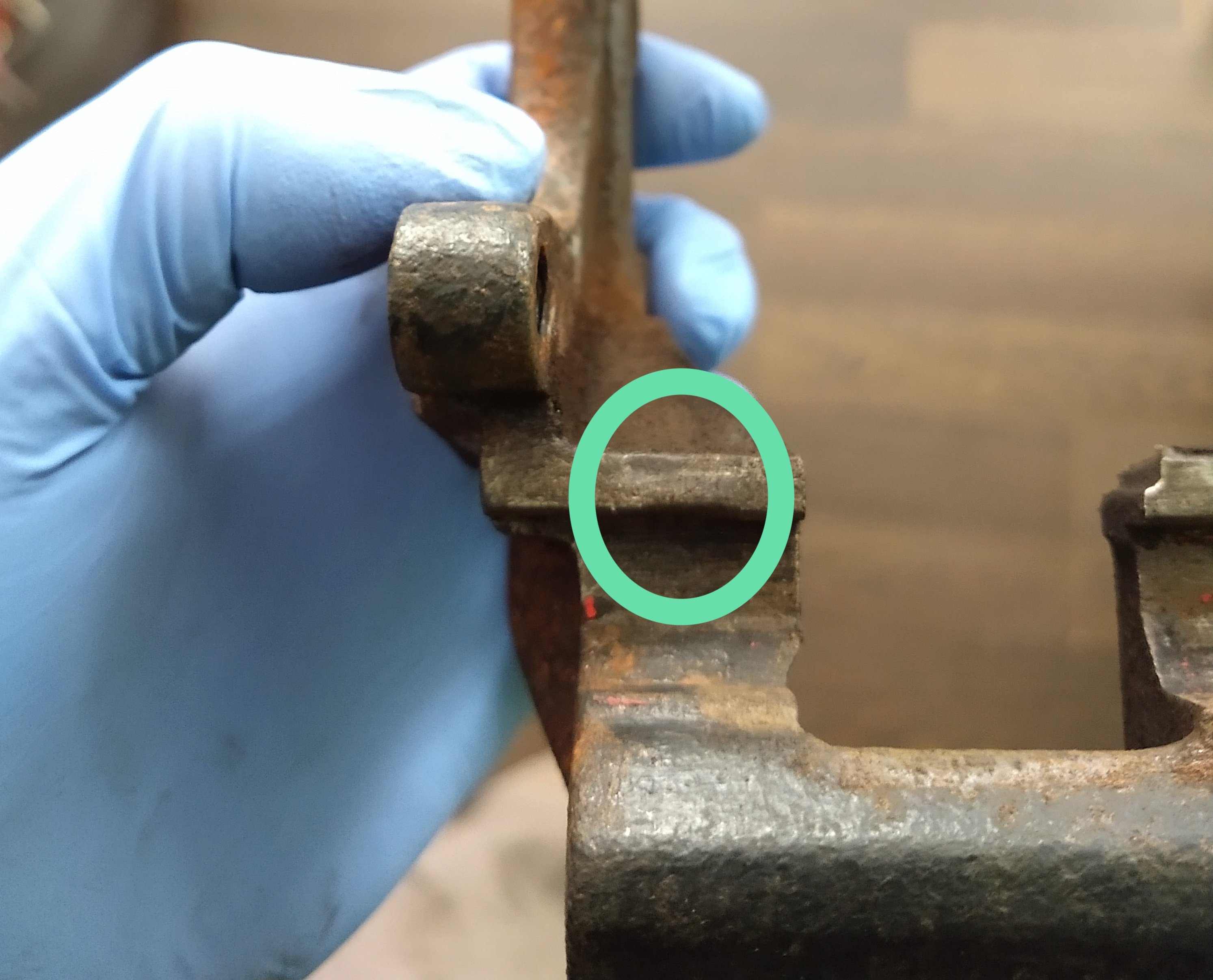

So my guesses of potential issues include:
Bent or otherwise wrecked carrier on drivers side (second hand one, not been changed) : some of the bits the pads slide on are a bit worn, maybe the pads are catching?  Been regreased and it might have helped a bit(See picture)

It's a pain but you could try stripping off both sides and swapping the carriers. Would indicate if the problem is with the carrier or the hub/bearing alignment/fitment.
as in swap carriers side to side. Never considered they are the same part. leaning towards it being that or a pipe blockage. Did seem to unjam when I released the drivers side bleed nipple so thinking it's more hydraulic related. Srill not taken it to a garage as it's not horrific and i'm not doing a lot of driving right now
