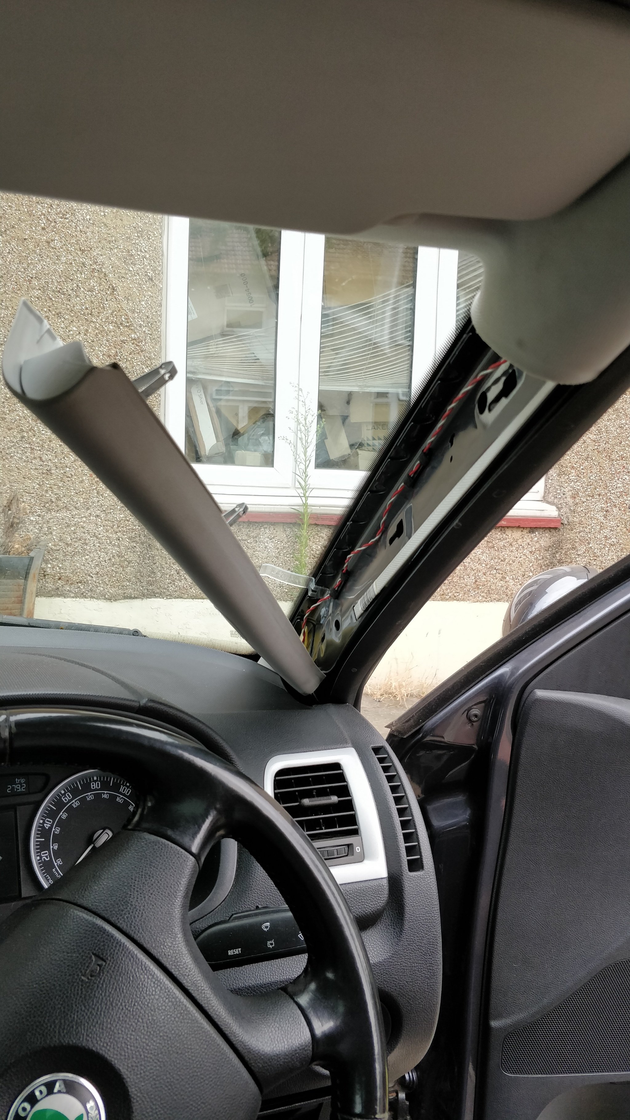

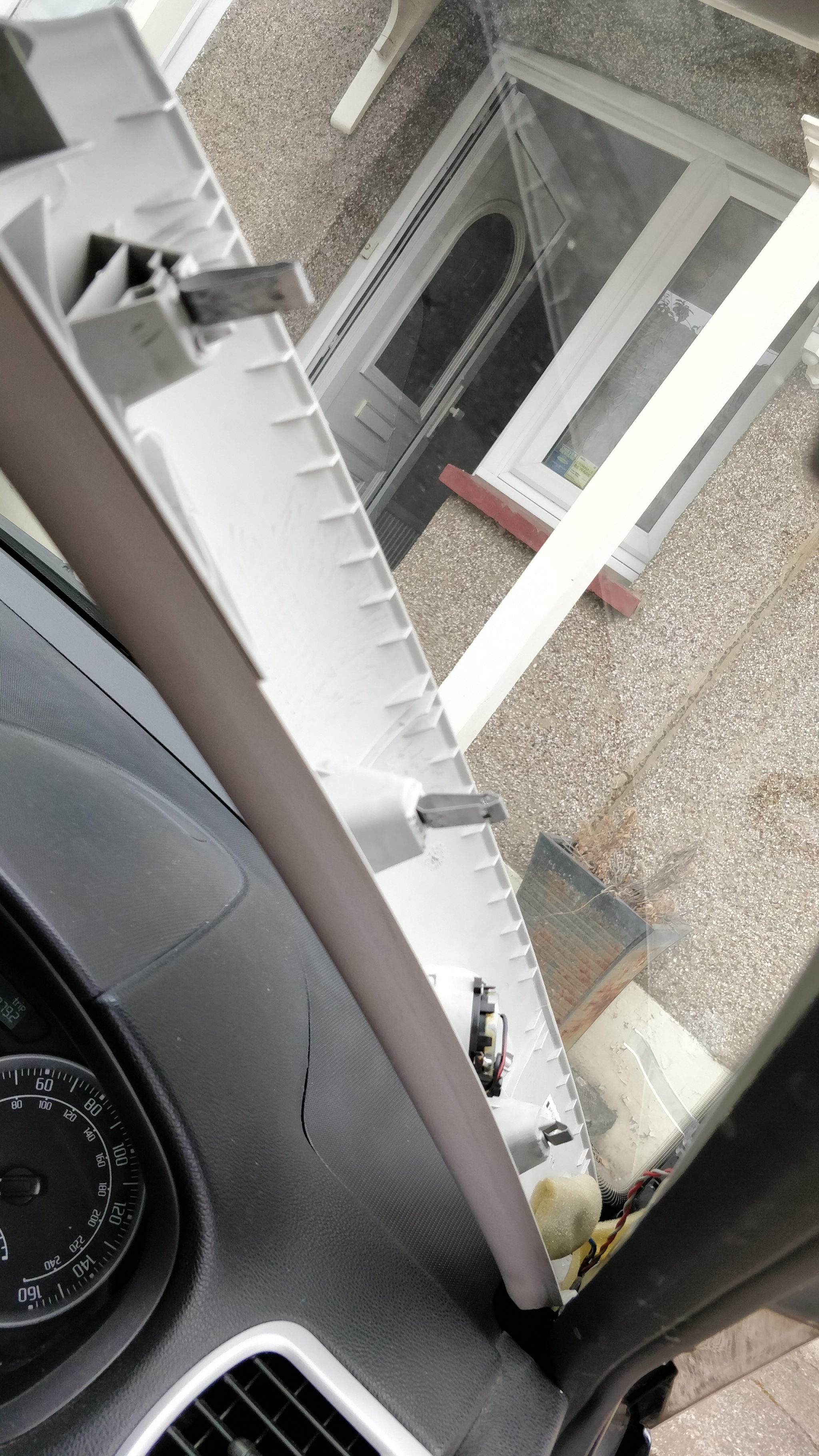

The A Pillar just pulls off. Pull it from the top to start with, you can get your fingers in at the top. Once the top pops off the middle clip I have always pushed out sideways before the bottom clip again pulls off.
Is your antenna at the front then ?
On replacement line the clips onto their holes before giving the plastic a side fist bang on.
I've had to change my antenna at the rear for dab. The rear involves popping off the C Pillars and the rear roof clips. The front I've read can be accessed via the interior light, but I've no experience on that as my antenna was at the rear.

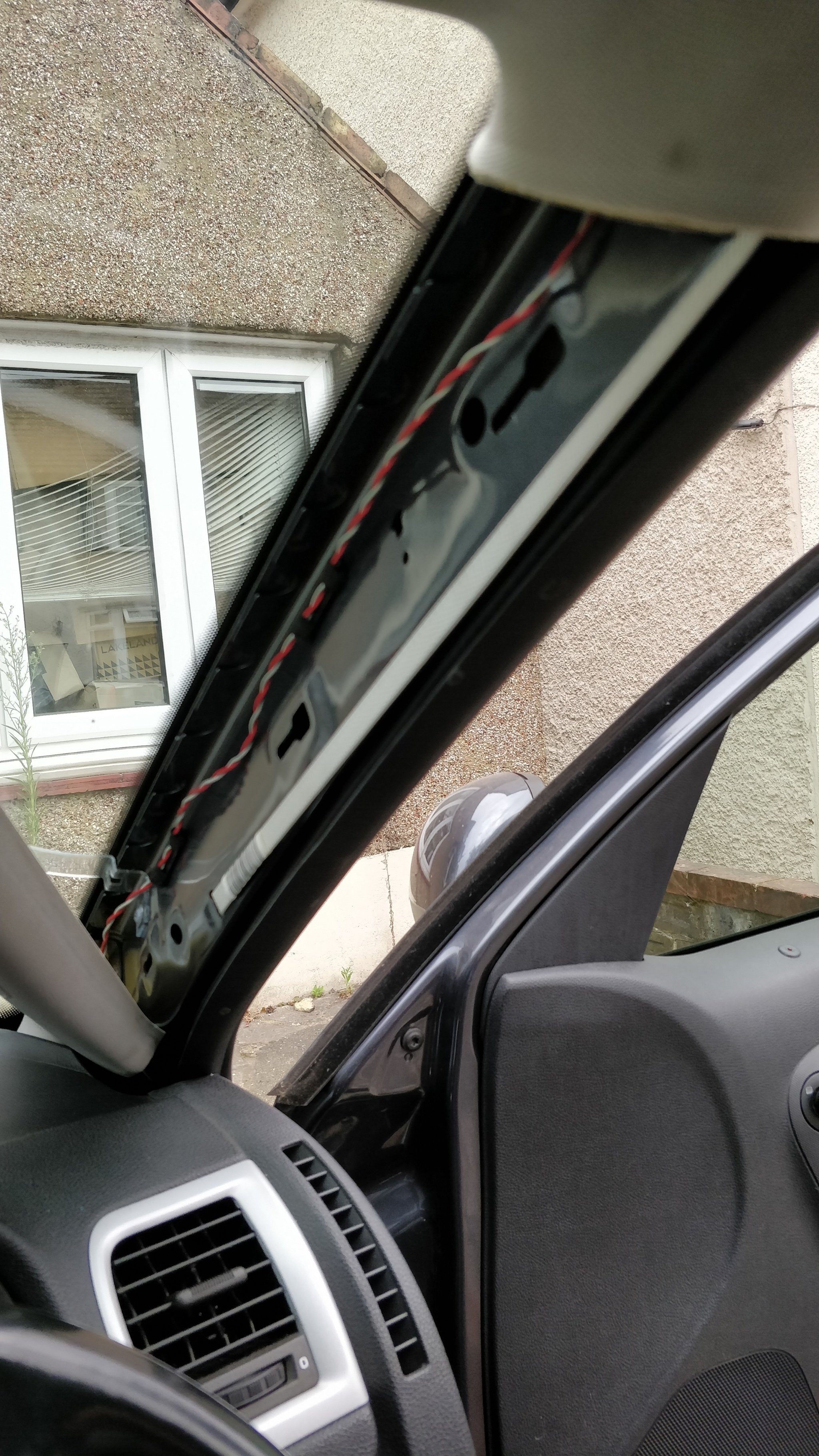

I plan to run the cables from the radio to the left behind the dash, up the A pillar, then to the rear under the headliner.

I didn't take the whole headliner off that's a bit overkill. I pulled off both rear C Pillars from the top. Undoing the centre seat belt roof mount seat. Popping off the rear roof fir-tree big pop on buttons that hold the roof lining up at the rear. Then from the rear you have just enough access to pull the roof lining down a bit and get a ratchet on the antenna nut. For the cable I pulled the top door seals away and fed the cable along, from antenna to rear door, rear door to front door, front door to A Pillar. I found I could manoeuvre the cable forward that way, I think removing the whole lining is too big and unnecessary. A stiff plastic rod is handy to poke forward, tie wire to and then pull through from further along.

No worries, a couple of other points. 1) my car's a Roomster not a Fabia and 2) I run the cables (power, am/fm and dab) down the passenger side. The antenna power I attached to my radios electric aerial power out wire, that went 12v when the radio was switched on.
