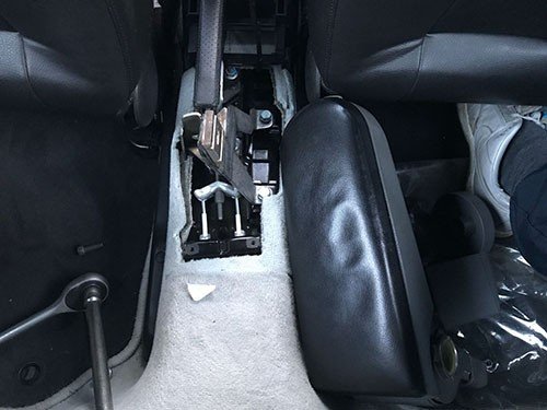

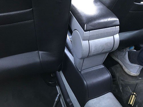

Update:
So the arm rest that I bought from the link above which was 2x the price of the one that the other person posted was EXACTLY the same even though it said its a straight fit for an Octavia and had to be modified. For anyone reading this in the future and wanting to do it here's a few pics:
PxpsfjD.jpg?1
YO0J8jI.png?1
For those wondering how the metal bracket has to be modified, ive forgotten to take the picture of mine but i found one on the internet and outlined the "ridge" that has to be cut. Its doable with a hacksaw if you know what you're doing.
