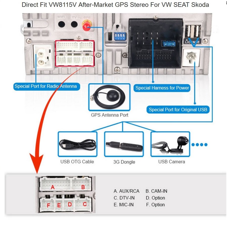

They don't include a picture of the back of the unit for that model, but this one is pretty much identical.
I'm hoping that most stuff just plugs in, and that I don't need to faff around finding the wires from the steering switches

I just removed the Bolero radio with the battery connected.
Then brought out the replacement and had a look. The replacement has the right connectors for Fakra and the main block, but the Fakra connector is oriented at an angle so that the aerial cables would stick out sideways. I think they'd catch on the side of the space the radio goes into and maybe get damaged if I tried to bend them sharply.
I put the Bolero back in after 5-10 or so minutes and it was fine; no need for a code thankfully and it still works.
Any thoughts?
It is plug and play and you are correct about the Fakra connector being 180 degrees out but you can rotate them on the connector block so they clear the back cradle, just turn both of them 180 degrees and it's done, connect the ISO plug and GPS and the wifi aerial and you are done, no need to disconnect the battery, all functions for wheel, Parking sensors, AC, doors etc will be displayed on screen.
Another tip is you can add a USB cable for phone charging or link up and there is enough space on the surround that you have popped off to run the cable down and into the lower cubby hole, just run it down the left side and pop the surround back on over it.

Fitted and working now. Radio is fine and tuned quickly. For all music I love the sound compared with the Bolero; I think the Bolero has a kind of bass boost turned on that I didn't like.
The steering wheel controls do work as advertised without extra wiring.

The SD card slot is under the lower right button, it's a cover not a button, keeps it looking clean, the left lower button is also a cover for the GPS card ;-)
