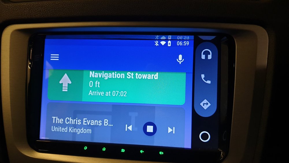

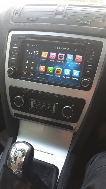

Final update - remained in use until I sold the car in November 2021. New owner did a factory reset, configured to his liking and is equally pleased (ignoring the Columbus I also gave him with the car).

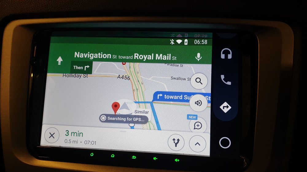

So the only niggles are minor lag on cold boot, probably 3 inexplicable shut downs mid journey, and Google navigation also exiting from time to time (easily solved by just starting again and selecting last journey). Fabulous value for money and sound quality.

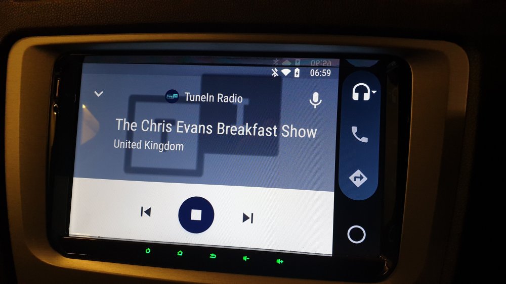

  • Quick update, after a few weeks use which has included my once weekly Birmingham to Bristol round trip.   Still very pleased with the unit overall. Sound quality amazes me, even my wife comm
  • Ta, I must have missed the phonebook option.   Door open indicators have now been swapped, 'Factory Settings' password was '126' after a spot of googling. Button illumination going off now s

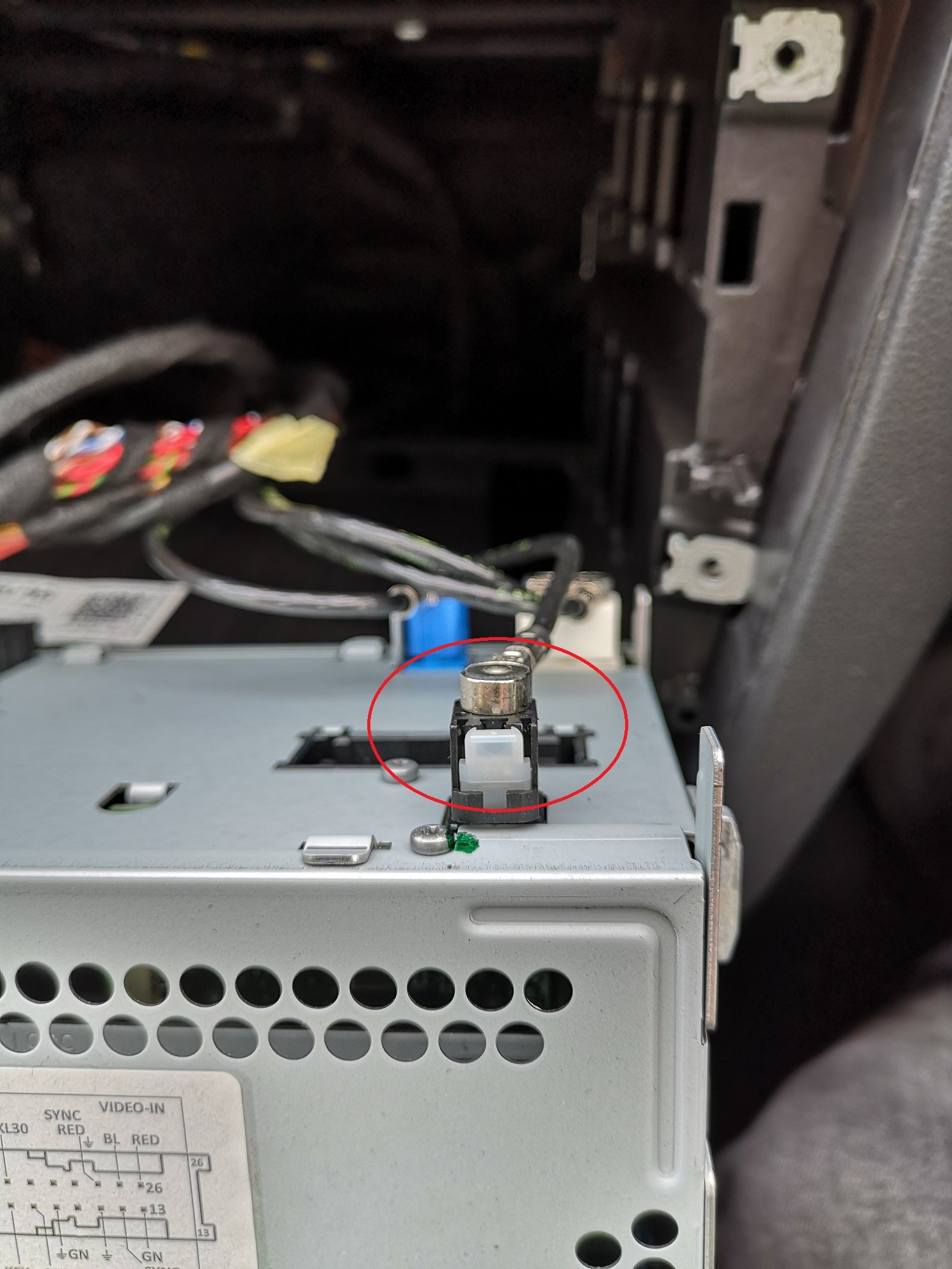

On 05/11/2018 at 11:01, Hermes_7 said:
Does anybody know what this connector does is it a USB or Aux or GPS...? There is a blue connector below which i think maybe the USB or GPS...? The car is Skoda Rapid 2013 Greentech elegance 1.2TSI (105PS)...
Help me OBI Wan kenobi you're my only hope!!
Many thanks.
Thoth the Atlantean.
That is your ANT or aerial for FM radio
