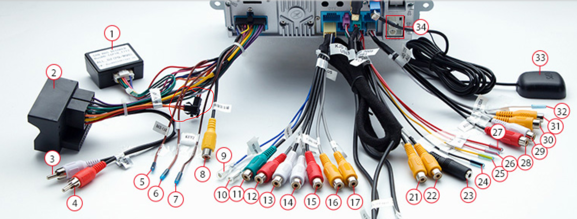

I have a question regrading the attached photos, where do the below wires (see attached photos) connect please?
5. Steering Wheel Control Cable Key1
6. Steering Wheel Control Cable Key2
And finally, do you disconnect the 'ACC' wire circled in red (last image)?
Many thanks
PB

@Pottybot if it's the same model as mine, it should be canbus compatible - so your steering wheel controls will just 'work' with the standard loom harness that is included with the stereo, you shouldn't need to do anything specific with those 2 steering wheel control cables (unless the Altea is different from my Octavia wiring wise - very much doubt it though).
For the 'Acc' wire, I can't remember the colour but it definitely had a label on it saying 'acc' and yes, just disconnect it - you don't need it, again because the Canbus supplies accessory power.

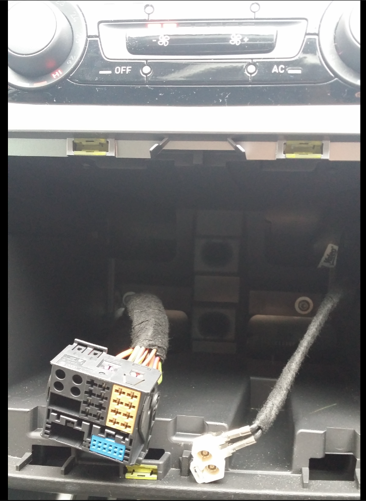

Does anybody know what this connector does is it a USB or Aux or GPS...? There is a blue connector below which i think maybe the USB or GPS...? The car is Skoda Rapid 2013 Greentech elegance 1.2TSI (105PS)...
Help me OBI Wan kenobi you're my only hope!!
Many thanks.
Thoth the Atlantean.
Many thanks.
This looks like it: so it is SAT Radio connector...blue is GPS....
@Hermes_7 - if you're in the US it might be Sat radio. If you're not, it's probably DAB.
Yep it is DAB mate thanks for your reply...
