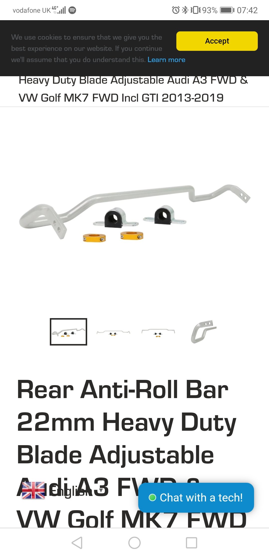

Anyone fitted the whiteline one? Only 22mm but adjustable.
Isn't 22mm a bit thin compared to others?
What's the stock diameter? (230 mk3. Petrol)
I've done Whiteline front and rear, remember it's solid whereas stock and some aftermarket are hollow. Makes a reasonable difference, no funny noises yet
Cool. Didn't know that.
I've got a rear whiteline to fit, did you upgrade the drop links or just use standard?
