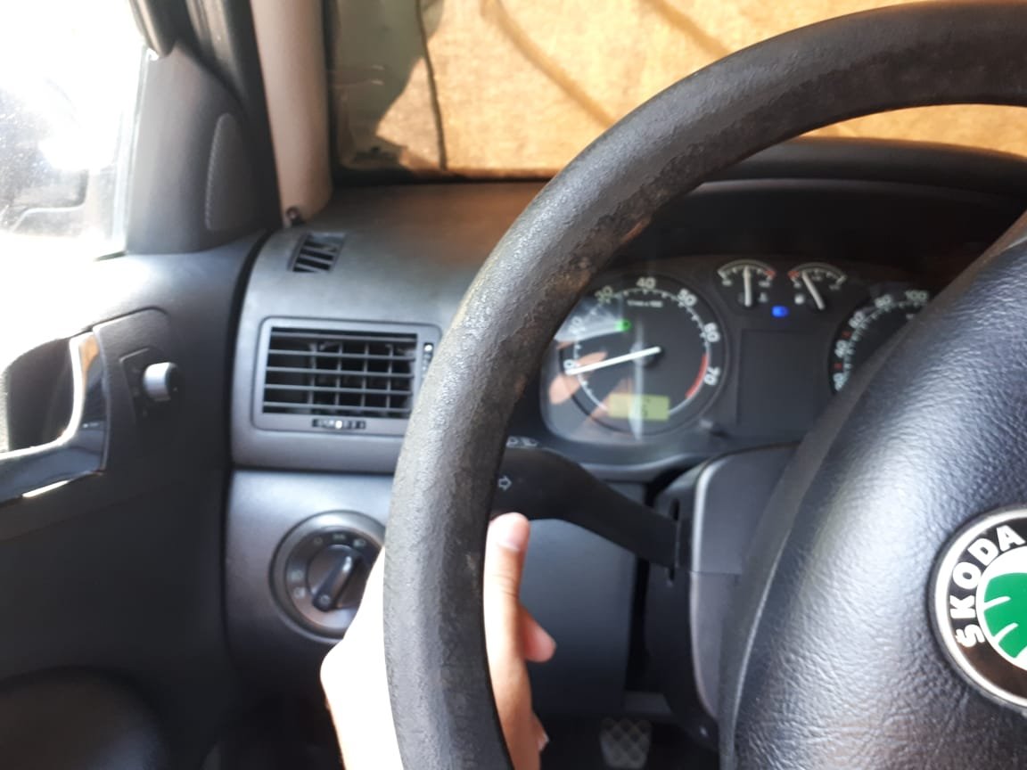

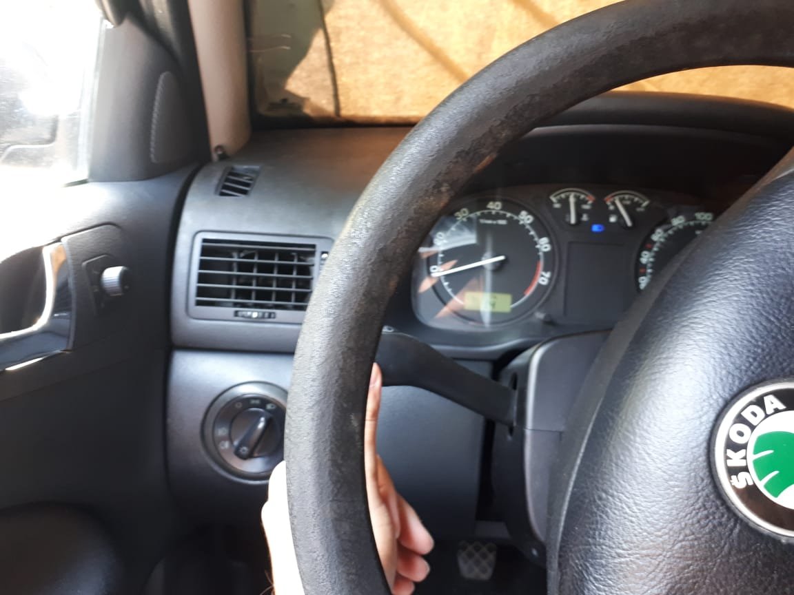

Hello and thanks for your reply ! I have the h4 bulb that has the low and high beams together . The problem is that when i select the low beam in the rotary selector the headlights are in the flash position (low and high beam turned on together) if i push the indicator switch the high beams stay on and the low beams turn off but if i leave it in normal (low beam ) position both beams stay on ! IF i pull the indicator switch  again both beams stay on . They even iliuminate both beams in the dashboard ! I will post some pictures later .

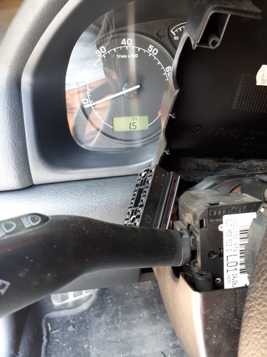

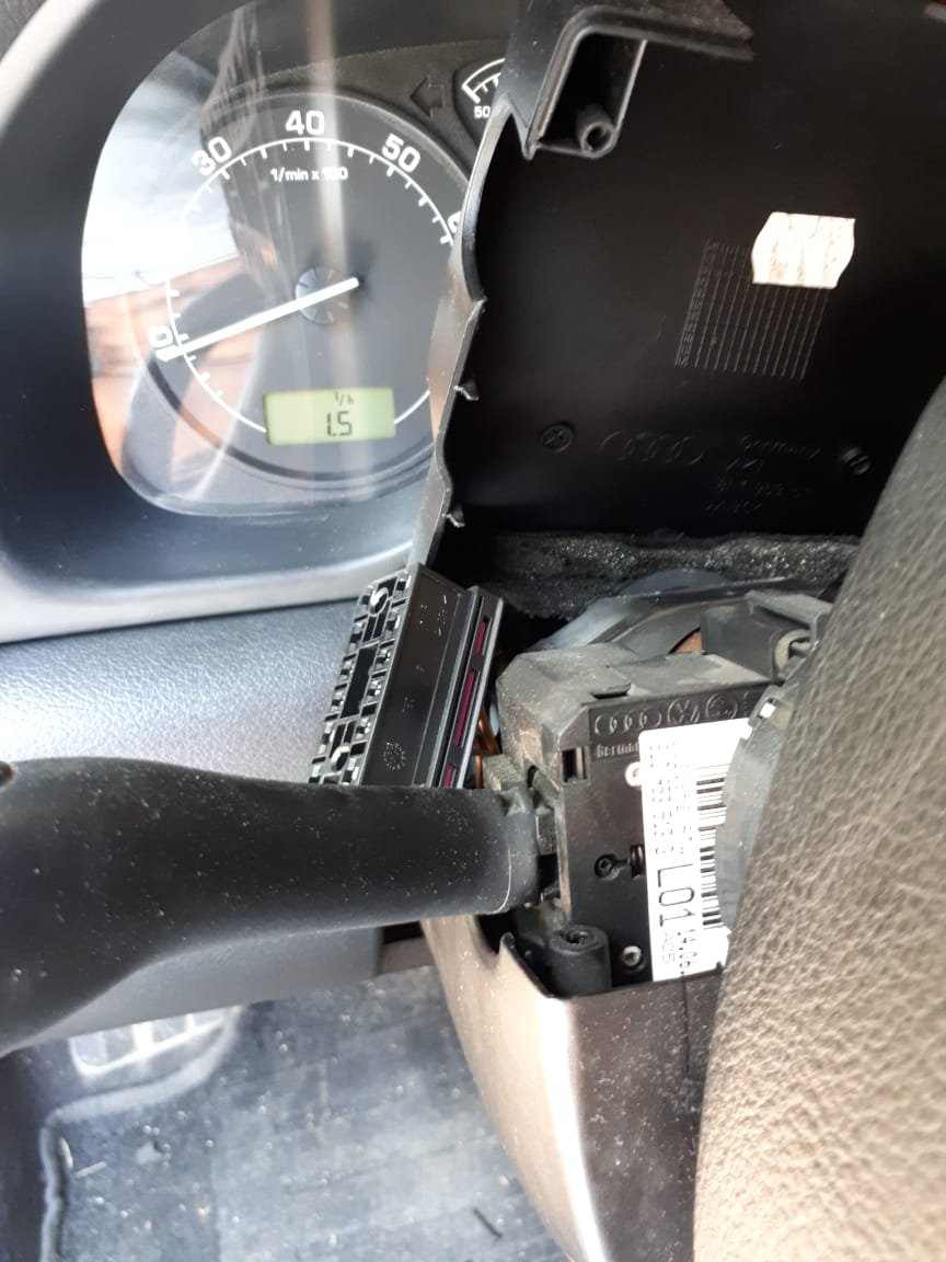

@mac11irl I checked the car i removed the top panel of the steering wheel and sprayed the indicator switch with wd-40 i used the switch a lot to see if it got unstuck with no luck i let it rest i chevked again no luck !

@Angelito This sounds like you have a problem with the dip switch mechanical functionality, which is causing the default position to give you both dip and flash at once. I have a horrible feeling that the only remedy is a new switch unit, which will have to be ordered from the factory.

There's no access to the front of the switch stalks until the wheel (and airbag) come off. The usual functioning of a headlight relay on an H4 equipped car is that it makes the main circuit and breaks the dip (or vice versa) as you push or pull the stalk. The flash function is (well should be) made using the main beam by pulling the stalk against a spring, which is why you can make both filaments in each bulb light together by having the dip on, and then using the flash function.
