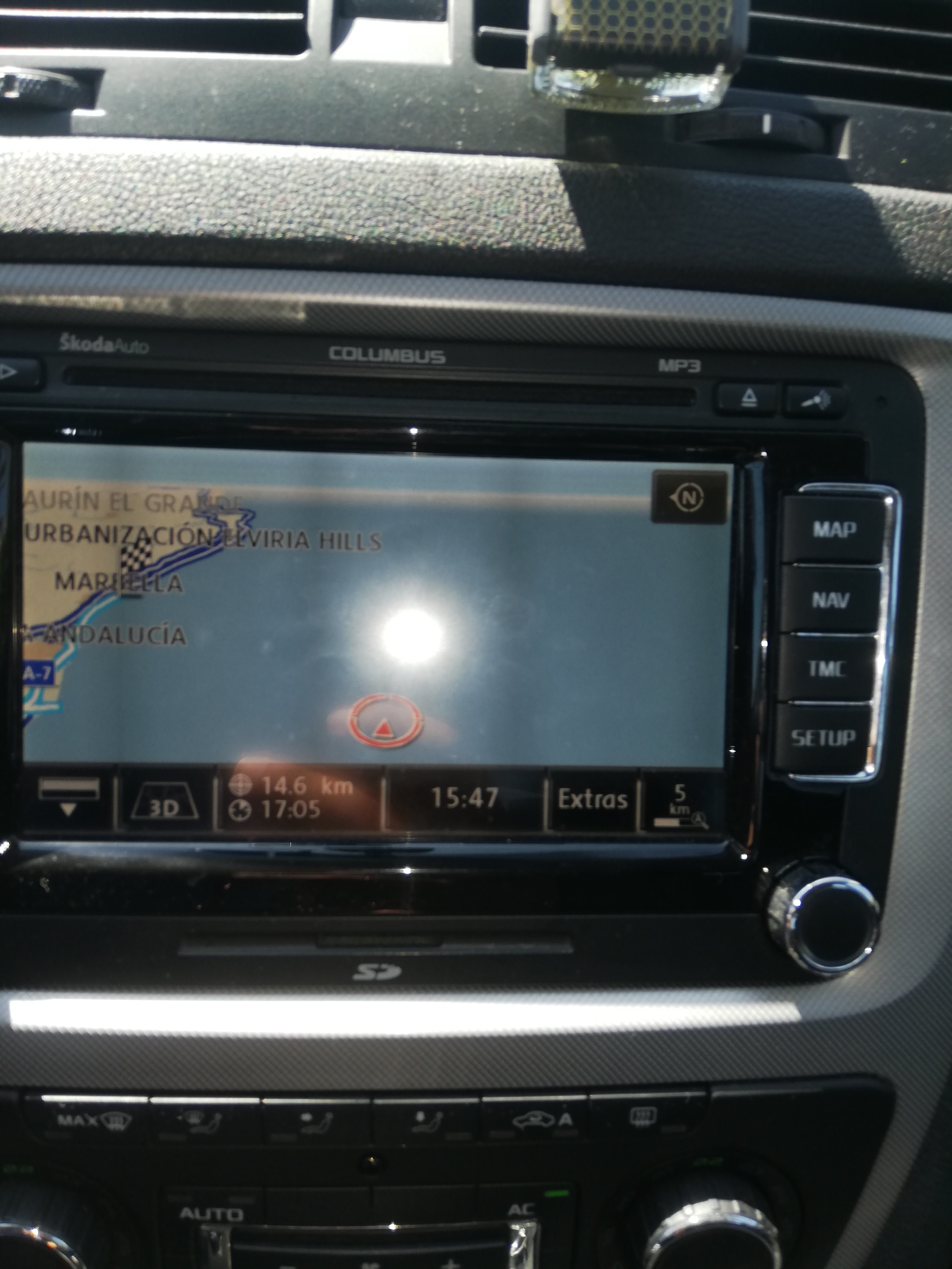

My columbus 510 has got something wrong. I cant plan any destination every time is mention the start position is off road on the see. Any body has a tips to fixe this issue. I have try to make factory reset but it s not fixe the issue.

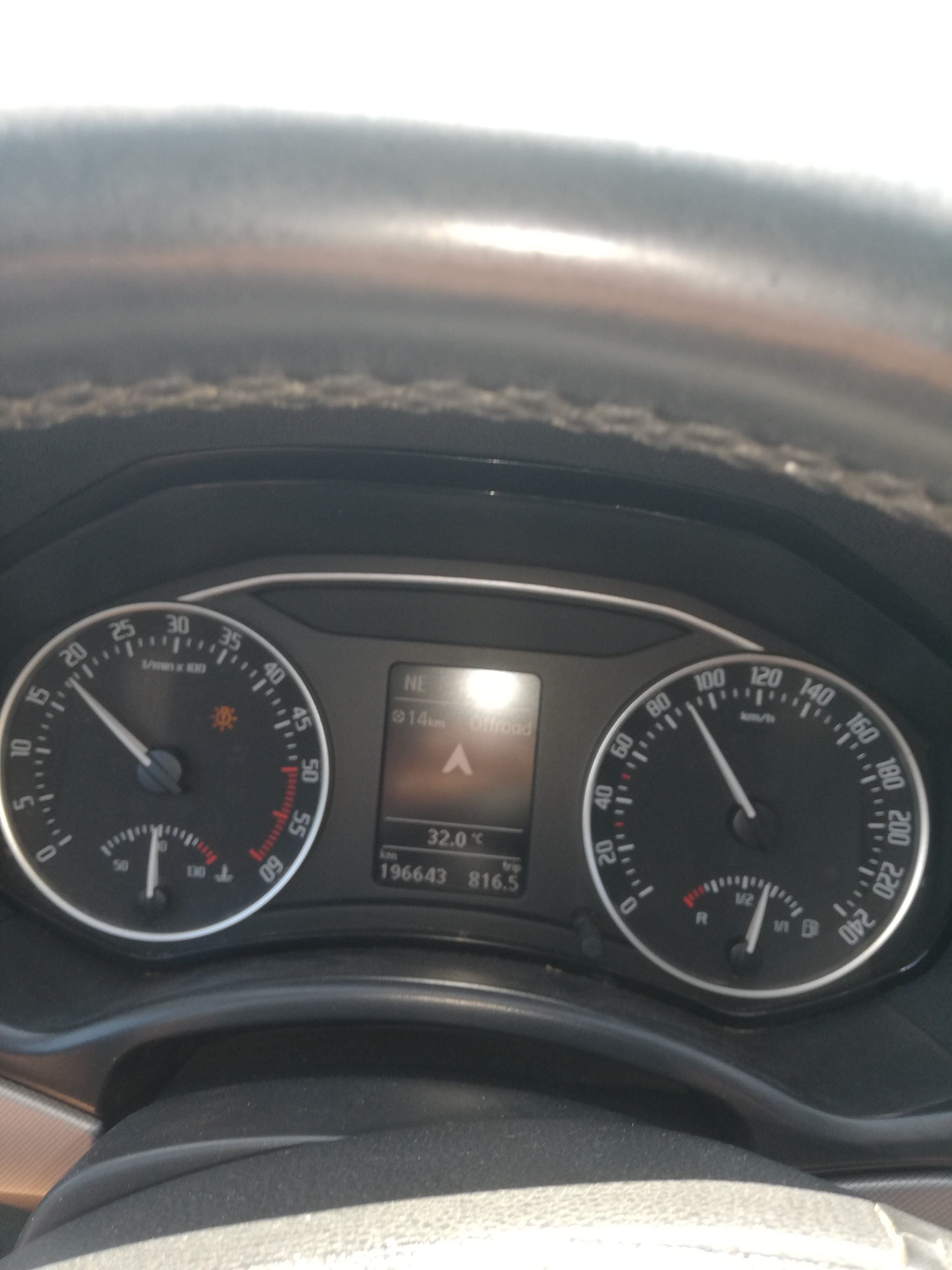

See attached some screen shot.

Your GPS antenna will have a fault. Either replace the rear antenna base unit, or fit a cheap ebay antenna under the dash somewhere.
Can i do reset antenna only and check. Why i got the position on my maxidot correct ?, Thanks
You need a new GPS antenna, your sat nav doesn't know where it is. It's still telling the Maxidot where it thinks it is ("Offroad") but clearly you're not parked in the Alboran Sea.
Get a £5 Ebay job - 2 years in with mine, mounted above the Columbus, takes 10 mins.
I followed the same advice but mounted the new antenna in the a pillar as it did not like it on top of the Columbus unit.
