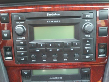

Hi guys i am just wondering is there a way of removing the radio without the removal tools as i have none,Thanks guys
They are only a couple of quid from ebay.
you take a used credit card (or similar plastic)
you cut it to slices that fit the holes
insert slices
pull the radio
