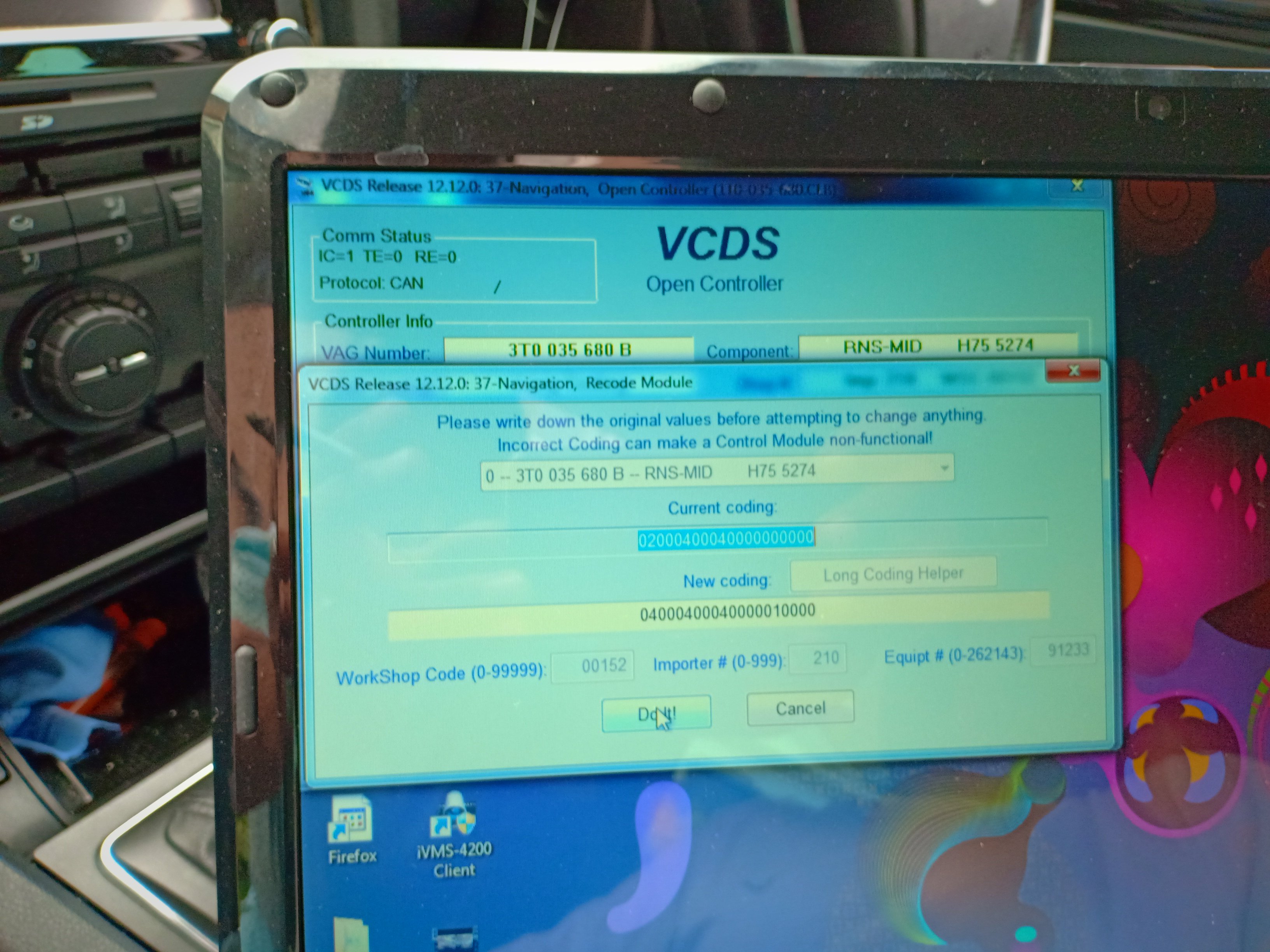

Yes I try to do coding but still not working any ideas where I can go in program and do coding thx
Got a VCDS autoscan?
Yes I do use vcds autoscan and it shows all good but still steering cantrol not working rest all works fine
Are you going to post your autoscan?
It'll show us how the car is setup and might give some ideas about what's causing your issues...
Ok I try to post
