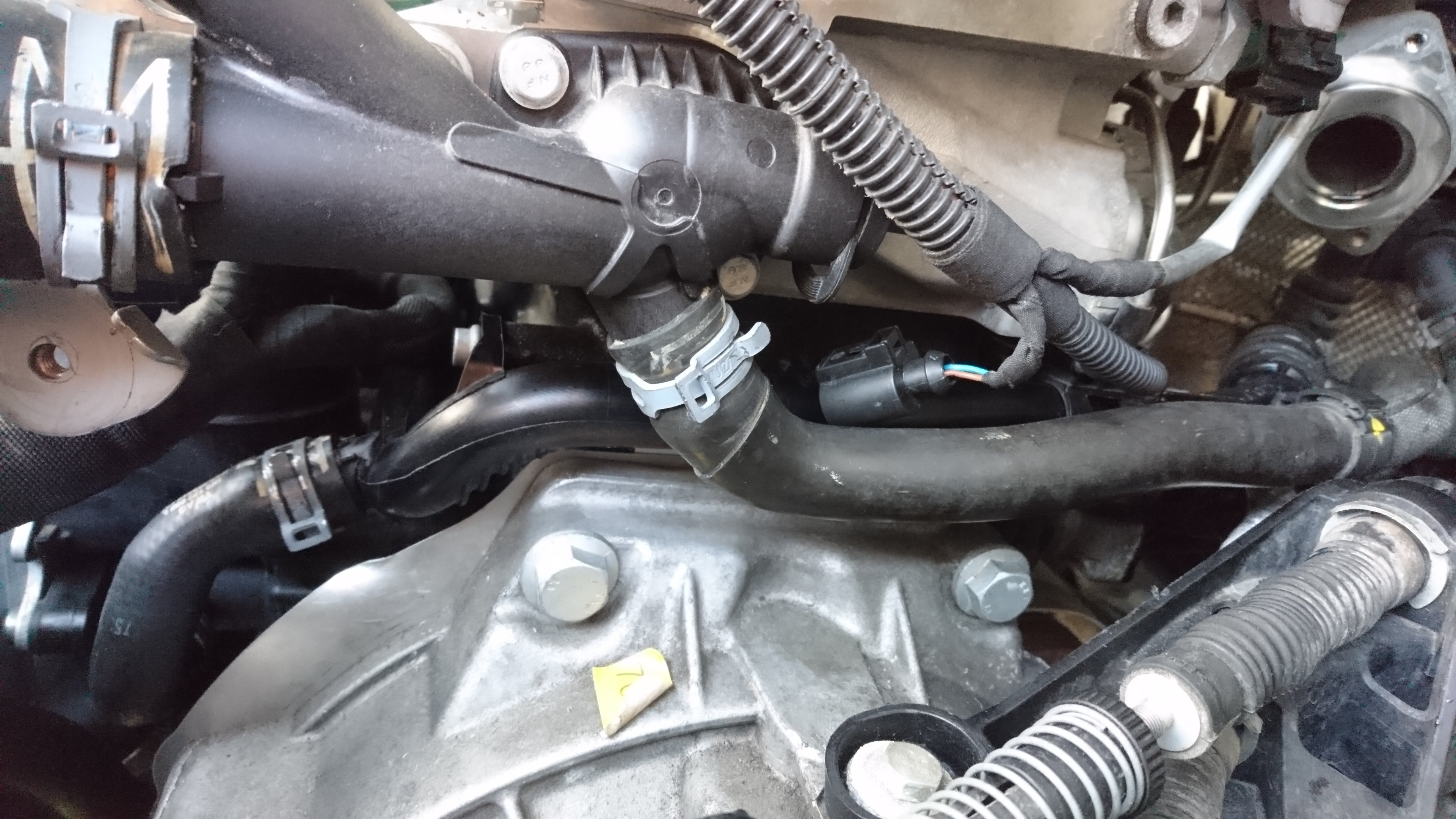

Jacked up, belly plate off, air box off, charge air hoses off and a small dribble of coolant coming from the upper back of the engine/gearbox joint, dripping off a mount/bracket lower down onto the O/S drive shaft at the gearbox. Have checked the rubber coolant hoses above the gearbox, but am having trouble with access and seeing the leak from the top.
Any ideas?? Is there any known issues with the plastic coolant hose above the gearbox??

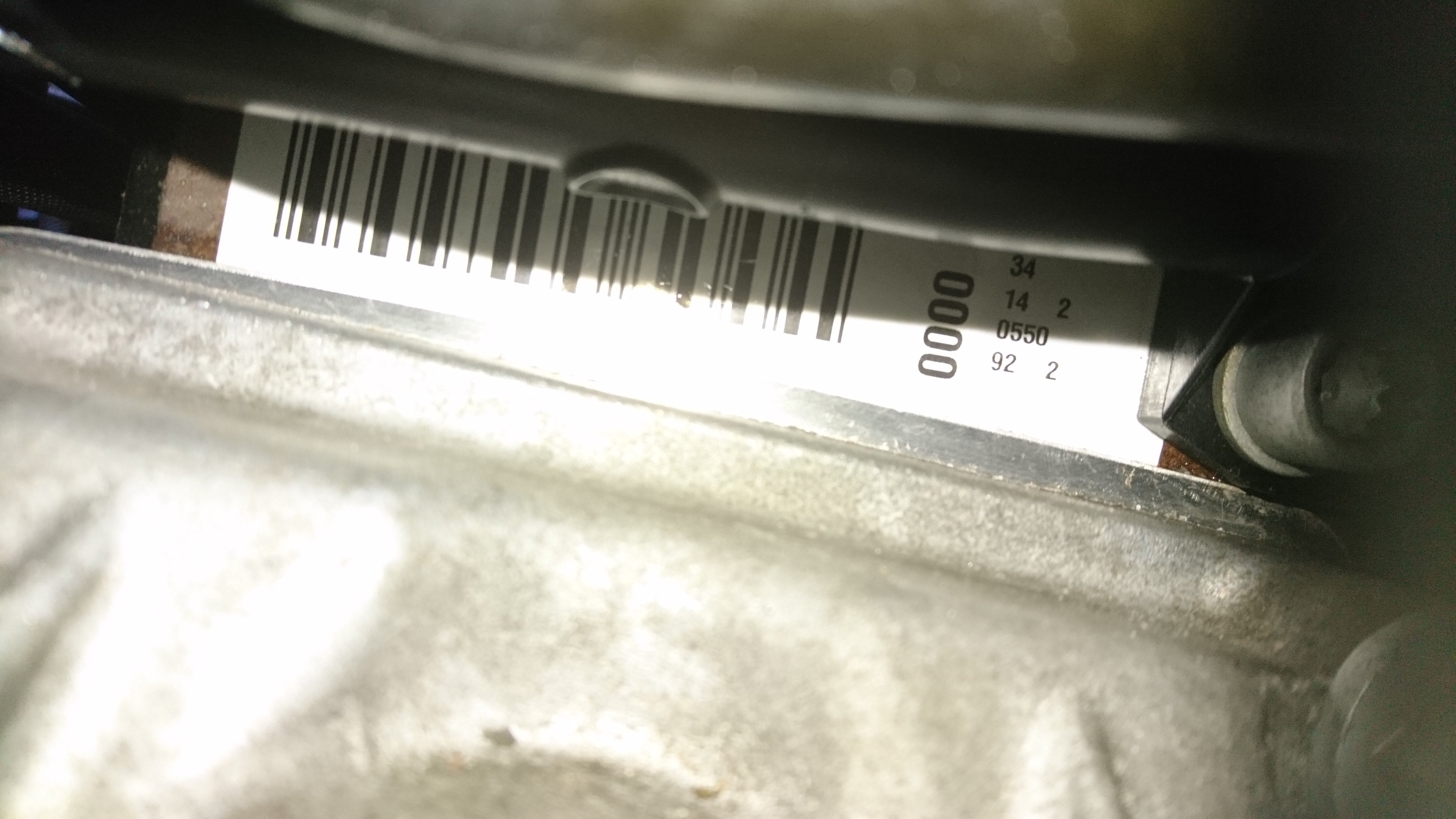

Changed the plastic coolant hose above gear box and still got a leak. Found coolant bubbling up from the engine barcode sticker above gearbox where the block has been machined for the sticker?? Anyone else seen this?
