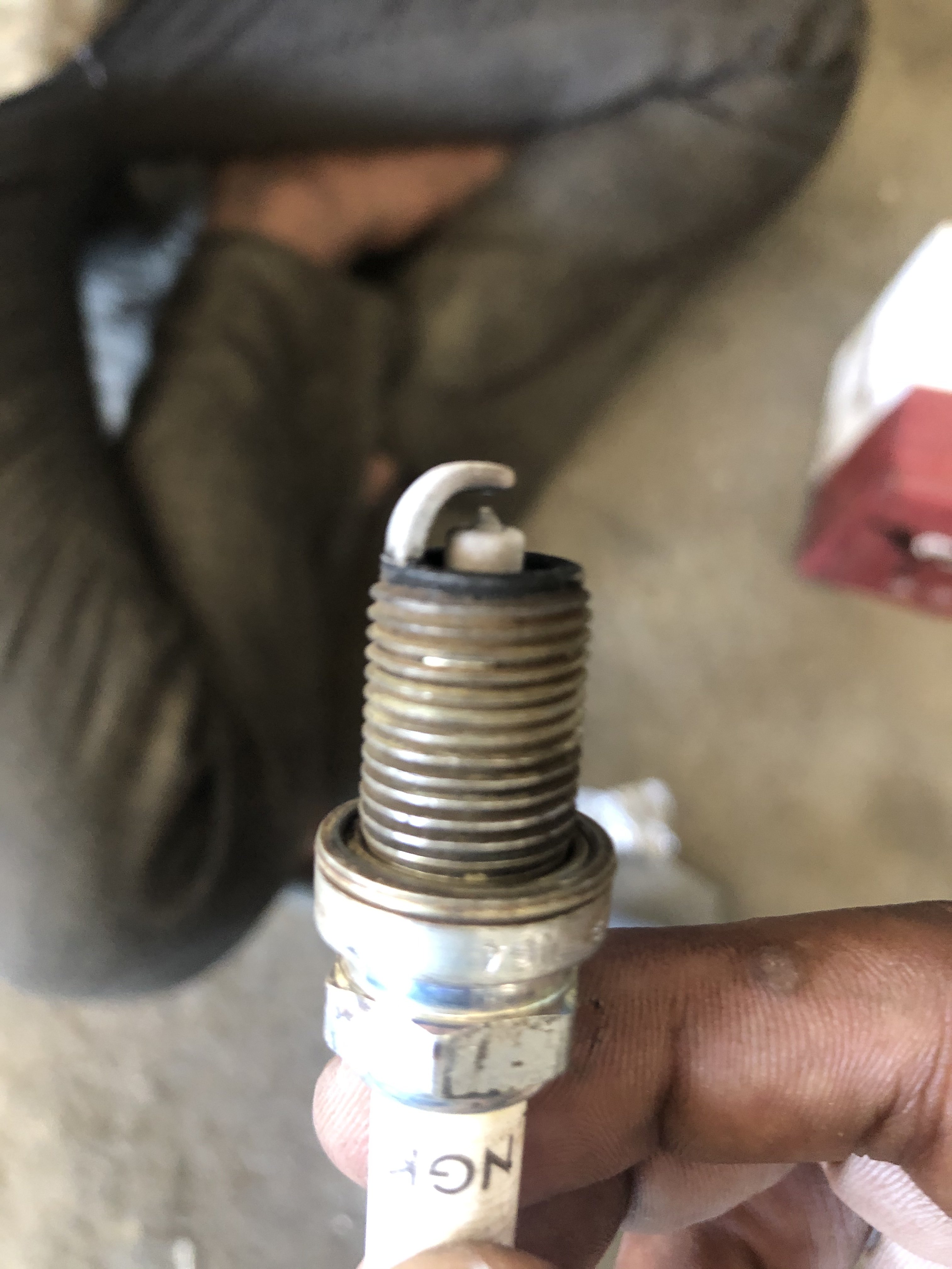

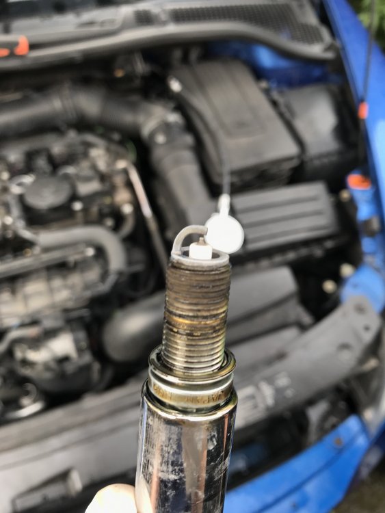

spark plugs look a little white too me? Would anyone care to chip in?

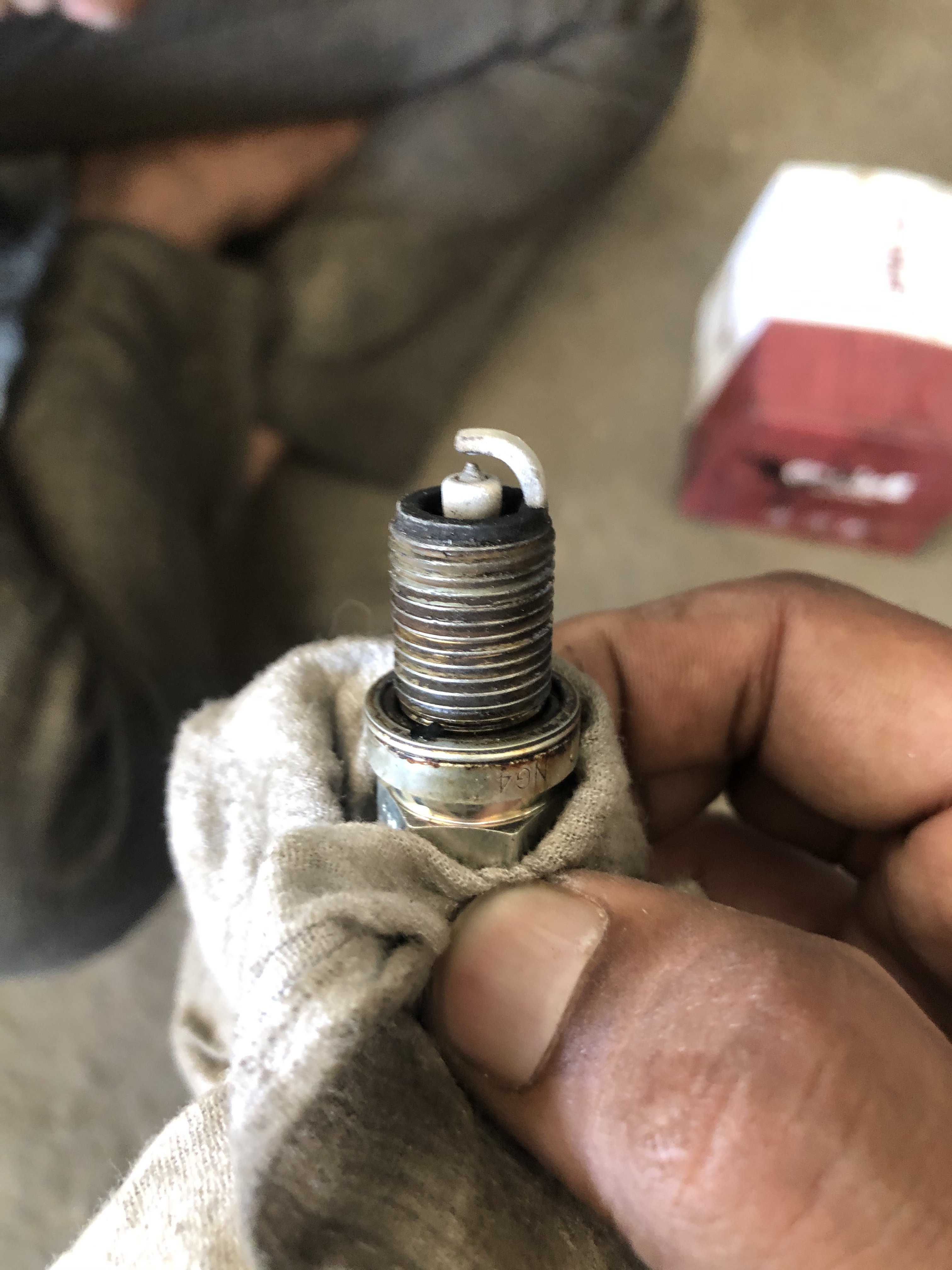

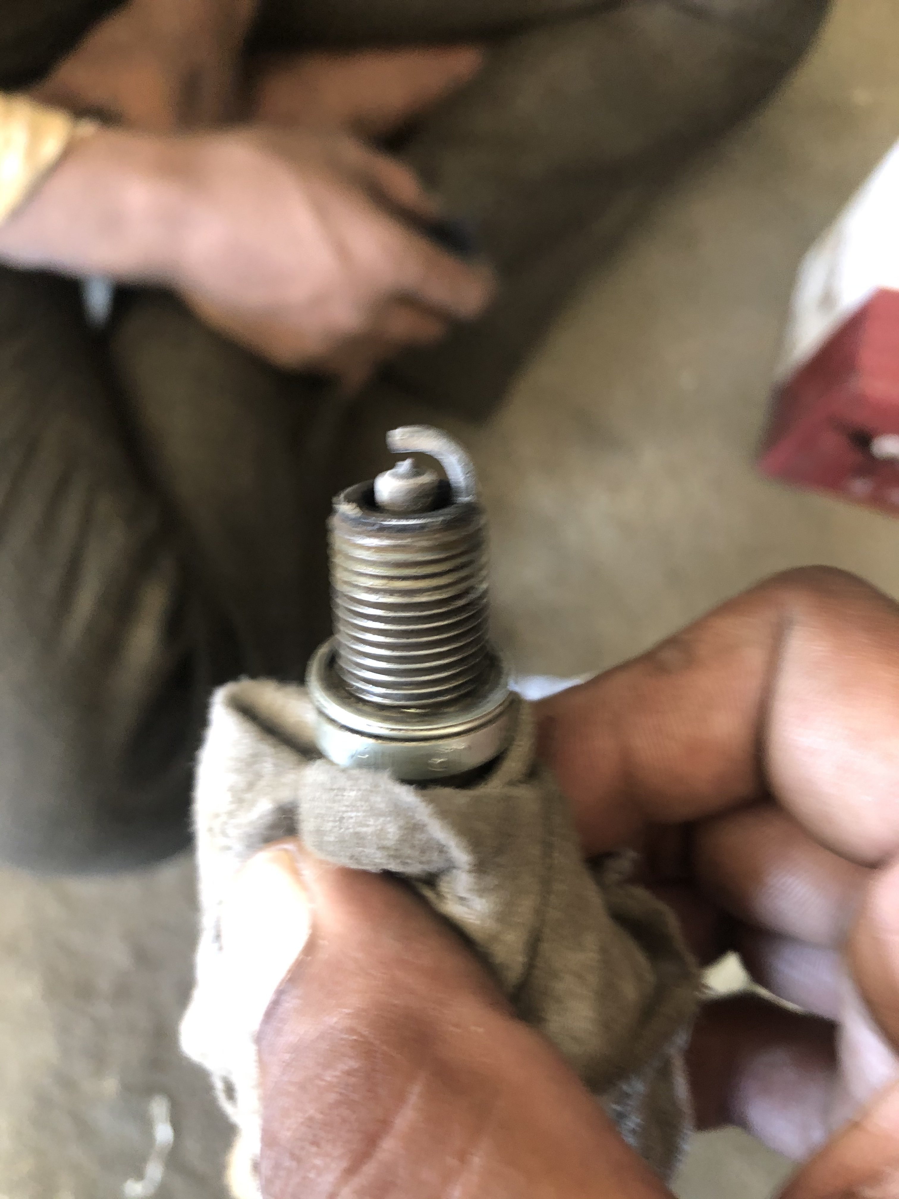

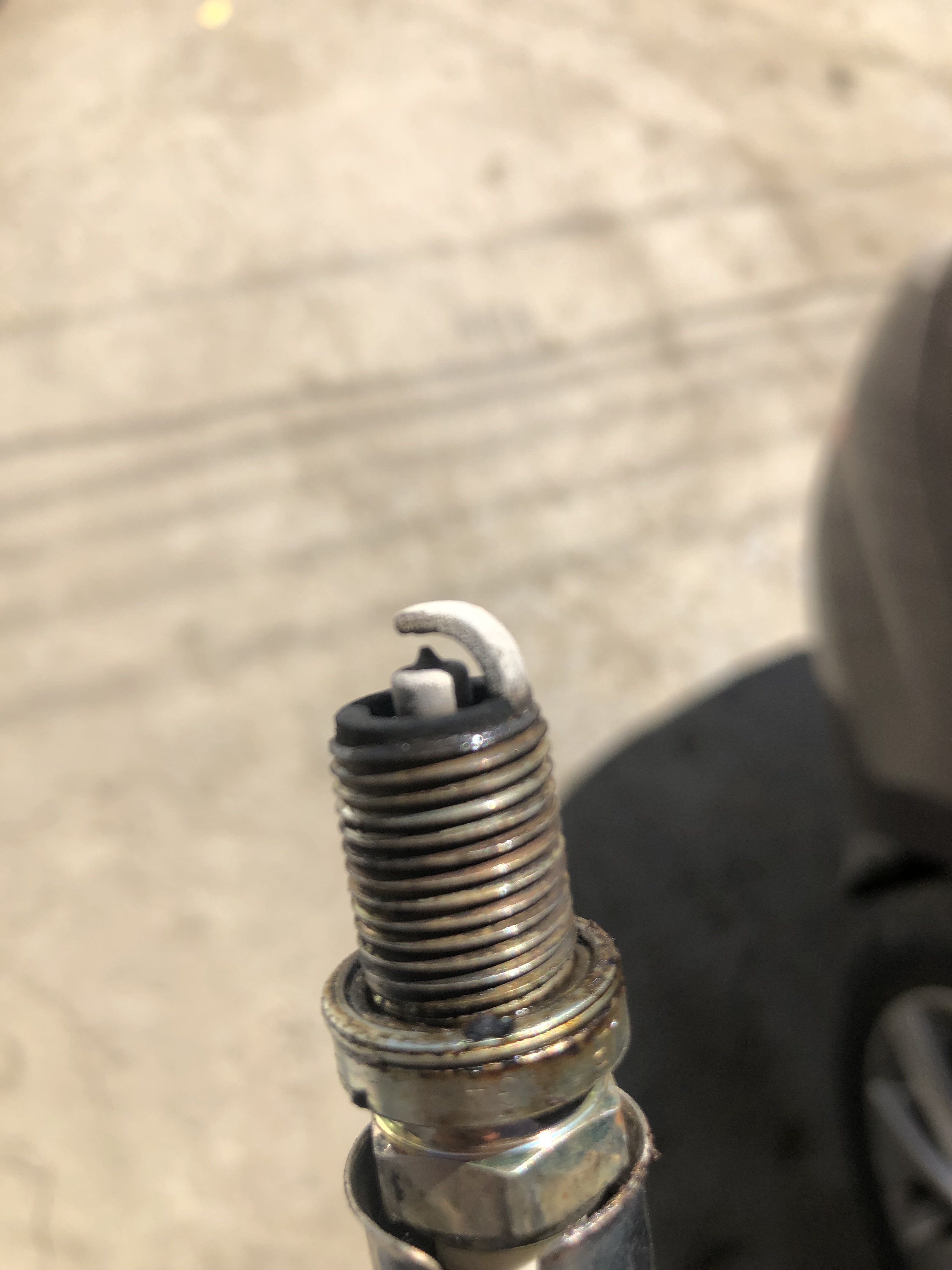

Hey adam, did you solve the problem ? My car is also doing the same and sparkplugs came out white. What was your fix ?
