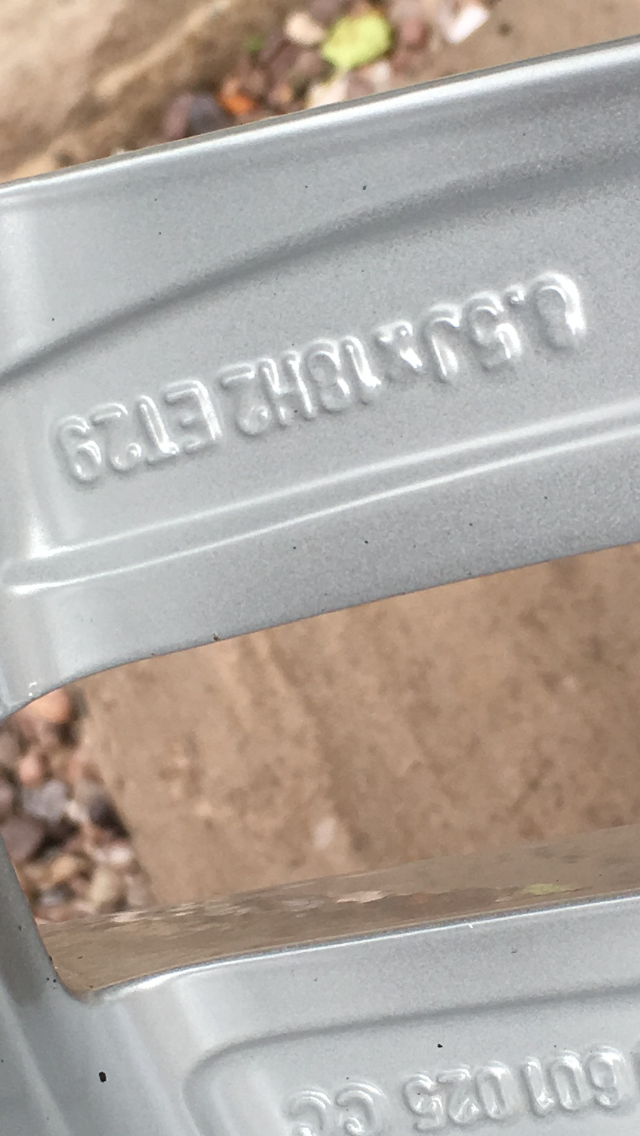

18 x 8.5 et29 FL mk2 fitment?
I’ve bought A5 alloys to fit my FL mk2 estate. Will there be any issues fitting them?
18 x 8.5 et29
TIA for any advice offered

At 8.5" et29 I think you might have a bit too much poke at the front.
Oh dear....
Will stick out like the proverbials.
At the front they'll extend beyond the guard by about 30mm
At the rear they'll be right on the body line - maybe a touch outwards.
If you really like them or they were crazy cheap you might be able to get the back of the wheel hub shaved but you'll have to take about 35mm off
I’ll sell  them on again and look for some Oe VRS items I think
