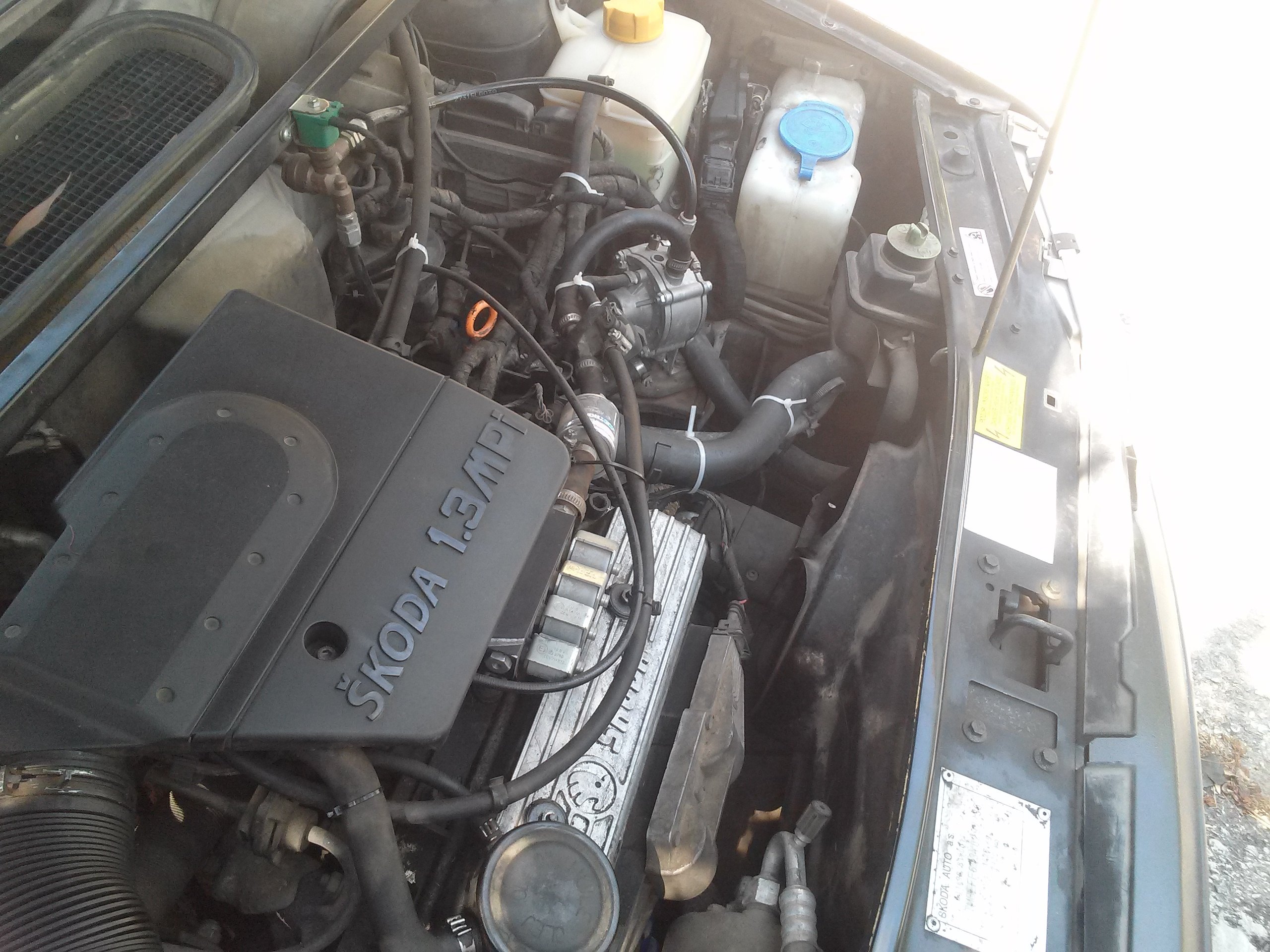

Well, similarity is only basic principle and car model :D they are different systems. :D I must say that I like retrofit box design more, is more compact :)
Btw, is your system hooked to ECU, rising idle RPM and turning off ECU on full throttle?
It is connected to the ecu and it does raise the idle by about 300 rpm but i dont get what you mean by turning the ecu off on full throttle
Sorry i meant turning off AC compressor, not ECU :D
xddd yes it does it disengages the clutch

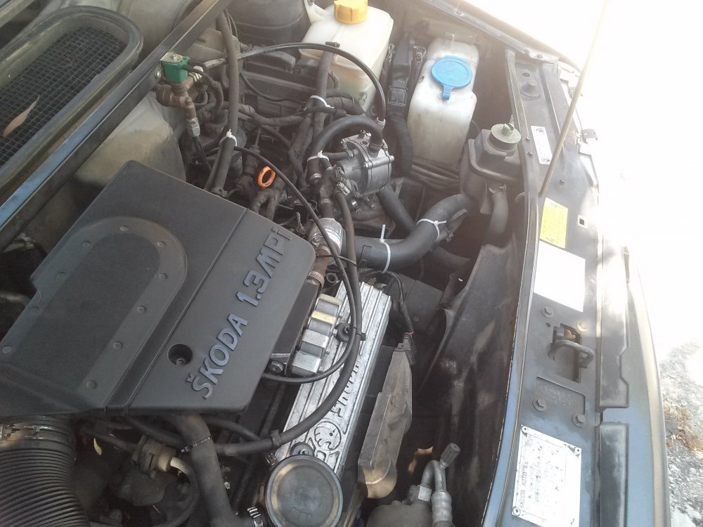

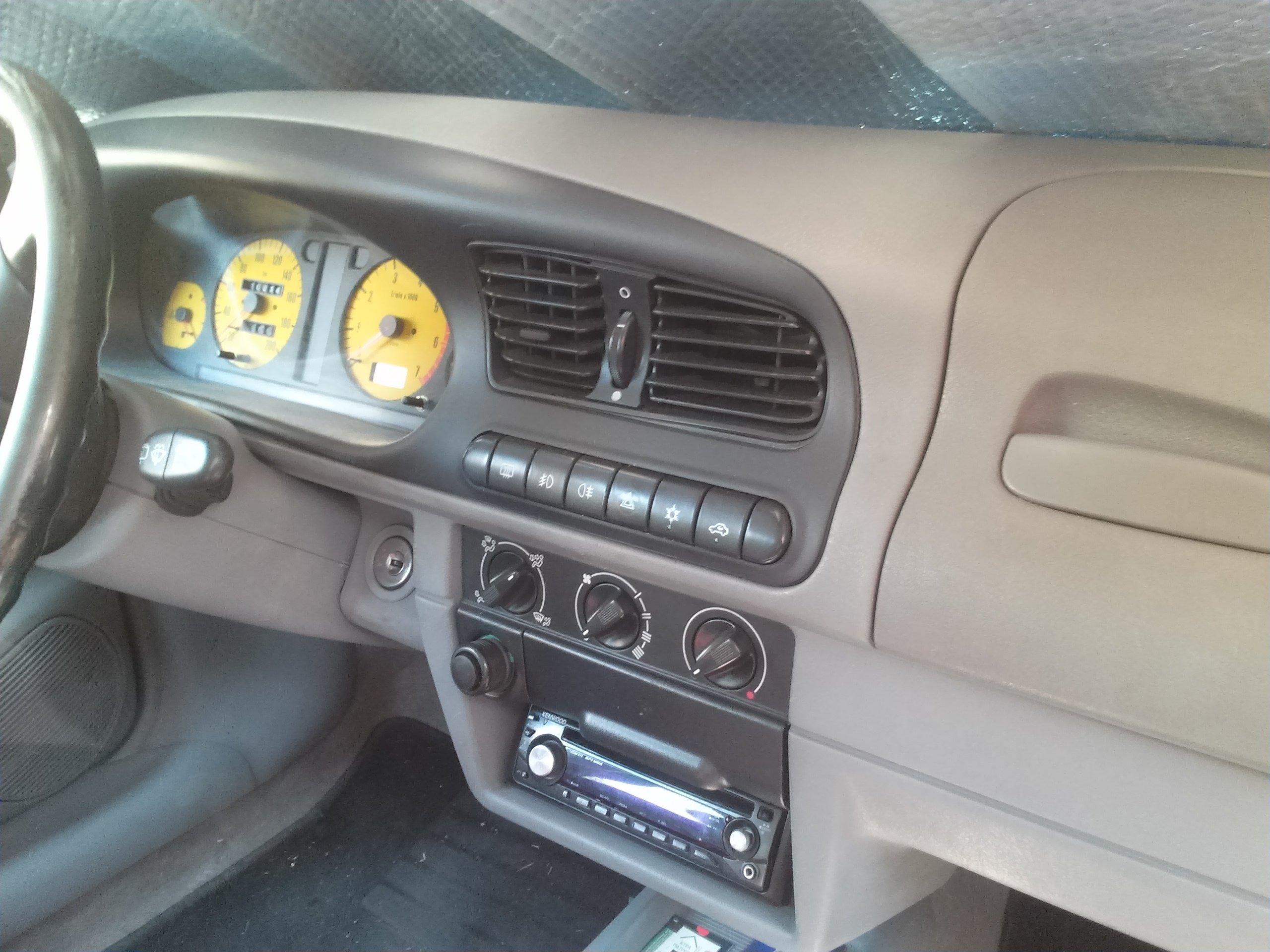

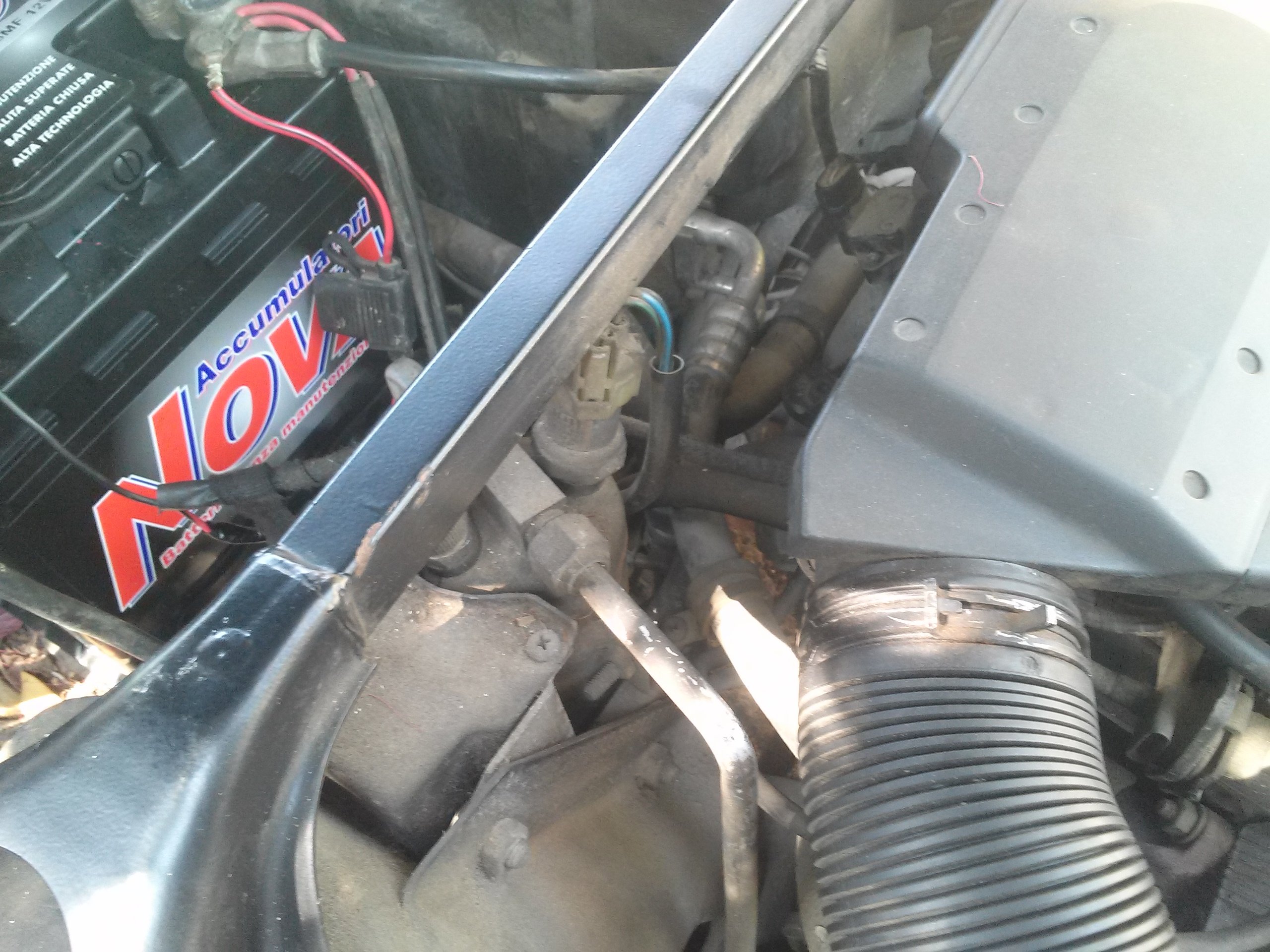

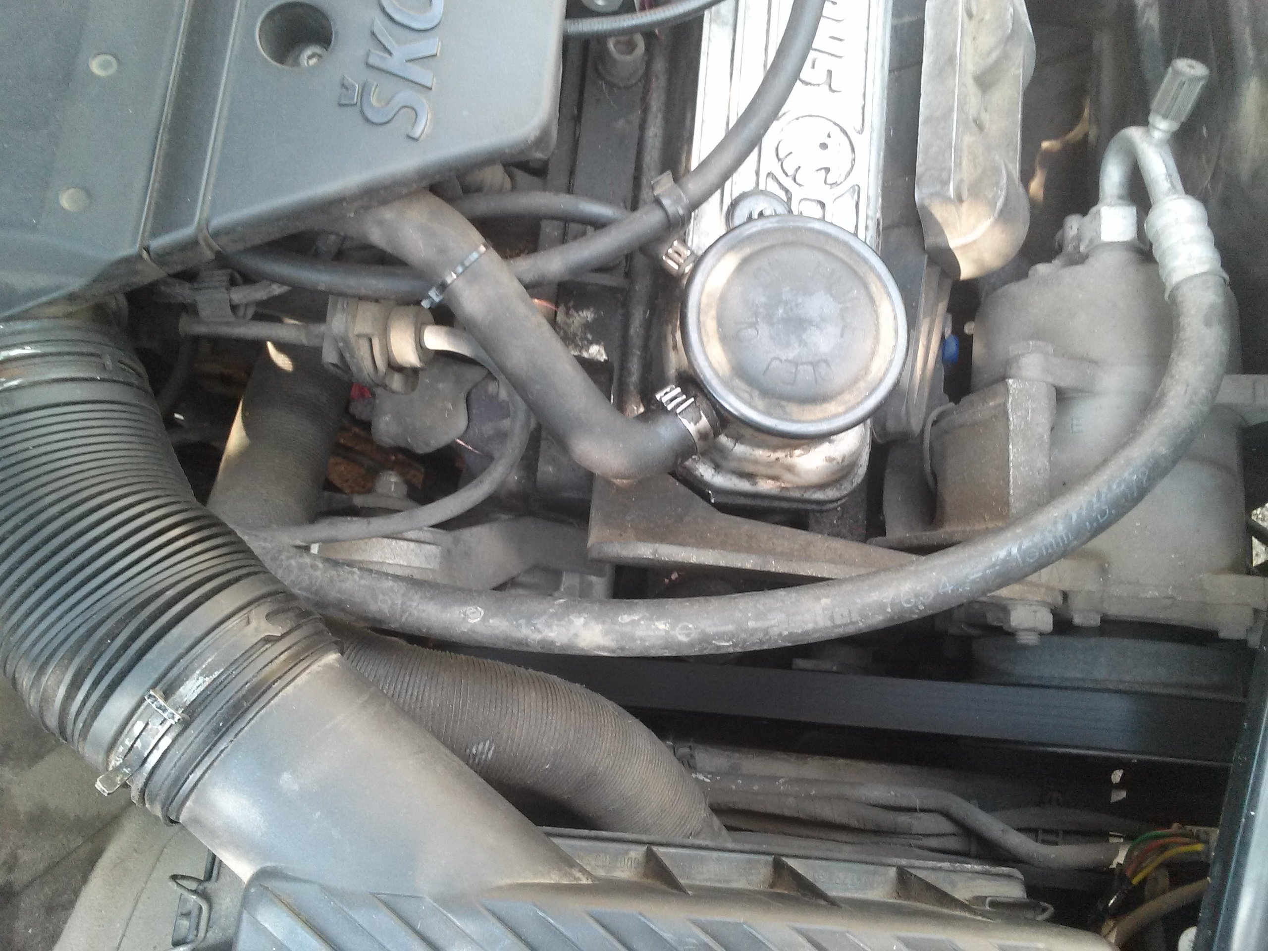

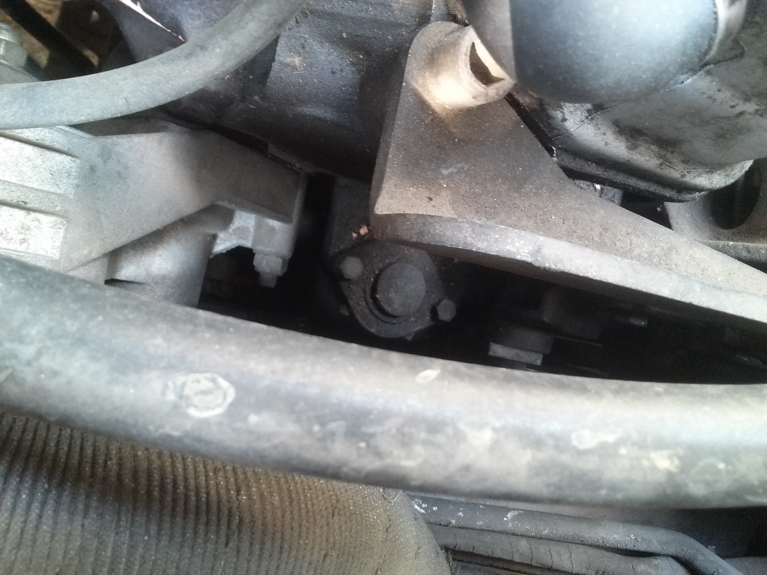

On 30/08/2018 at 14:13, Thefeliciahacker said:
All fitted from factory
Power steering pump is hard to see
Interior just to showcase the switch placement

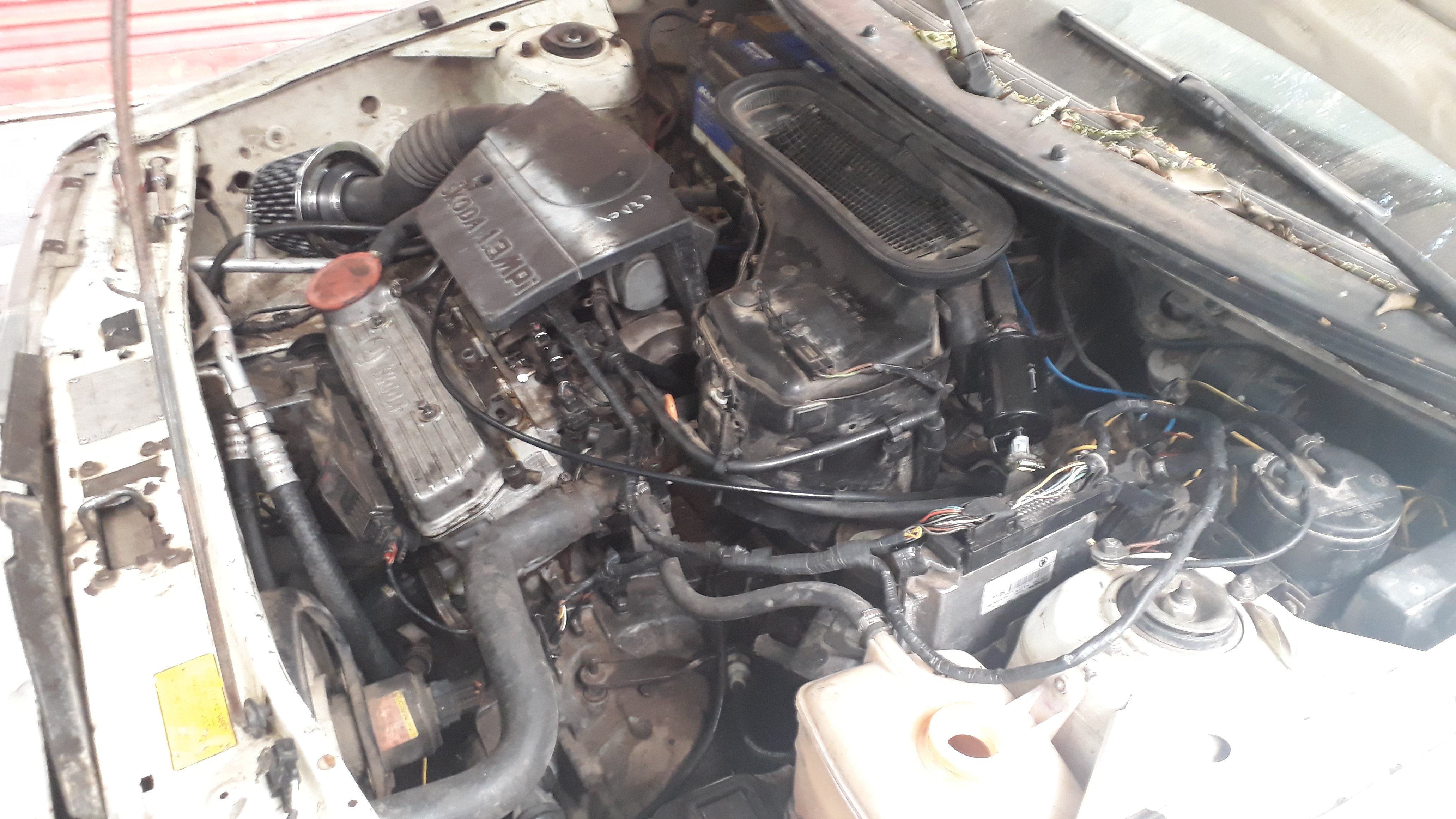

I have absolutely the same AC system in my car + hydraulic steering(1.3  mpi 50kw engine).
However did you understand if this was retrofit or original set up from the factory?
I am asking this because except mine and yours cars I know about another 2 here in Bulgaria and 1 more from Greece. And my point is that there are not only one or two cars with this systems but there are more.
The ony thing I know about mine before owning it is that she was imported from Italy.
On 24/08/2018 at 17:01, adnantaman said:
@Raychev05This is the only setup that is documented in Etka and Workshop manual.
All Felicias 1.3 with power steering and AC from dealer have retrofit setup, because factory acessory holder doesn't have mounts for both AC compressor and PS pump.

On 31/08/2018 at 08:44, Papez said:
this unit was made by external manufacturer (probably Diavia) and retrofitted in dealer's workshop.
Alex here in Greece.
I have seen the certification on the local Skoda mechanic which was beside the local Skoda dealer.
