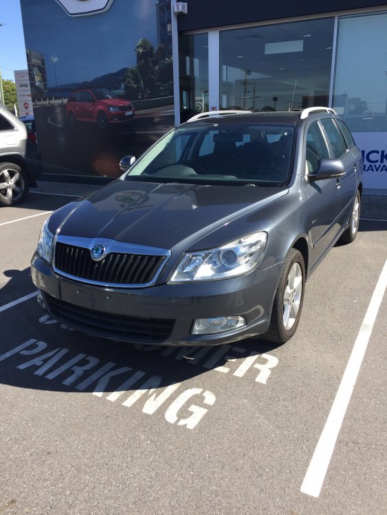

you also mention - ".....I otherwise really like the car, it’s a top spec wagon with all the extras......"
sadly again, looking at the pic - it doesn't look like it.

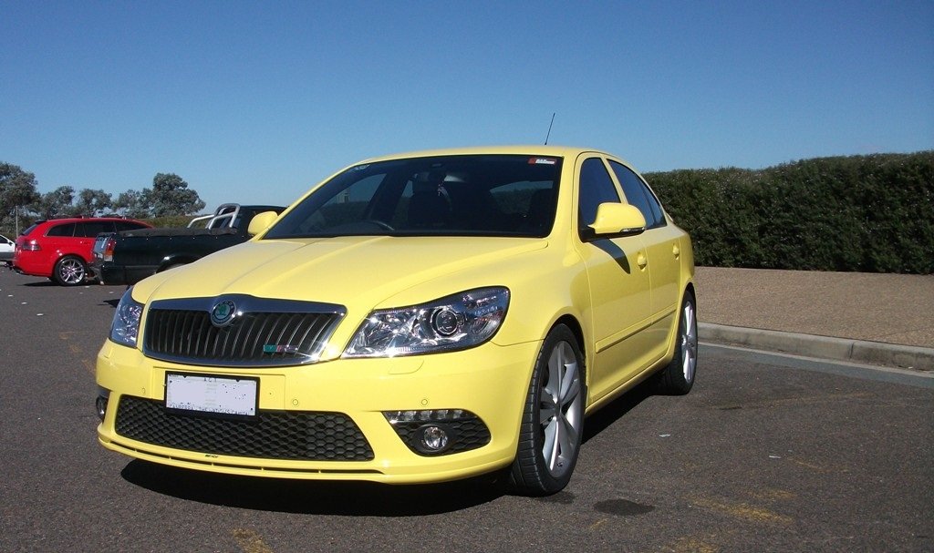

1. it doesn't have the xenon headlights
2. it appears to have aftermarket front sensors, and only 2 of them.  normally there is 4 sensors.
here is pic of my front-end.  u can see the headlight washer caps for the xenon headlights, and you can see the 4 front parking sensors.
Edited by JR RS
Okay thanks, yeah — I think you're just confirming my suspicions there around any manufacturer goodwill unfortunately.
Re: spec level, sure, I guess I was using that term pretty loosely. My point is it's not a base model and it's a nice car to own (has satnav, leather etc), so won't be a total loss if I have to spend a bit of money on it to recondition the engine.
Interesting pick-up with the front sensors, they're not actually working at the moment.
Edited by TGP
all good.
do ur rear sensors work ok?
