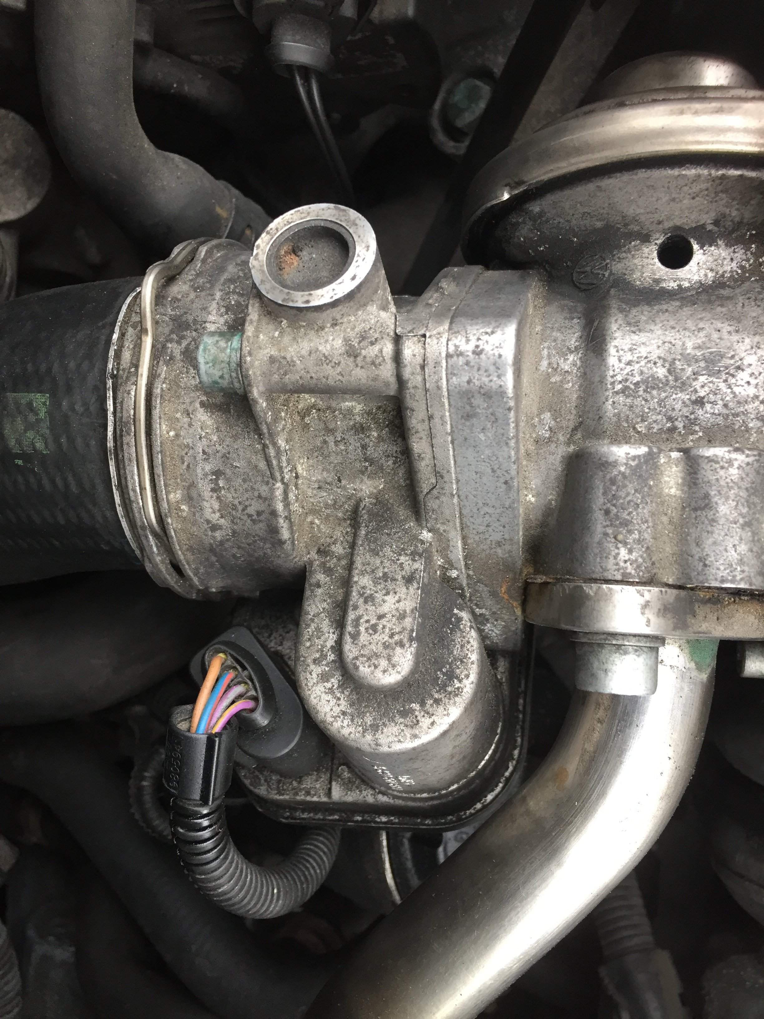

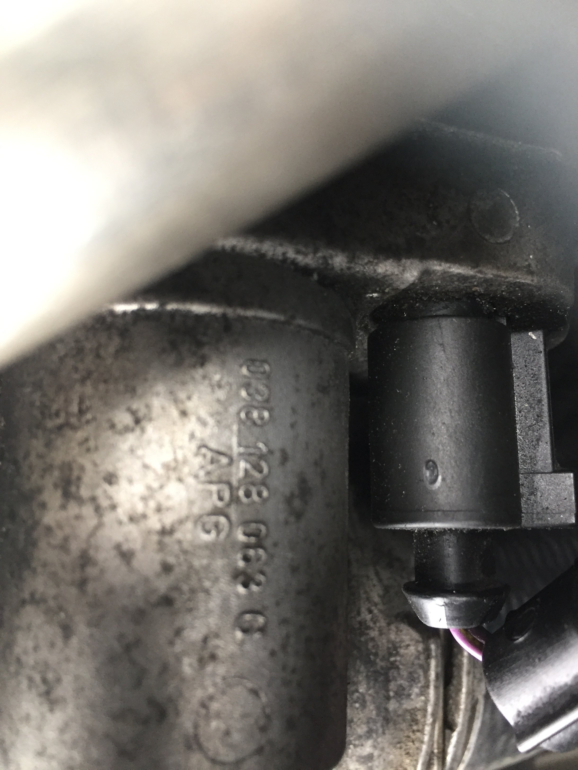

The one on the car clearly has 038128063C stamped on it, but the body doesn't seem to my eyes to look like the ones in the adverts for said throttle body reference.
Anyone else with experience with this??

@mark antony; although it looks like a C, that's actually a G on your original part. Confirmed when I look up 038128063G here and find that it was superseded by 038128063L in 2008, which agrees with the info for item 3 here.  So you should buy one that's suffix G, as @Doofy says above, or suffix L, which will also work.
As for what it does, two things that I am aware of. Firstly it helps the engine shut down cleanly; as diesels like to carry on running even after the fuelling ceases. So shutting off the air supply helps reduce shudder (these valves are sometimes/earlier referred to as anti-shudder valves). Secondly, I believe it has a function as part of the EGR system, artificially generating lower pressure (by throttling the incoming air) in the intake tract so that more EGR flow into the engine can be achieved than might otherwise be possible; under certain operating conditions.

Wino ( and Doofy) Thanks for such a complete answer. So much for my 'clearly marked as C'!
