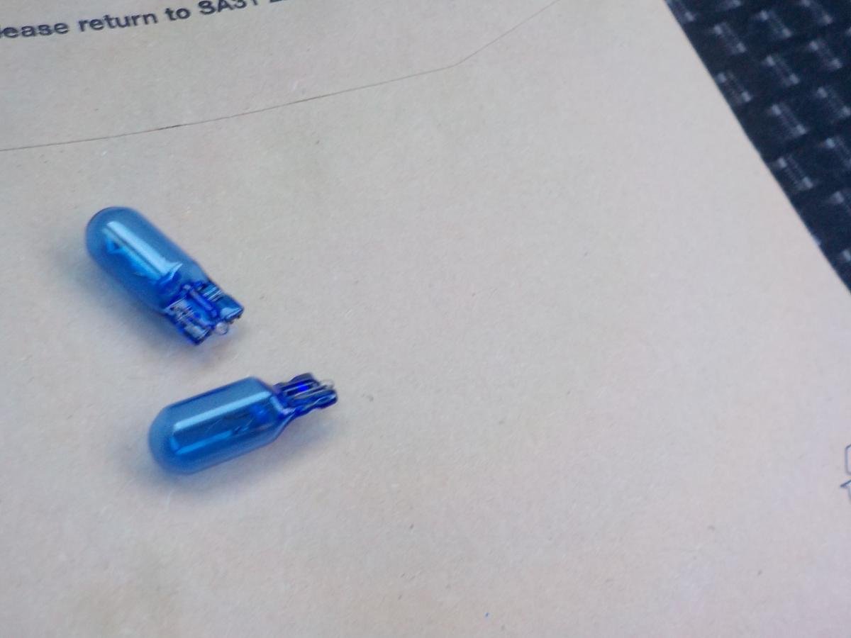

OT a bit, but before anyone asks about Mk2 vRS lights and the sidelight bulb.
The Blue bulb is a dummy and the DRL Unit is also the Sidelights, and the car has no front fog lights, and when the MOT Examiner fails the car on no Sidelights tell them to think about it.
