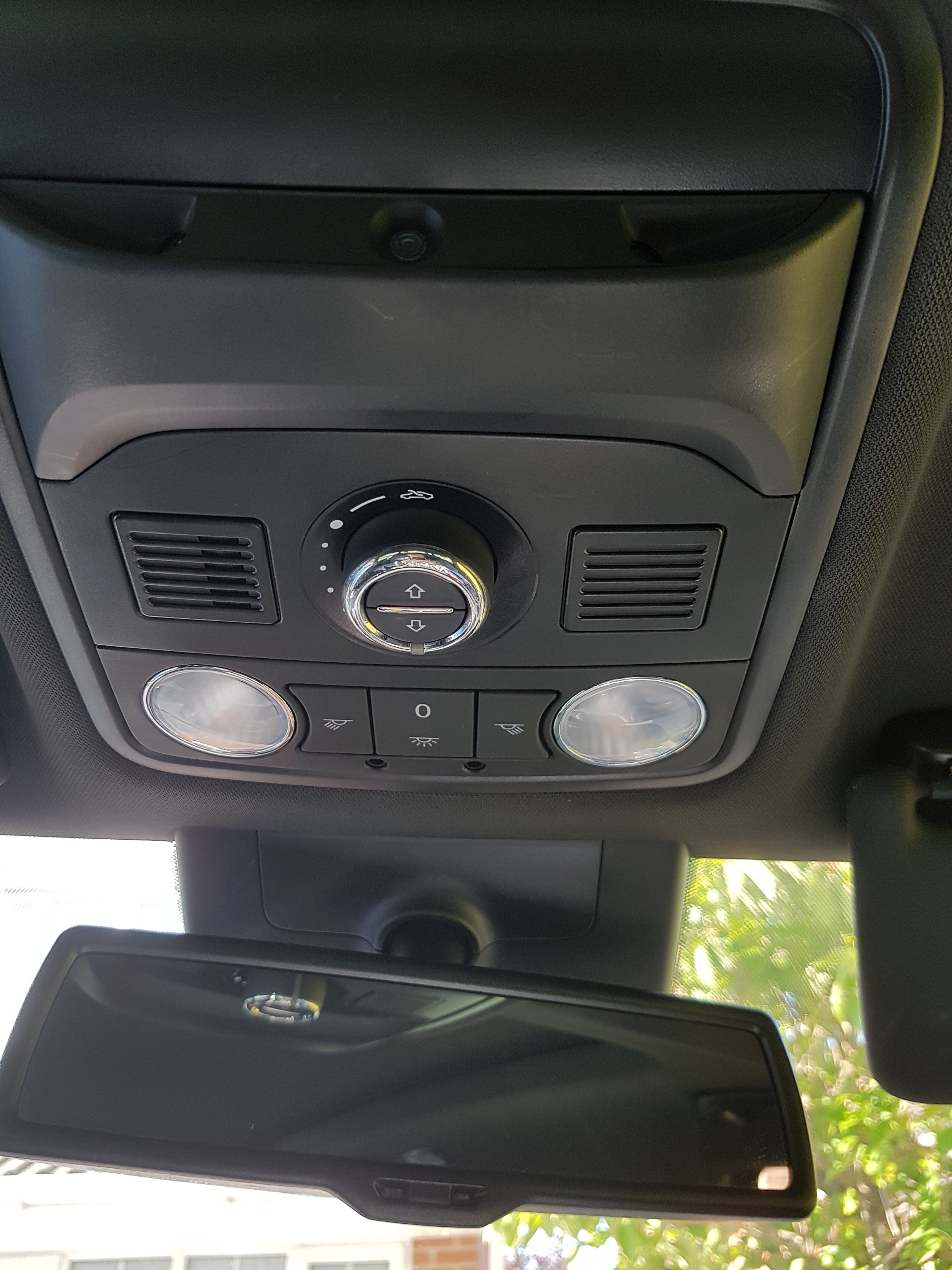

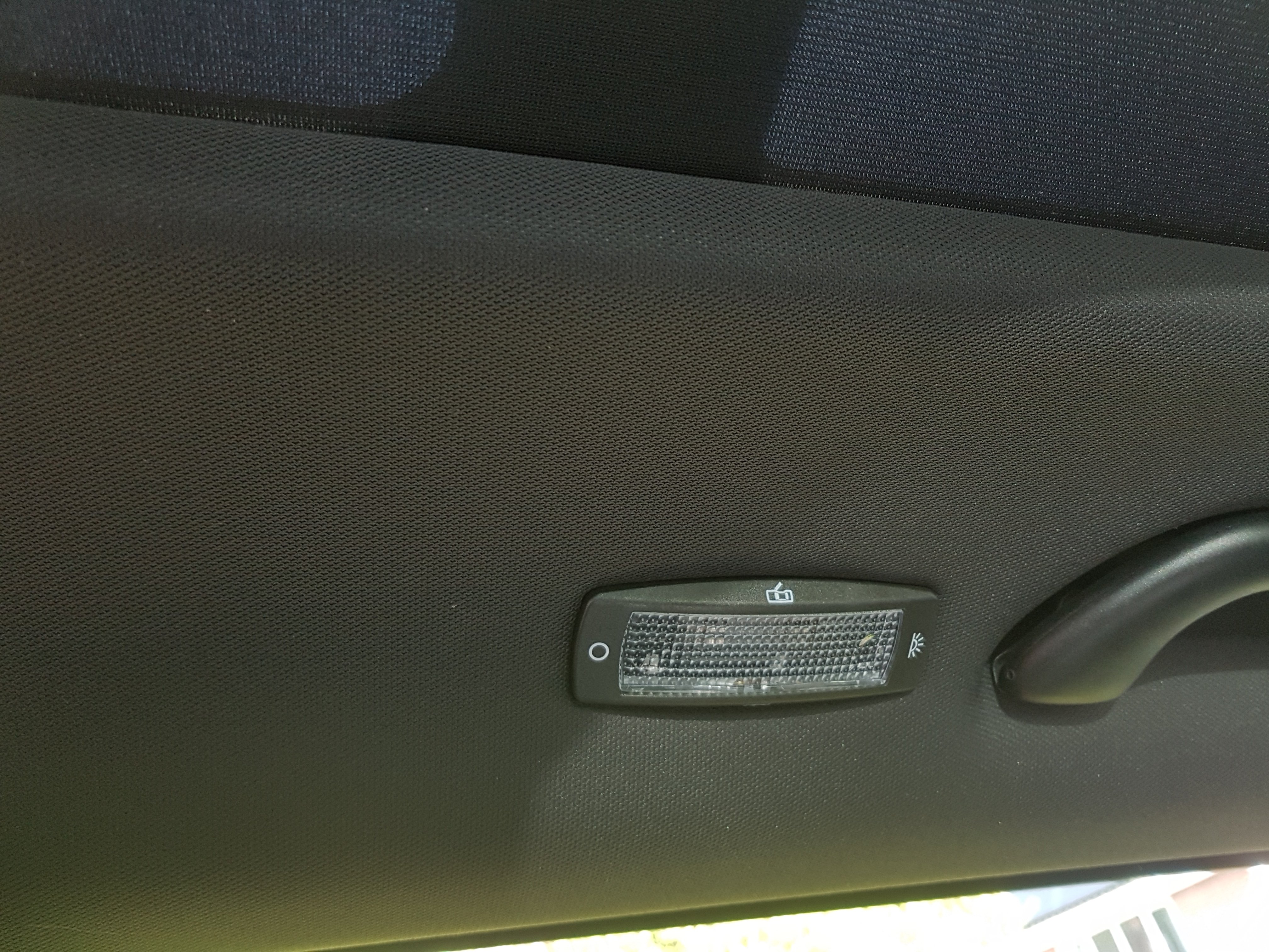

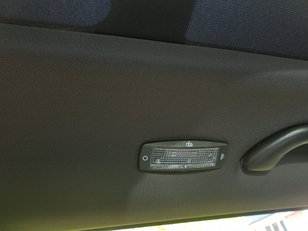

I have a 2016 VRS Estate with panoramic roof, I'm wanting to upgrade the lights inside to LED.
Can someone please confirm how many and what type of bulb I need to do the inside and the boot (I'm not too fussed about the red door lights). I don't think I have foot well lights. Any links would be brilliant as well.
I have attached pictures of the interior light cluster.
Thanks in advance.
All the interior lights should be 501 w5w standard sidelight bulbs. How many bulbs you need is just a case of counting how many lights you can see.
The only thing to bear in mind, is the size of the bulb you get, as the mount for bulb prevents you having a larger sized bulb.
Have a look on my thread and you'll see what I did. A few tweaks planned - Page 2
The rear dome lights (first picture) are 36mm festoon, all other are t10 / w5w / 501.
This is correct. They are different if panoramic roof is specced. :thumbup:
