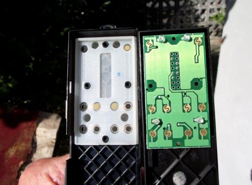

New switch finally arrived. Sorted. Interestingly the insides of the old one are just like a TV remote. No mechanical parts. Just a circuit board and silicon overlay carrying 'carbon' contacts which short the various contacts. Couldnt find a fault but a clean of each shorting button would probably work. However it's in the bin.
Cleaning didn't work on mine but a new switch did. I think the conductive pads on the buttons eventually fail. There are lots of YouTube videos about TV and other remotes doing the same thing and being 'repaired' with anything from bits of glued on foil to conductive paint. You can even buy conductive pads on ebay but I don't think they would last long.
