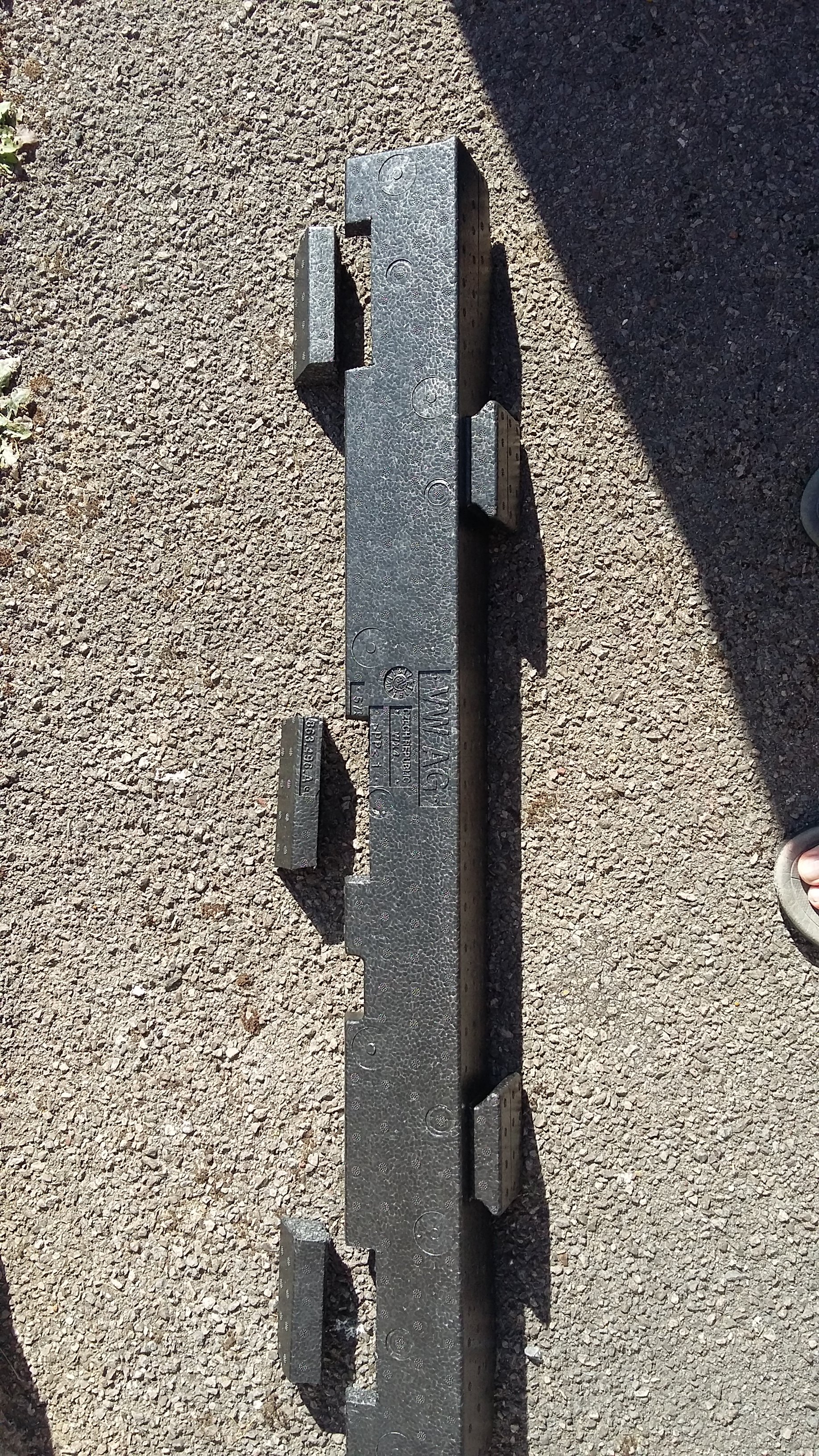

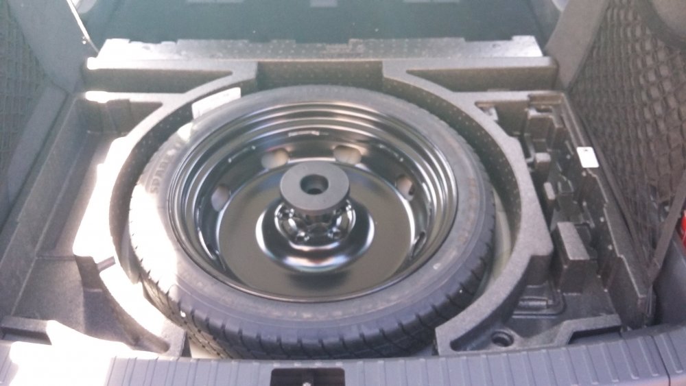

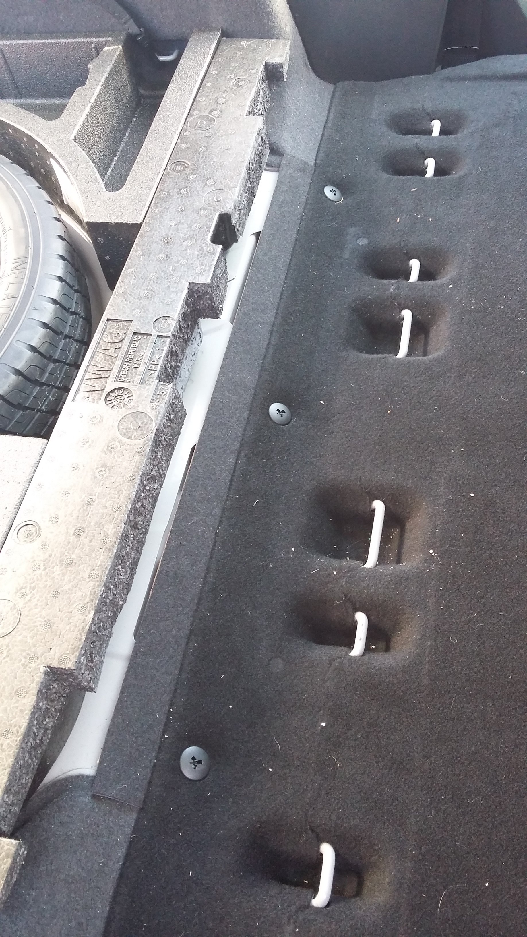

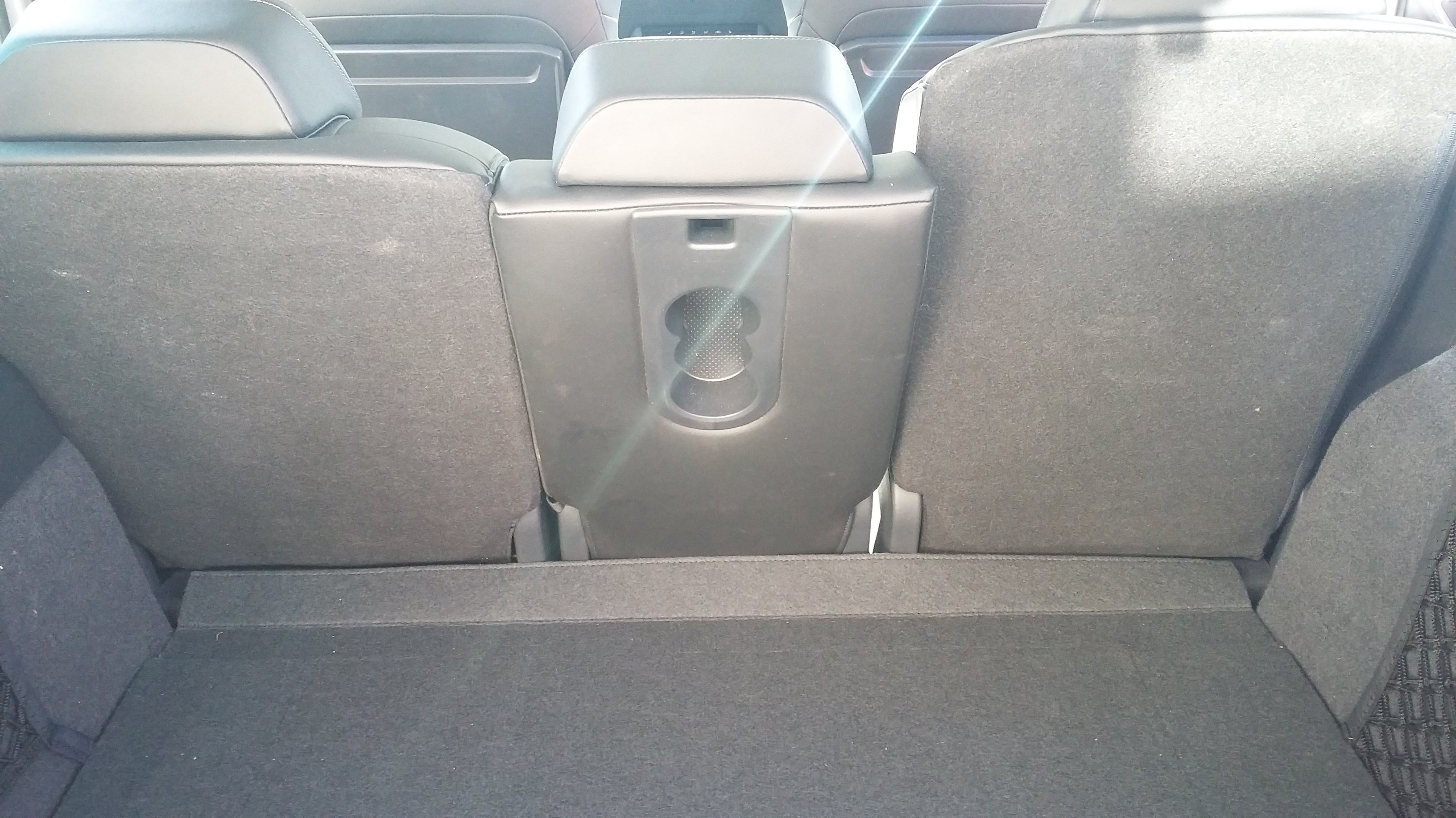

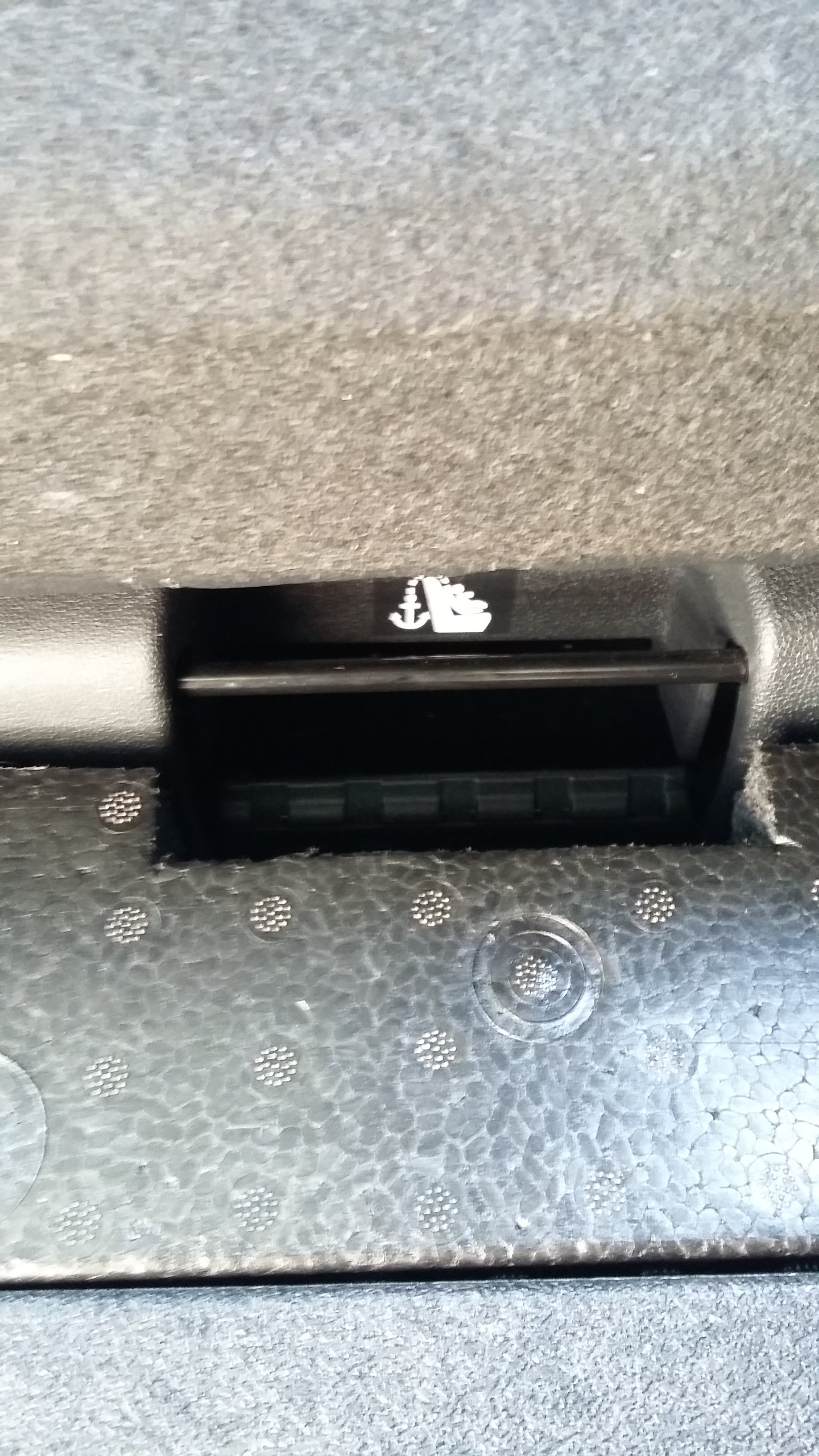

I sourced the parts from TPS Brighton (VW Group parts supplier) for £88,34 for the Spare Wheel Kit (part number as above) plus £158.23 for the wheel itself (yes, I know I could have done it cheaper but I wanted to be sure if it didn't fit there would be no problem taking it back). It took a week to arrive. It does say for non-Varioflex but I carried out the same mod as cr1100 - it was very simple, some careful cuts with a Stanley knife to accommodate the seat handles. Here are some photos.
Photos of the finished job.

Just a point about the fit of the polystyrene kit with varioflex seating the polystyrene has to be cut down across the width to clear the seats if you need to lift them up but there is no need to make cutouts for the seat catches as they are pocketed in the seats so you can get to them easily enough.
