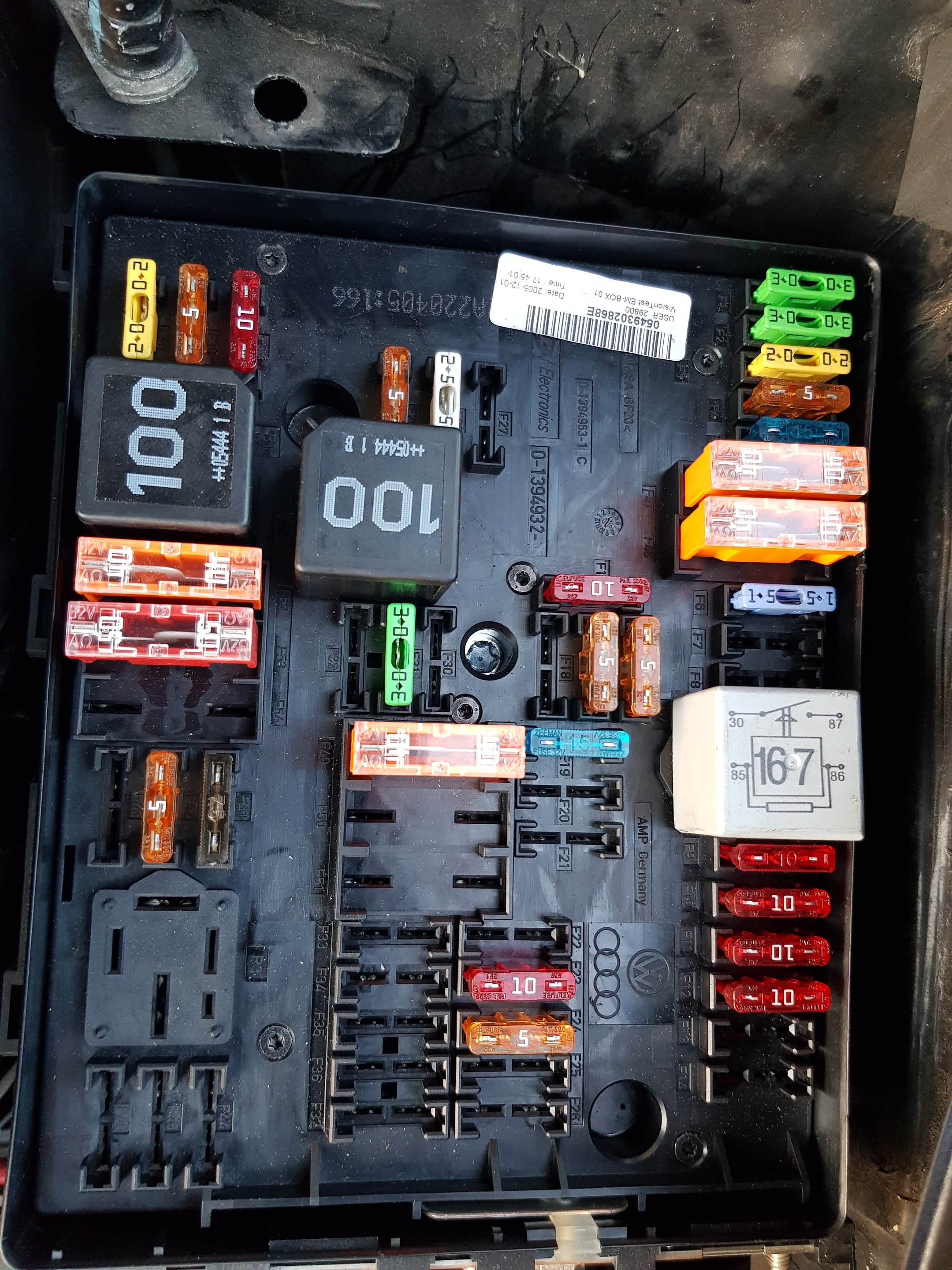

Hi guys,
I'm a bit stumped looking for the fuse for my MAF.
Looking at the site below and going through all the fuses I strangely seem to match the 'Version 2' list even though mines a 55 plate?!
https://fuse-box.info/skoda/skoda-octavia-mk2-1z-2005-2008-fuse-box-diagram
Trust that list not too have a MAF Fuse though! Any ideas which number i'm looking for??

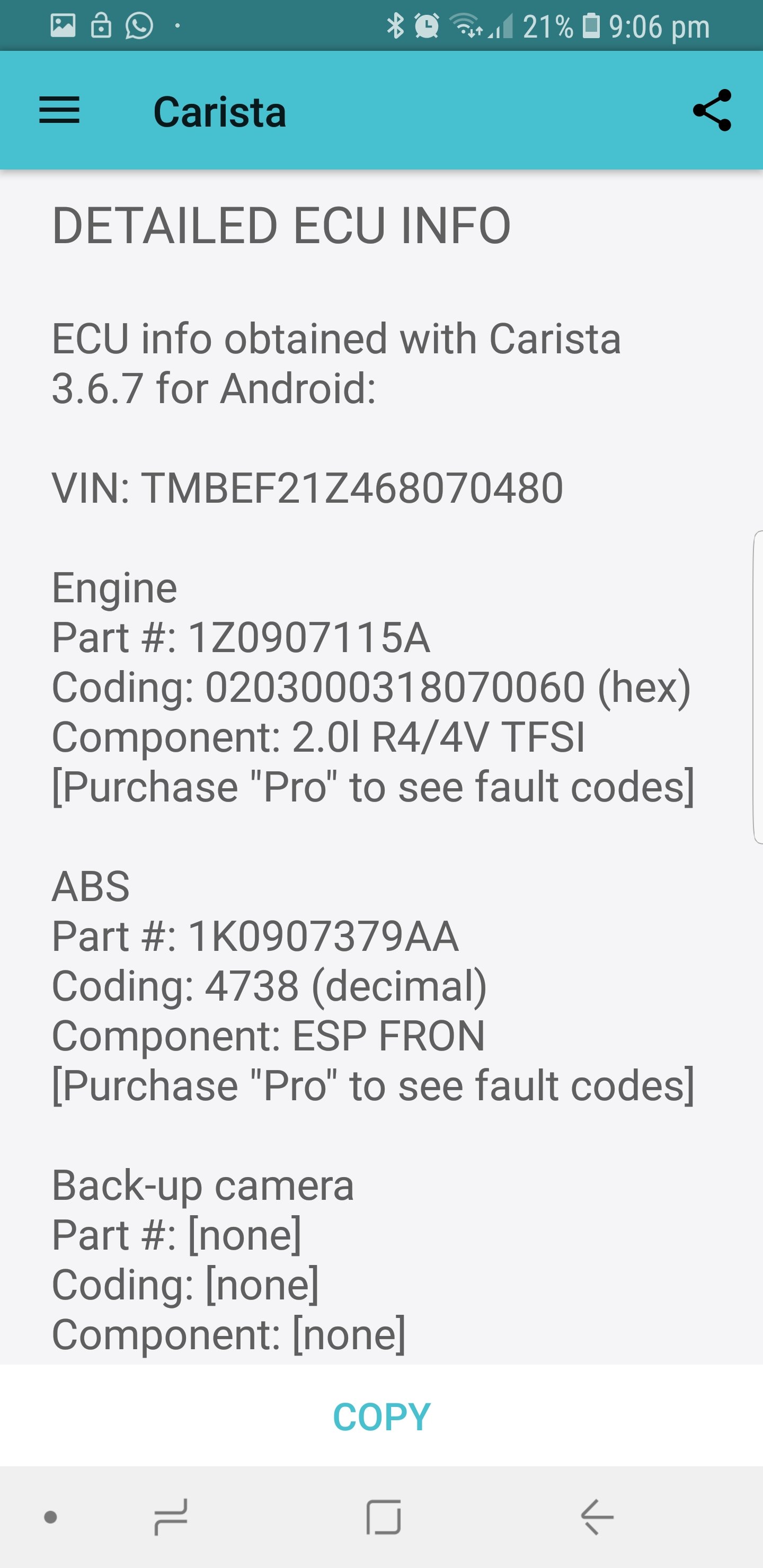

Do you know what your engine code is? Makes looking up wiring info far easier.
Pretty sure it's BWA mate

Fuse 29 in dash panel fuseholder, 10 Amp. Shared with crankcase ventilation heater, so unplug that if the fuse keeps blowing, to see if that's at fault.

Well.....that was the problem!!!!!!!!!
Wino I have messaged you privately...
Fuse 29 was missing! Fault has now gone and all back to normal, so many fuse diagrams out there which threw me off the trail :sadsmile:
