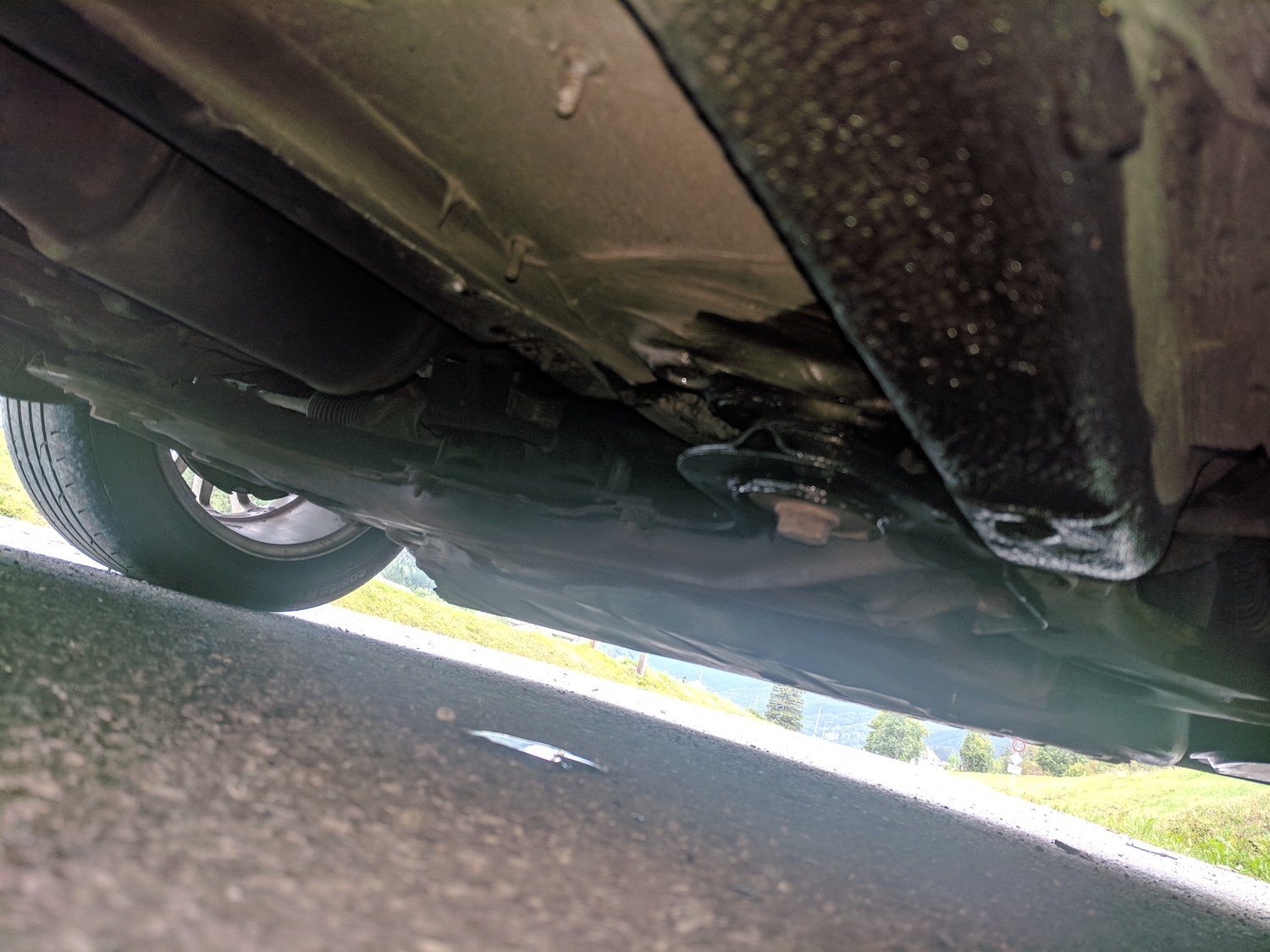

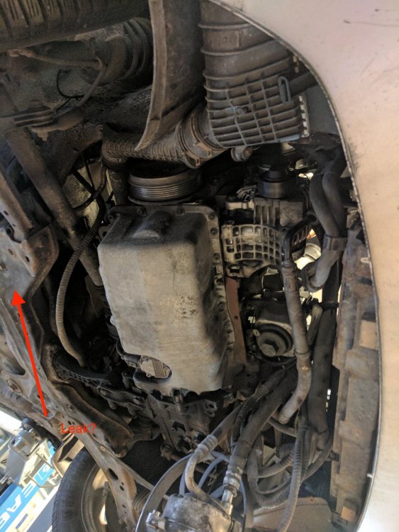

- The leak seems to be from behind the engine on the passenger side. Havn't been able to locate the leak from the top of the engine-bay other than I see that there is liquid on the very bottom parts that is located in the very end of the engine-bay next to the passenger seat.

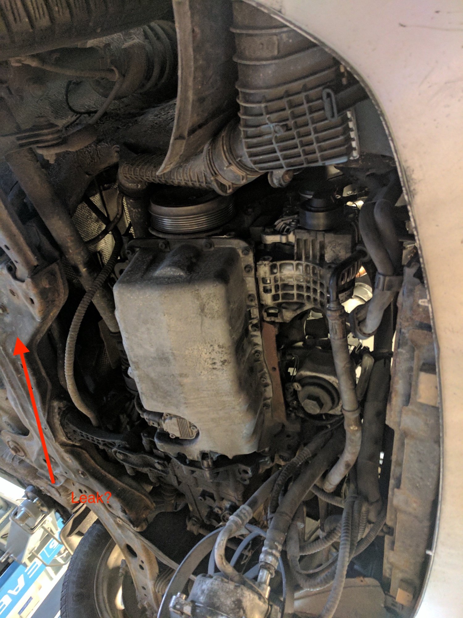

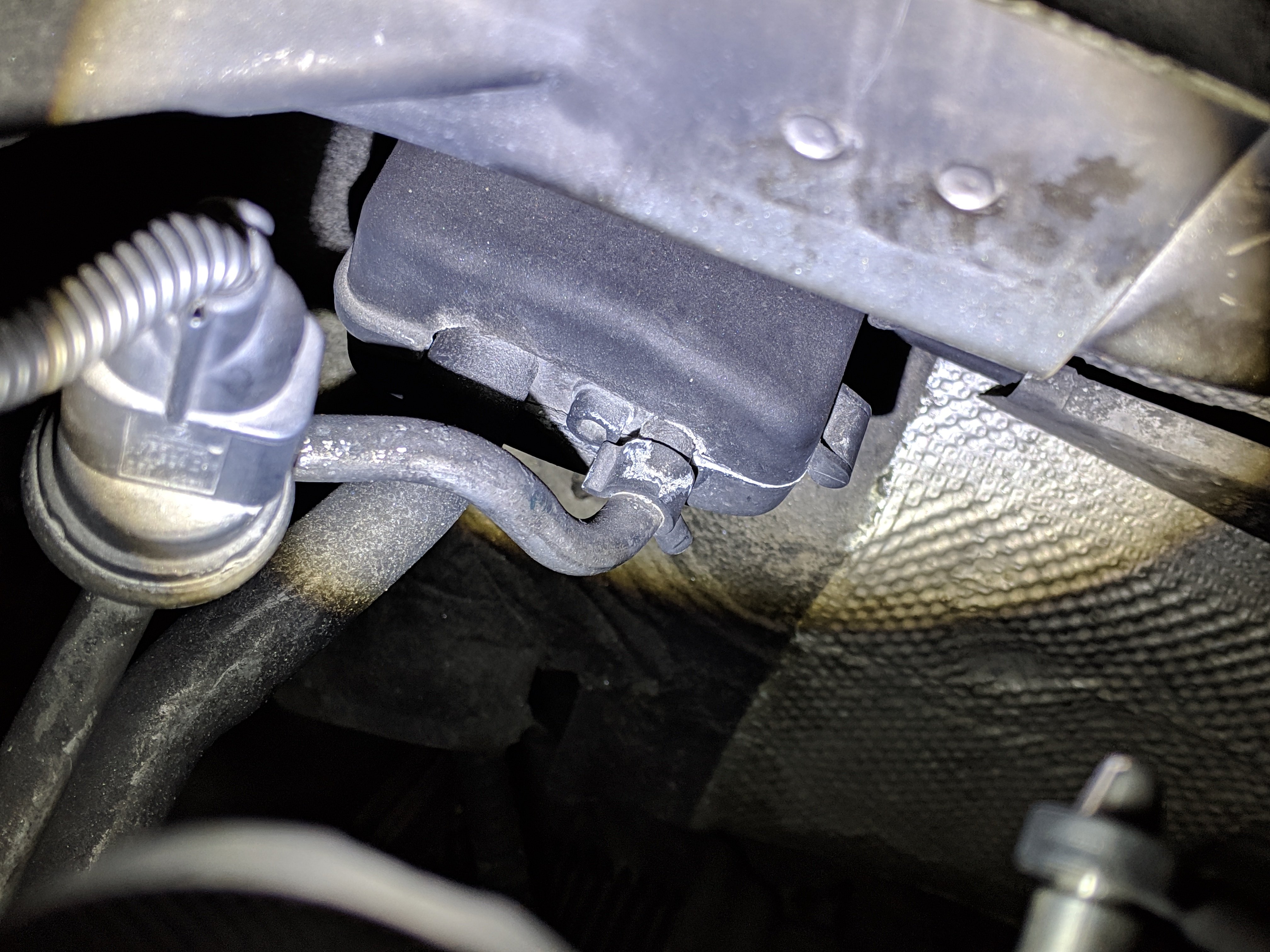

1: When I changed the alternator a year ago or so to see under the car
2: The leak from under the car

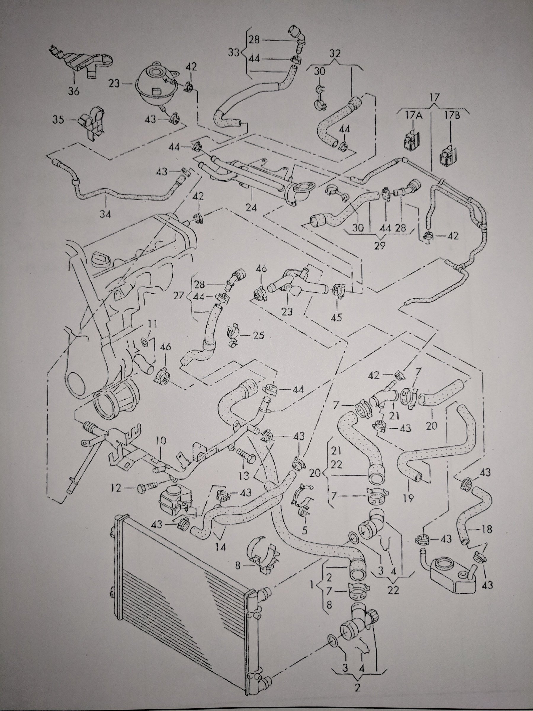

3: The picture of what I assume is my ASV heating pipes (for the AGR,AHF,ASV,ALH and AQM engines)
@lhlied - Your description makes me think that you have a leak in the heater hoses or matrix. Is the cabin always "wet" (suggests matrix)? If you use the heater (not the air con, with Climatronic use "Econ" mode), park and wait half an hour, do you get drips of water on the ground or undertray (suggests hoses)?

@lhlied - Well, if the cabin stays dry, it's probably the heater hoses (from engine or radiator hoses to top left of bulkhead.
The reason for mentioning air con off (Climatronic in Econ mode) was to avoid the red herring where a pool of condensate from the AC chiller forms under the car.

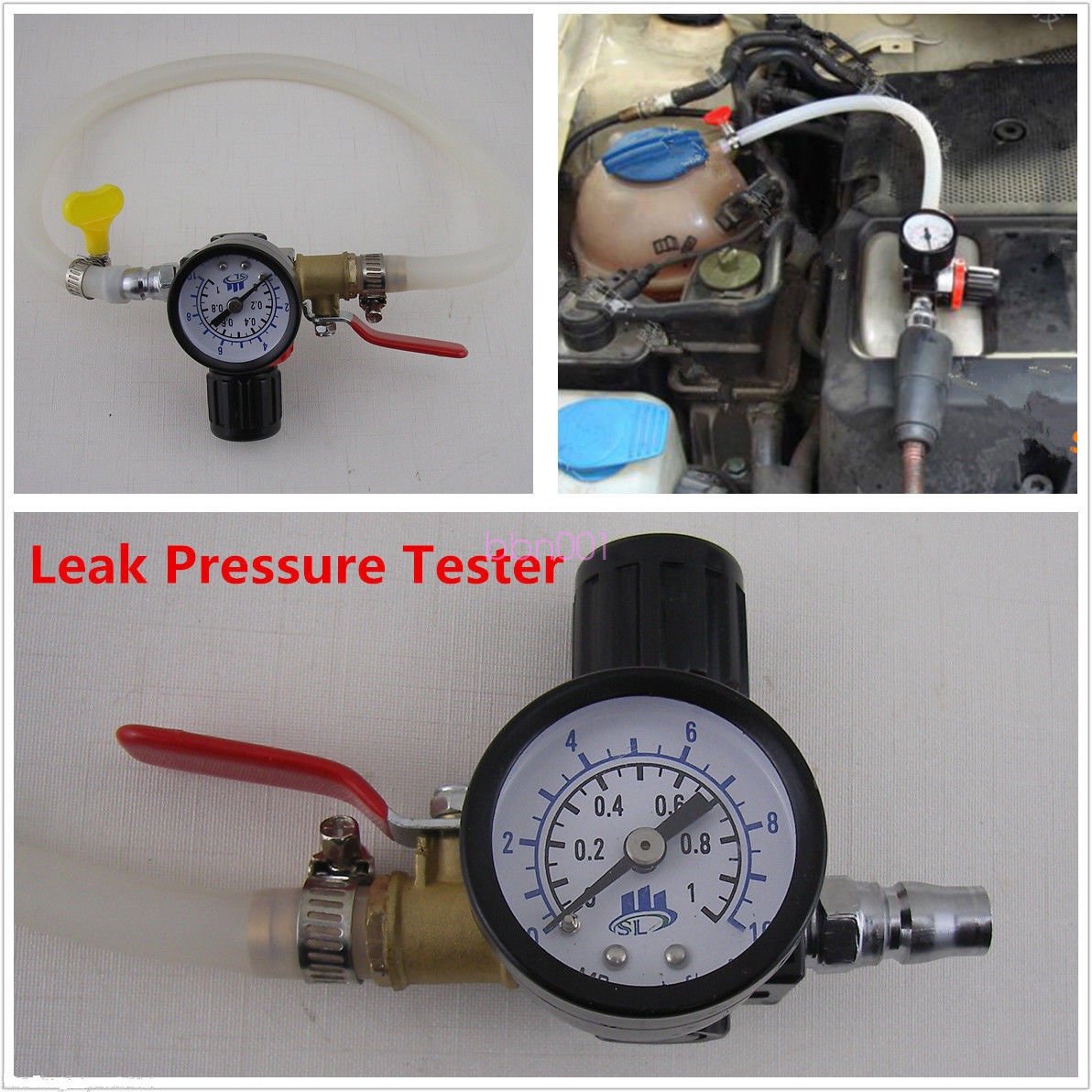

I see from this photo that I took from ebay that its possible to pressure test using the returnpipe to the reservoir. Sounds like I should be able to build something to be able to build up some pressure to then be able to locate the leak. Any clue how much pressure is possible to use max on such test?
Just a thought; could you use a tyre pump with pressure gauge as a measuring device here?

Well. I've received the pressure tester, but clearly I'm not a skilled mechanic.
The pressure drops slowly when I used the compressor through the pressure tester that I bought from ebay (see picture above). So yes there is a leak, but to me it sounds like I have to dismantle more to be able to locate this leak. I did hear a small leak near the reservoar, but didn't locate any leaks around the reservoar/refill bottle.
I guess I should just try a bit more with the pressure test and try to start to dismantle a bit more to see if I'm then able to locate it. So far I havn't tried to dismantle anything to get a better view.

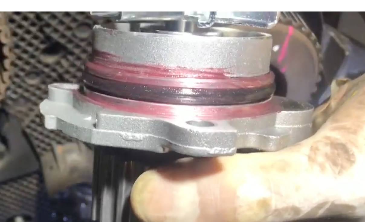

A question: when changing the waterpump, should one use some sort of lubrication like in the photo below, and if, whats the name of that kind of lubrication?

@lhlied Firstly, I think that is an "instant gasket" compound, not a lubricant.
Secondly, if I was using a gasket compound, I'd put it between the rubber O-ring and the mating face, but not over the O-ring.

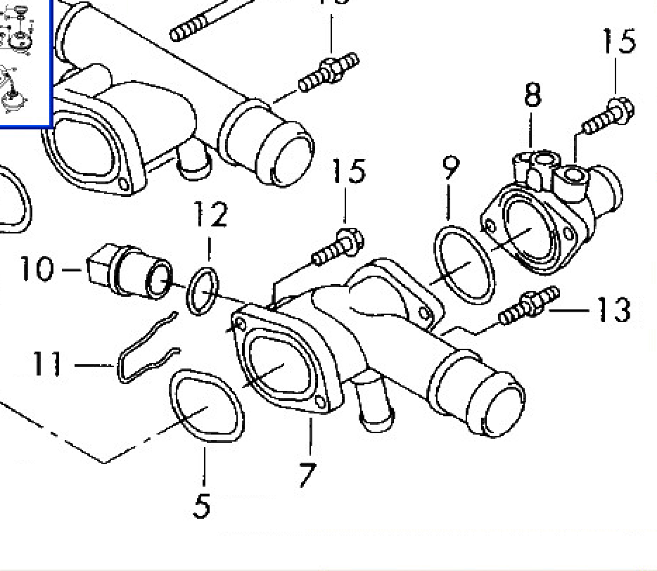

Though there seems to be a couple of obvious things I should have checked at a much earlier stage. On the drivers side of the engine around where all the temp-sensors are located there are two gaskets ( 5 and 9 below). On my car that area has alway been a disaster. Black and dirty. So I took it apart, and gasket number 5 was broken, luckily I had a spare one, tried to pull things together, still doesn't work but I see there is a leakage on gasket number 9 as well.
So my advise to you, consider to check proper for leaks, change gaskets and check the plastic casing if you have number 7 in a different version in plastic. That might save you heck of a lot of work...
