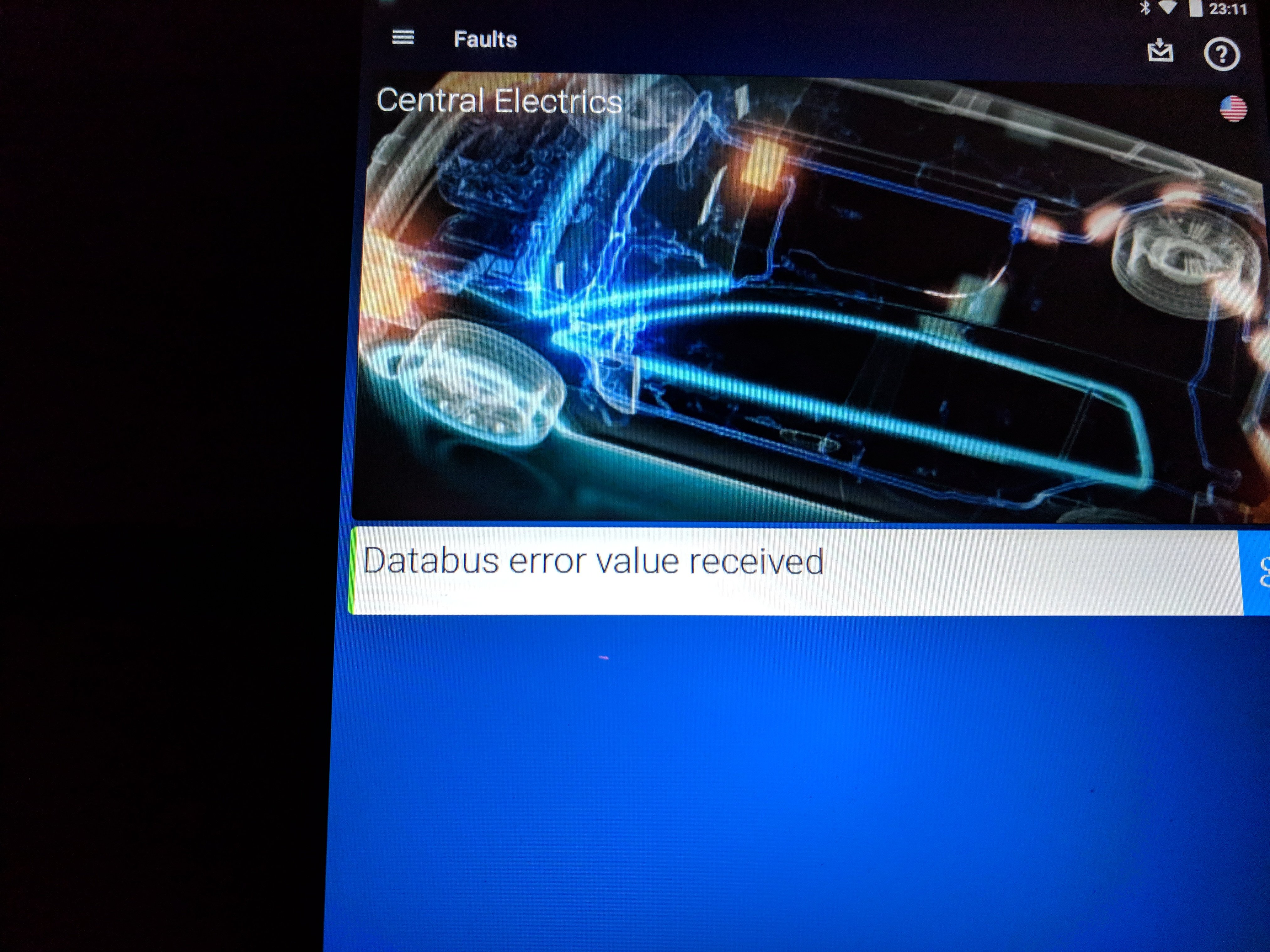

I've just been out and plugged in the OBDeleven, after a scan, it came up with 1 fault on the central electrics. All it came up with is as shown in the photo.
I had a quick search, but couldn't find anything concrete. Cleared the fault and it's gone. But as I and others said before, it's come, gone and not come back. Very strange in all honesty.
Sorry I couldn't shed any more light on it for you.
