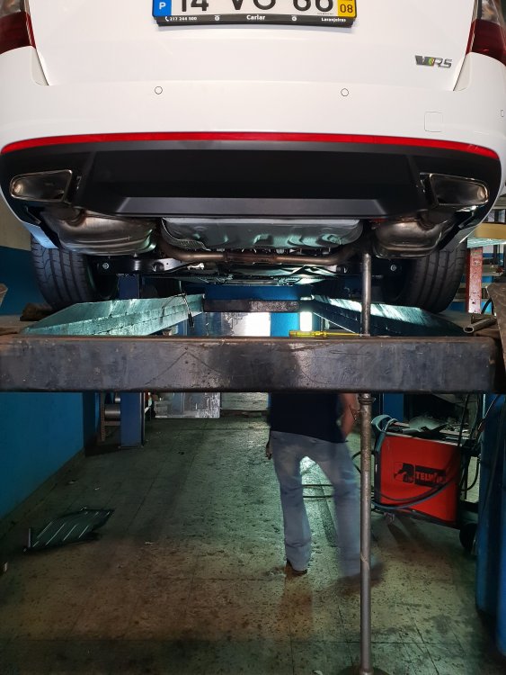

There any many opinions about if its possible, if it fits, if its the same ir not...

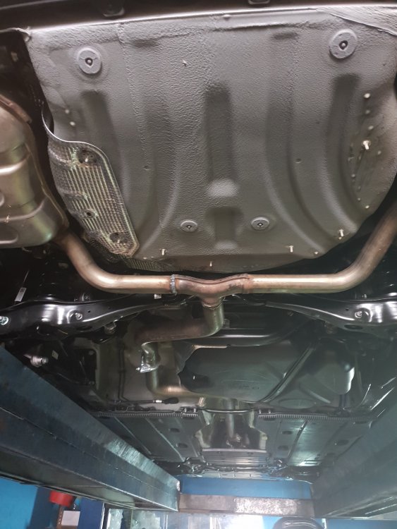

I have a MK3 facelift TDI RS, and just fitted the TSI RS backboxes. Both Middle pipes have exactly the same size and are placed on the same position. So bought from eBay original backboxes from RS TSI. And fitted like a glove.
Just cutted the Middle pipe, removed my backbox. Added the right backbox bracket support (bought from skoda) and fitted them. Just easy as that! Direct swap.
Also, bought both Chrome exhaust tips from RS TSI, the diesel Ones are different.

No heat shield on the right?
Forgot ahahahah but already ordered it
