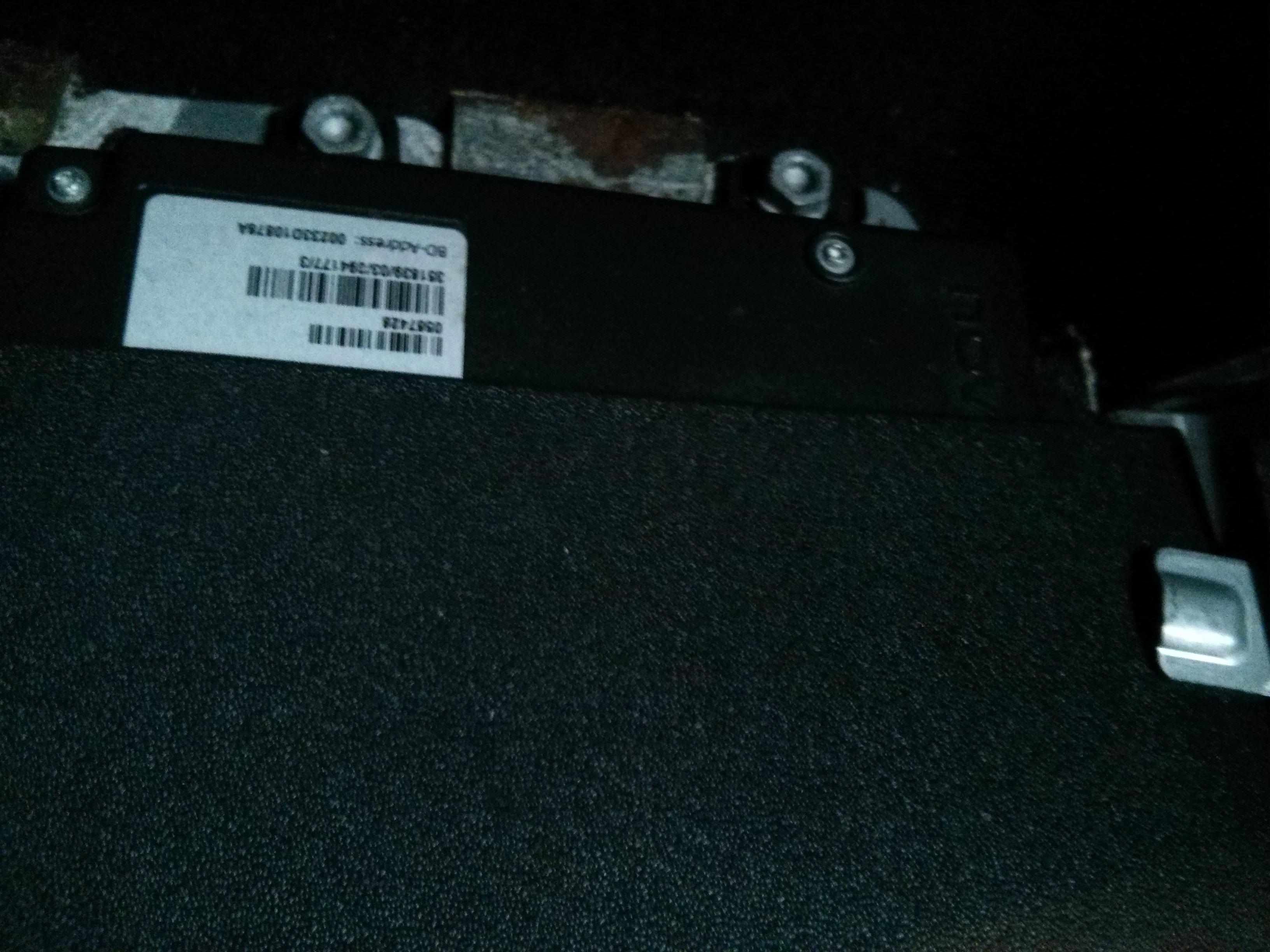

Which phone do you have? If it is an iPhone, they're known to have issues with BT connectivity ... one other simple check if you have the phone bluetooth module or now - it should be located under the passenger seat, something like this:

There is this thing under the driver's seat which is probably OK for a UK RHD car. Is this it? I don't have any of the phone options in the maxidot so, at best there is something missing or not connected. I have android phone but am nowhere near even trying to connect it. It is not that it won't connect there is no way to attempt it. Thanks for your help.image.thumb.png.7acd9d64bfdd6ff4fe29af0d03bb7cb3.png
Yep, that's the BT module, in the upper right corner you can faintly see the letters "nov" (Novero, brand), a wild guess would be that it is a part.no. 3C8-035-730-A (your car being made in '10). You could try to reboot the device, although it probably won't help much ... it would be great if you had access to some diag equipment (VCDS at least), so you can read what the system is telling you (but isn't clearly showing you)
