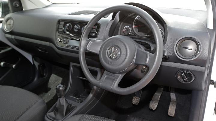

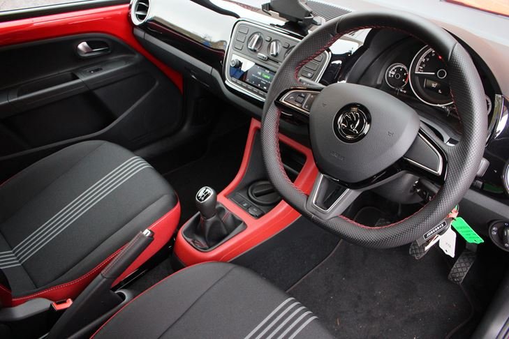

I have a take up! which has the centre console like below,

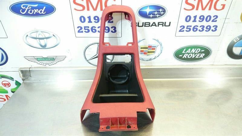

I have bought a second hand Cherry Red Monte Carlo centre console,
Either what the code for the parts that fit the new one, or whats the best way to release the inner clips so that I can use my old cup holder instead?
Attached are examples from the net to  show you the difference,
Also the part came as shown
Any help is greatly appreciated,
Thanks

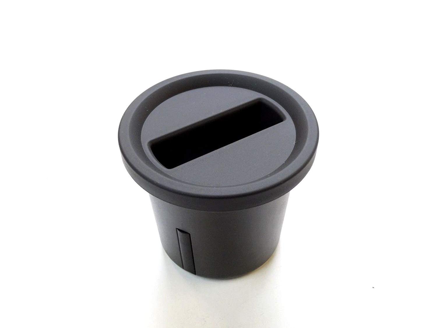

I may be misunderstanding you, but isn't it the same design of centre console (bar the colour) and the phone holder thing just lifts out:
Sorry my bad :giggle:
the bit thats missing on the bottom picture of the cherry dash, not the phone holder,
also the design is different in the centre as the up has 12v and a blank bit whereas the other has lift out pieces
Edited by Brooksy96

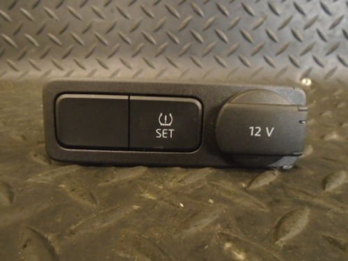

I think I'm with you now! :D I think the middle section with the cup holder bit is welded in to the plastic - the best solution would be for you to get a one of these - the part number is 1ST953508A you'll end up with a tyre pressure monitoring switch that doesn't do anything -if you get one second hand -you should get the frame with the 12 outlet on it which I think is 1S0863617A
