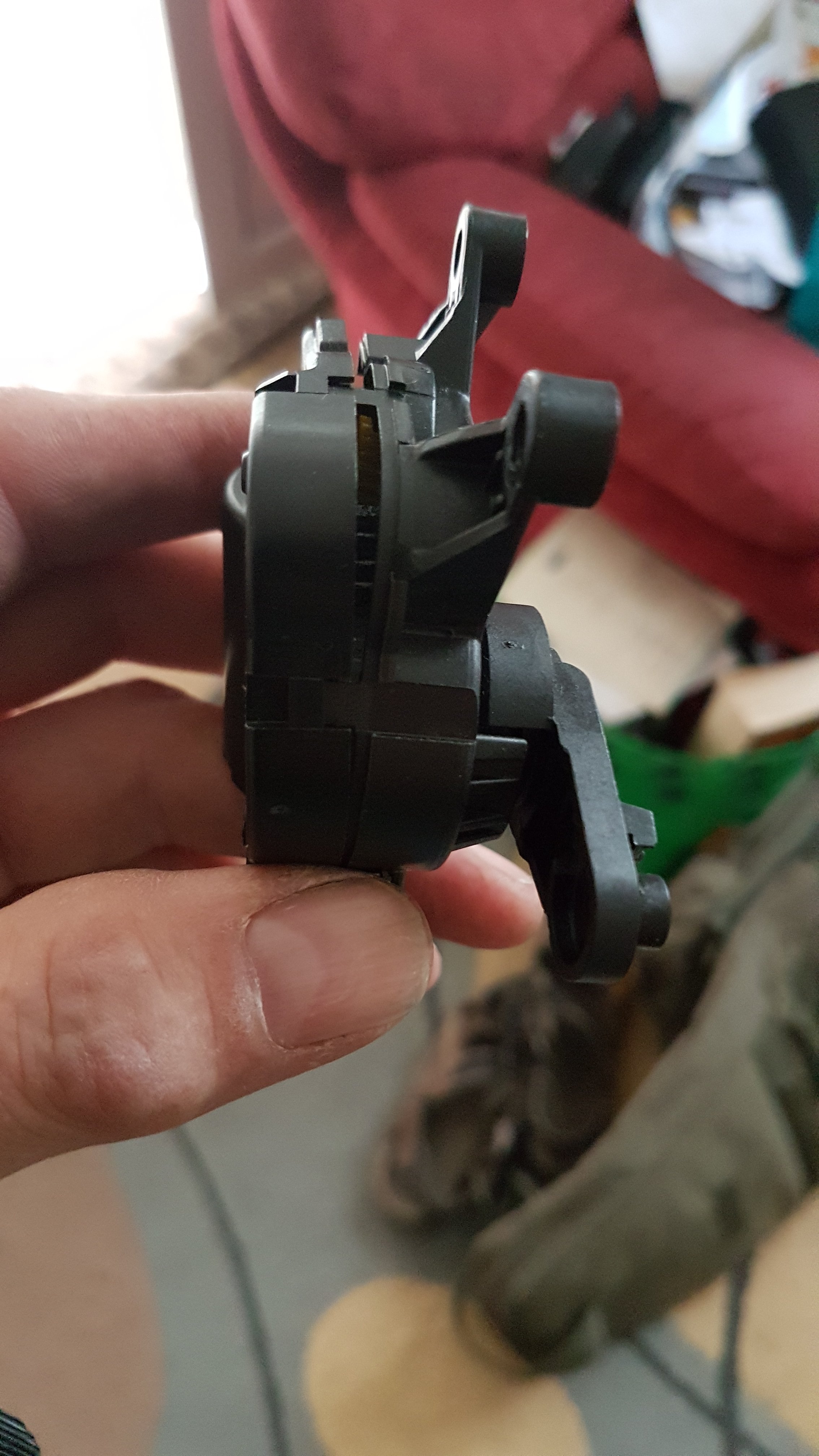

After somemore prodding and tablet having power, it seems left temp flap is stuck.
So, how to free it off?
Maybe cambelt was just a coincidence
Update
Found out how glovebox comes out. Tirns out the flap motor casing had partially come apart. Clipped back together,reinstalled and scanned. It did it again. Take out stick a cabletie round it and rescan. Do the flap thing with vagcom and no fault codes.
Shouldve noted part no as there may still be a fault with motor.
