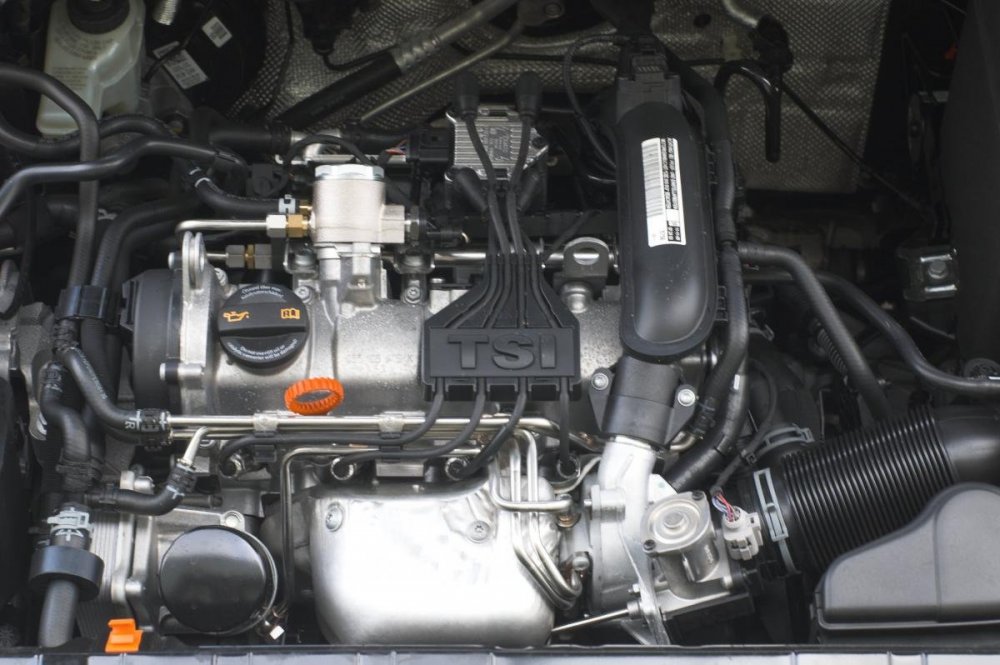

Heres a pic of a 1.2 tsi without marten protection (corrugated trunking) on the leads
and one with marten protection
Don't worry about the different plastic covers/holders with TSI on them that's cosmetic. The corrugated trunking is located forward of the "TSI" cover. Just be aware that no. 1 & 2 leads clip to the stainless steel pipes that run along the front of the engine. New larger clips supplied in the kit, make sure they're fitted otherwise the lead trunking ends up resting on the hot exhaust cover and melting.

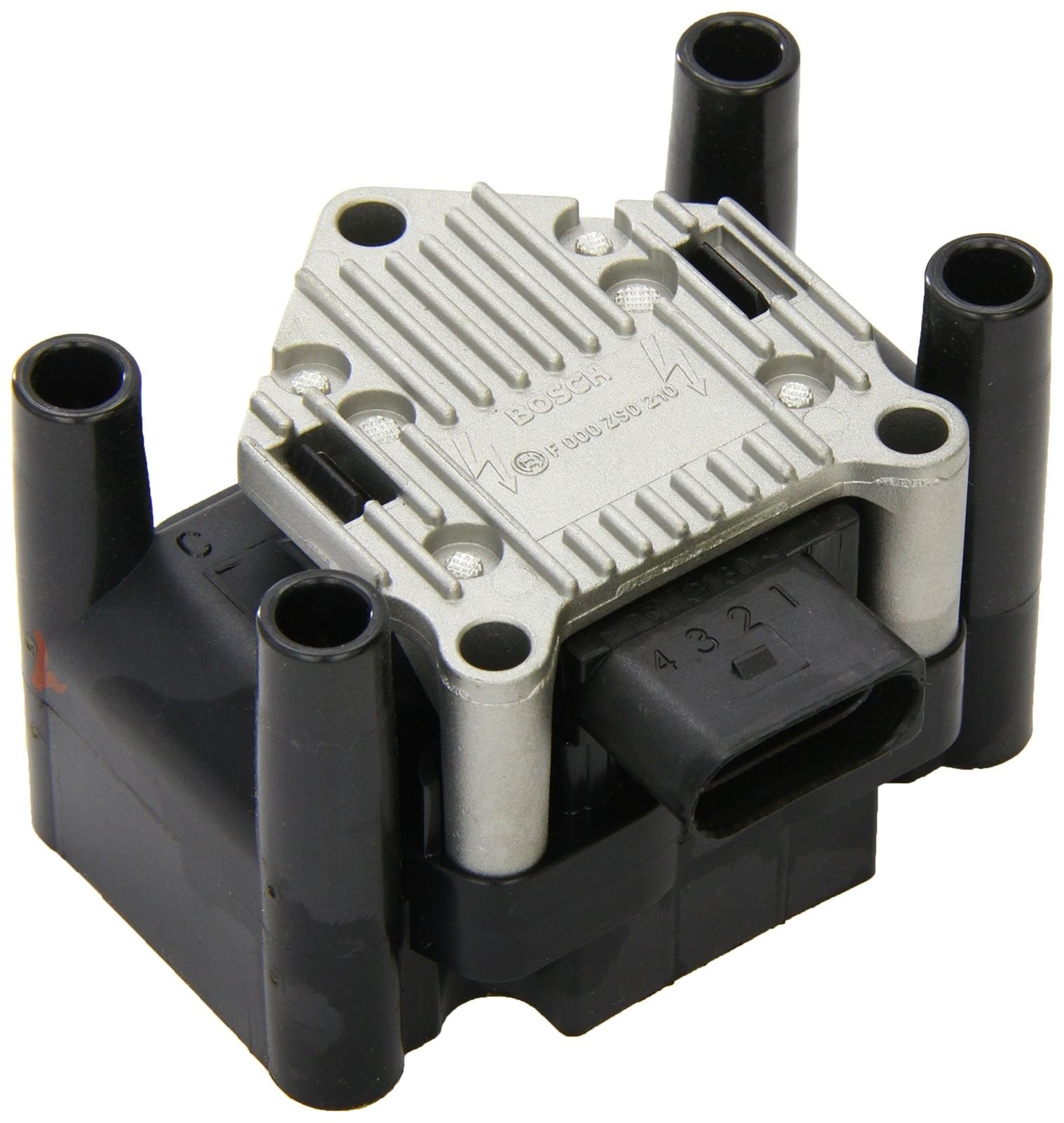

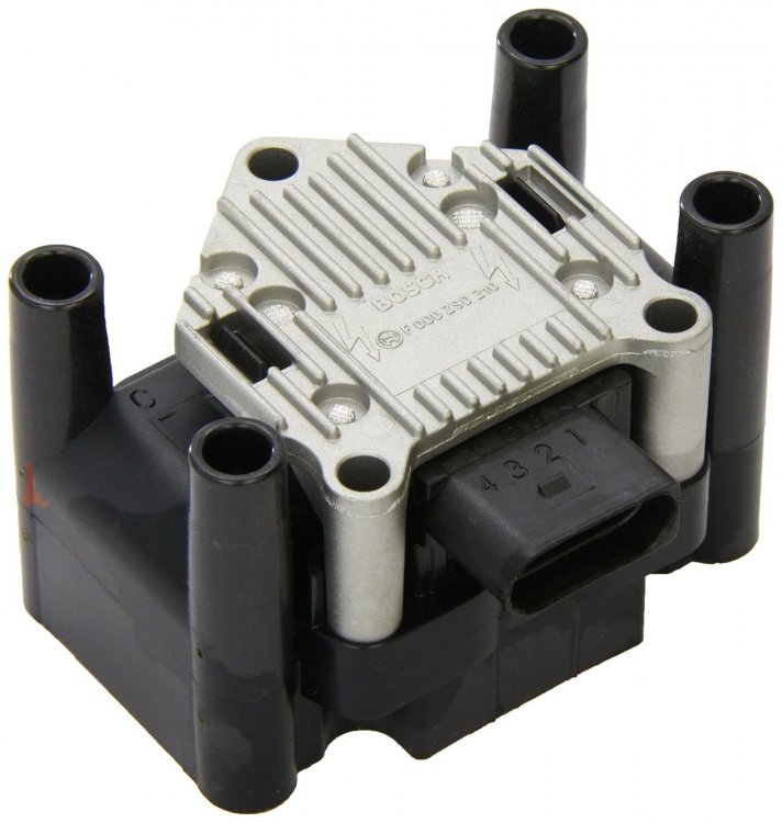

The ignition coilpak is a 4 coils in one, single item supplying all 4 plugs. Its possible it has been compromised by the previously/lead problem, tracking internally and weak spark.
Easy to change part no 032 905 106 B/D/E  E is the latest version
Available from usual places, eurocarparts, gsfcarparts, eBay, amazon  etc seen them for under £20 new.
