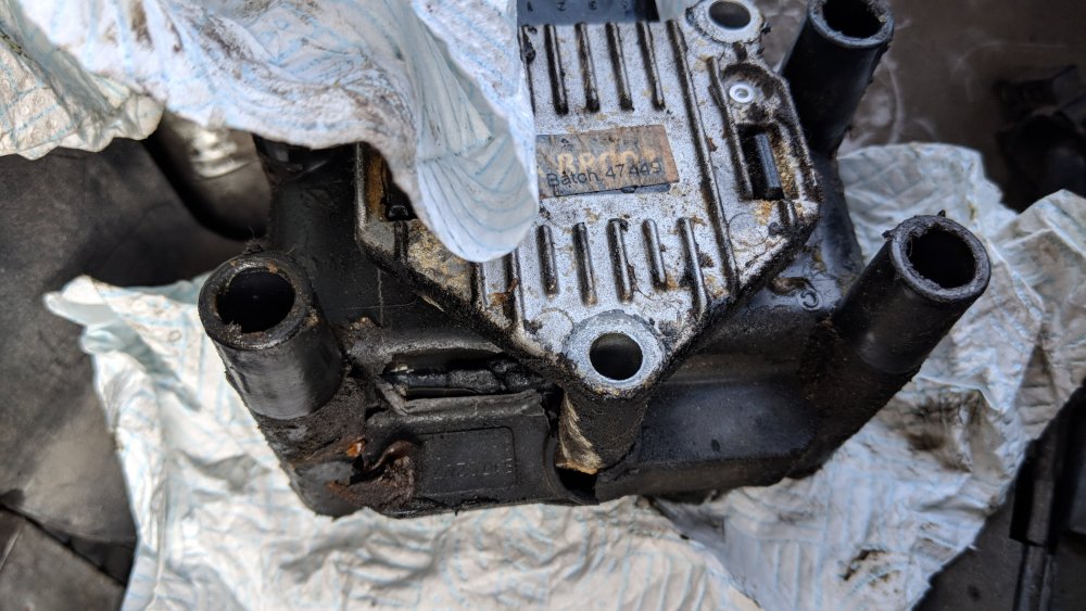

Just change the coil pack - they are not too expensive and a very common fail and a very easy fix. Symptoms are when you floor the throttle you drop onto two cylinders as the spark is weak on one coil (there are two coils within it feeding four plugs - which is why it's called a wasted spark coil pack). I have the same coil pack on my Octavia and it seems to fail every 8ish years. For some reason unless really bad (it gets worse and eventyually drops to two cylinders all the time) it doesn't always throw an error code.
Get it sorted asap as everytime it drops to two cylinders neat petrol hits the cat!
Image below is when the coilpack failed for the second time on my Octavia 1.416v - well it is 17 years old now! Note the big holes bottom left. Saying that when the first one failed there was no physical signs. PS really easy job - pull off electrical connector and four ignition leads (note the positions) and undo 3 bolts. Took me a couple of minutes.
PS Yor money is not totally wasted on the spark plugs/leads (pardon the pun) - the fact it made a difference helping the weak coil pack showed they were probably past there best anyway.
This is a picture of the one I recentley took off my Octavia 1.416v - note the big hole bottom left!
Edited by bigjohn
