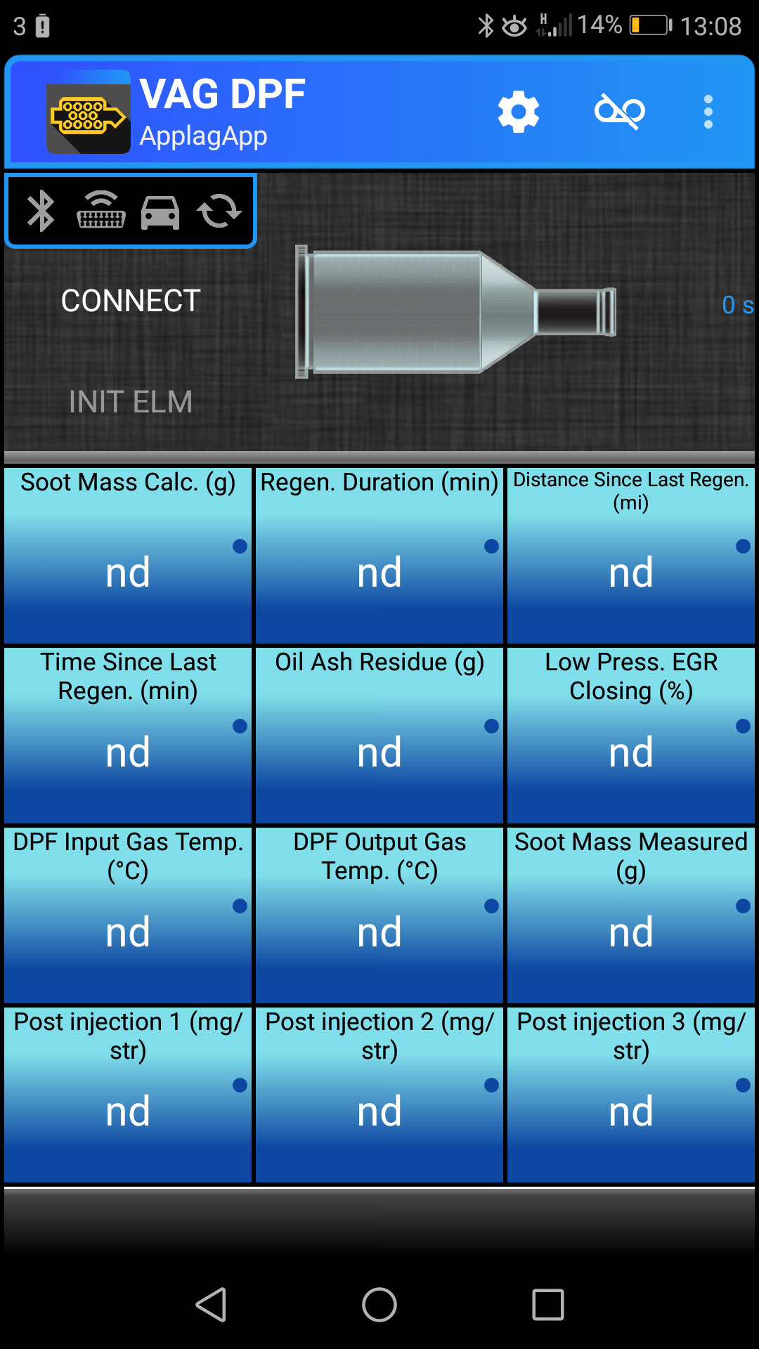

I got the VAGDPF app and with a Bluetooth dongle plugged in the OBD2 port it feeds data to the app telling you what the DPF it's doing.
Will see if things calm down with the cleaner going through and if not will steal the kids phone's and connect it up and see what its up to!

If you wanted to try something different then try Archoil 6400dmax into a tank of fuel every 5000miles and then 6900 every second tank of fuel, use code EA189 on www.powerenhancer.co.uk to get 20% off, this is as recommended by the EA189 emissions reversal group.  As others have said, VAGDPF on Android is brilliant at monitoring the vehicle, infact, it saved me recently when a temperature sensor gremlin prevented mine from doing an active regeneration and going beyond 100% and well on its way to the DPF light coming on at 30g soot, if I had only had the DPF light come on then I would have been stranded because I wouldn't have had enough miles left on the DPF to get home and to the dealership, or worse, I may have thought I could clear the DPF light by driving hard and fast and making the problem worse as a regen was never going to happen.
