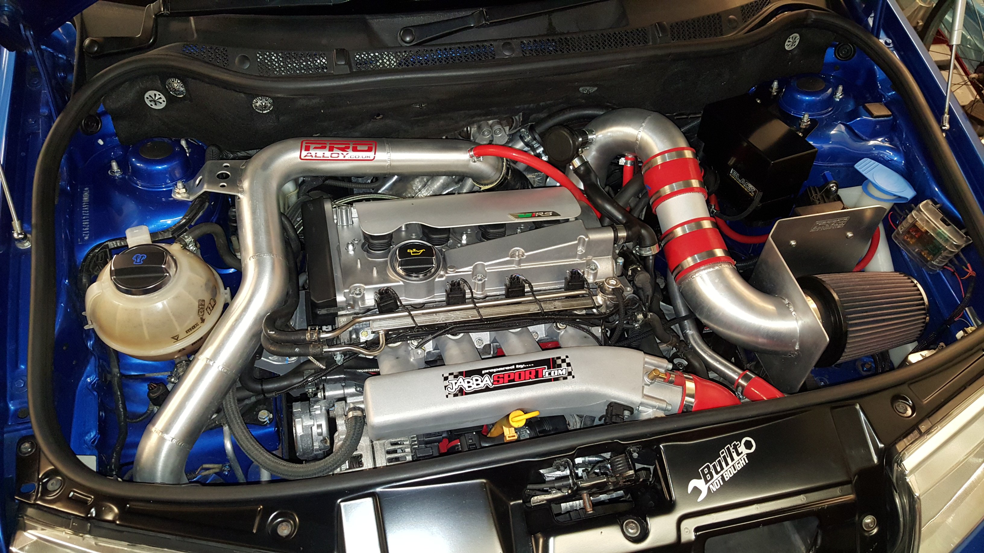

There is no grafting required as such. All the correct mountings etc are available off the shelf.
You will need the correct gearbox, the 02J from the Leon etc has a different casing where the mounting bolts onto. The mounting can be refabricated but its easier just to get the right gearbox in the first place. You will have to then get the speedo drive etc sorted out as the MPI will use an impulse sender and not the ABS signal like the later cars do.
Edited by Tech1e

Yes the car pictured is my car and I converted it myself.
As as I mentioned the 02J box won’t fit without modification. The 02R is the correct box and will bolt up.
I have a thread on here on here for the project.
