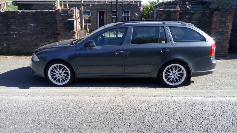

You can get Eibach which imho are some of the best you can buy, depending on which car you have diesel/petrol, estate/hatch you can get a set off German Ebay for around 120 quid delivered, I had the same problem front spring snapped on MOT fitted a set of Eibachs and the car feels a lot nicer to drive and is not too low only about 15mm lower.
