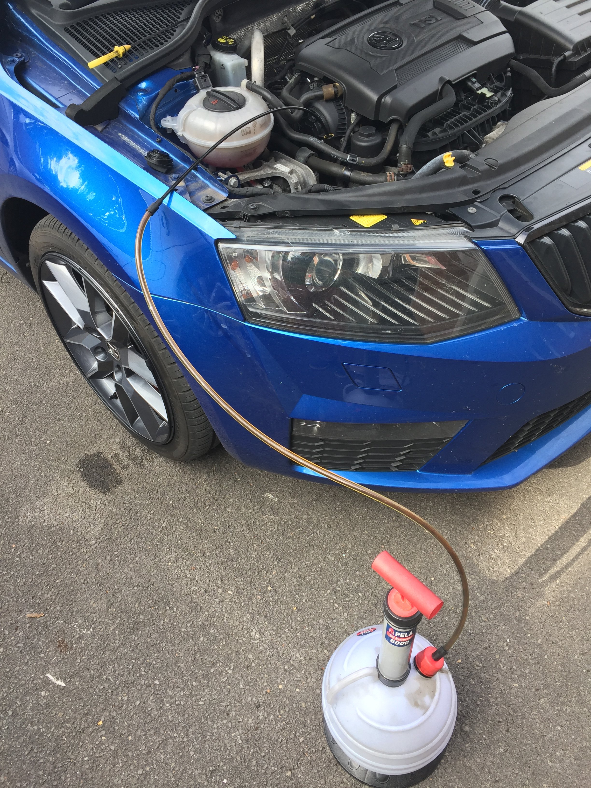

Hi - i’m one of those strange people that likes to change oil again in between normal service intervals, so please bear with me!
I have looked at other threads but just wanted to be 100% sure. Is it ok to use Quantum Longlife III 507 grade?
I’ve only ever had diesesl before this (pd and CR audi, VW) and it just feels strange that my petrol should also be using the same oil!
secondly I plan to do the change with a pele oil extractor as quick and easy. I’m guessing there’s nothing special about petrol tsi engines which do not allow an oil extractor to be used?
thank you!

Thanks for all the replies folks. Did the oil change with Pela oil extractor - all good very easy to do.
Scot5, I’m a bit funny about oils. The oil I took out is noticeably thinner (even once its cooled down) compared to new stuff and its only done about 5,000 miles. I was a member of ukpassats where oil changes became risiculous with people on there doing them every few thousand km. its cold start that i’m mainly worried about.
