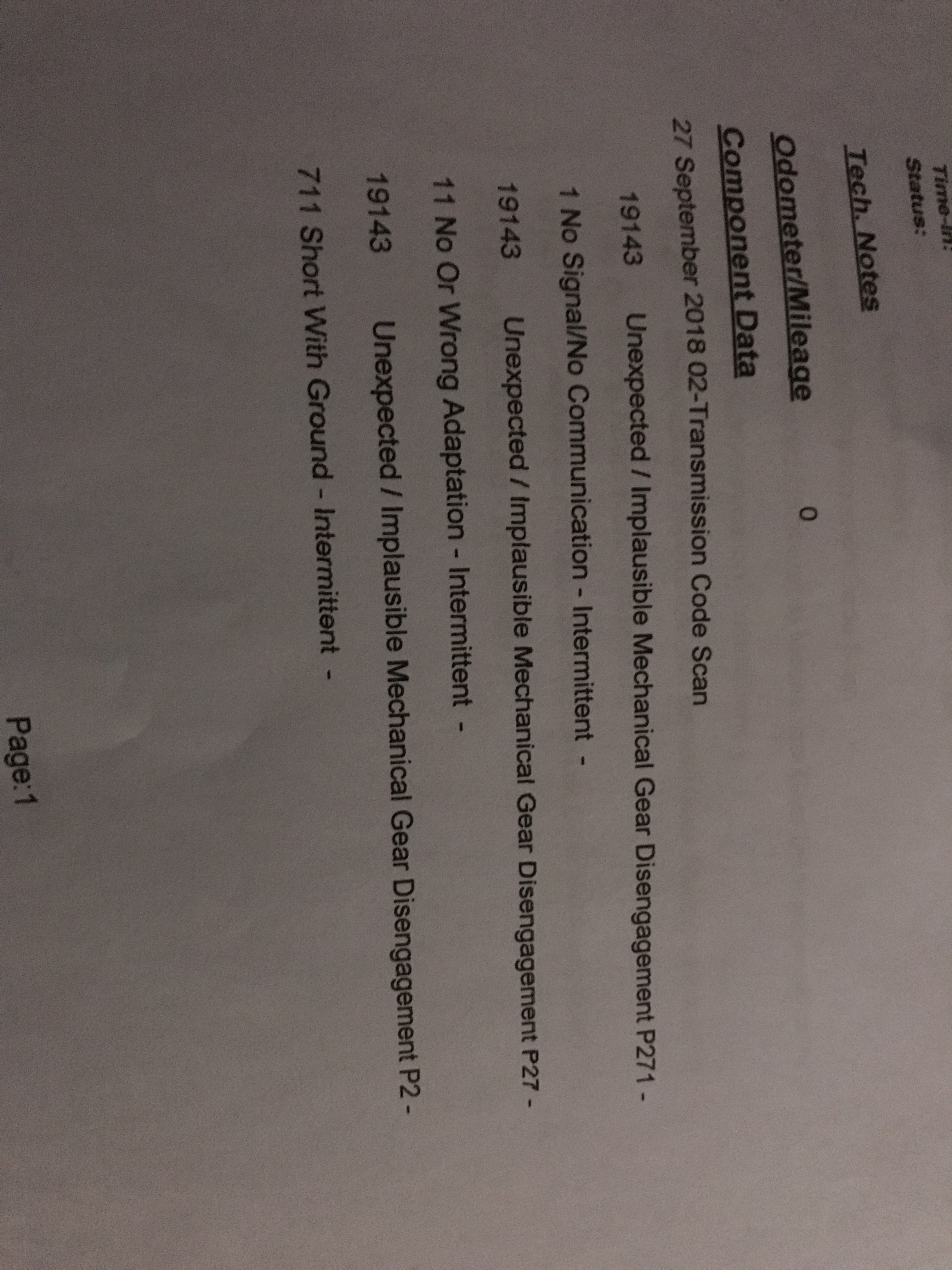

i have had it scanned and a fault was logged for unexpected disengagement with I had put down to me putting it into N whilst moving??
What software, if it is VCDS or ODIS, you'll get a specific error (if any), if you used a generic error scanner, you won't know what is actually going on.

It was scanned with a snap on unit
Mileage is now at 228000. Lots of service history but not one mention of a dsg oil change
It is interesting that out of all the errors, you (or your mechanic) sees the unexpected disengagement as the major issue, but not the intermittent no signal/communication and the wrong adaption and the ground short errors ... :blink:

The excerpt that you've posted doesn't give us any specific info what equipment was used, it may actually be VCDS, VCP or ODIS (or it may be a generic type (i.e. Delphi) ... the errors listed should first be cleared and checked, to see what remains ... I doubt all 6 would return all at once immediately after clearing ... like @Offski mentioned, you may have a general issue with the mechatronic module (the brain of the gearbox), due to improper servicing (one potential cause, not the only one of course)
Thanks for your input, I will get it cleared and re scanned tomorrow and report back
