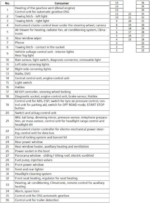

How about removing fuse 13 on the drivers door A pillar for a while, that is also for the Radio/DVD.
Yeah, I'm with Urrell. I had issues with my Columbus when I first bought the Yeti and all were cured by removing fuse 13, leaving it out whilst I made a cup of strong, North East tea then putting it back in and restarting.
Thanks guys, I did remove that fuse as well but I'll try it again, maybe leave it while I have a nice cup of tea, as I just left it a few seconds last time.
