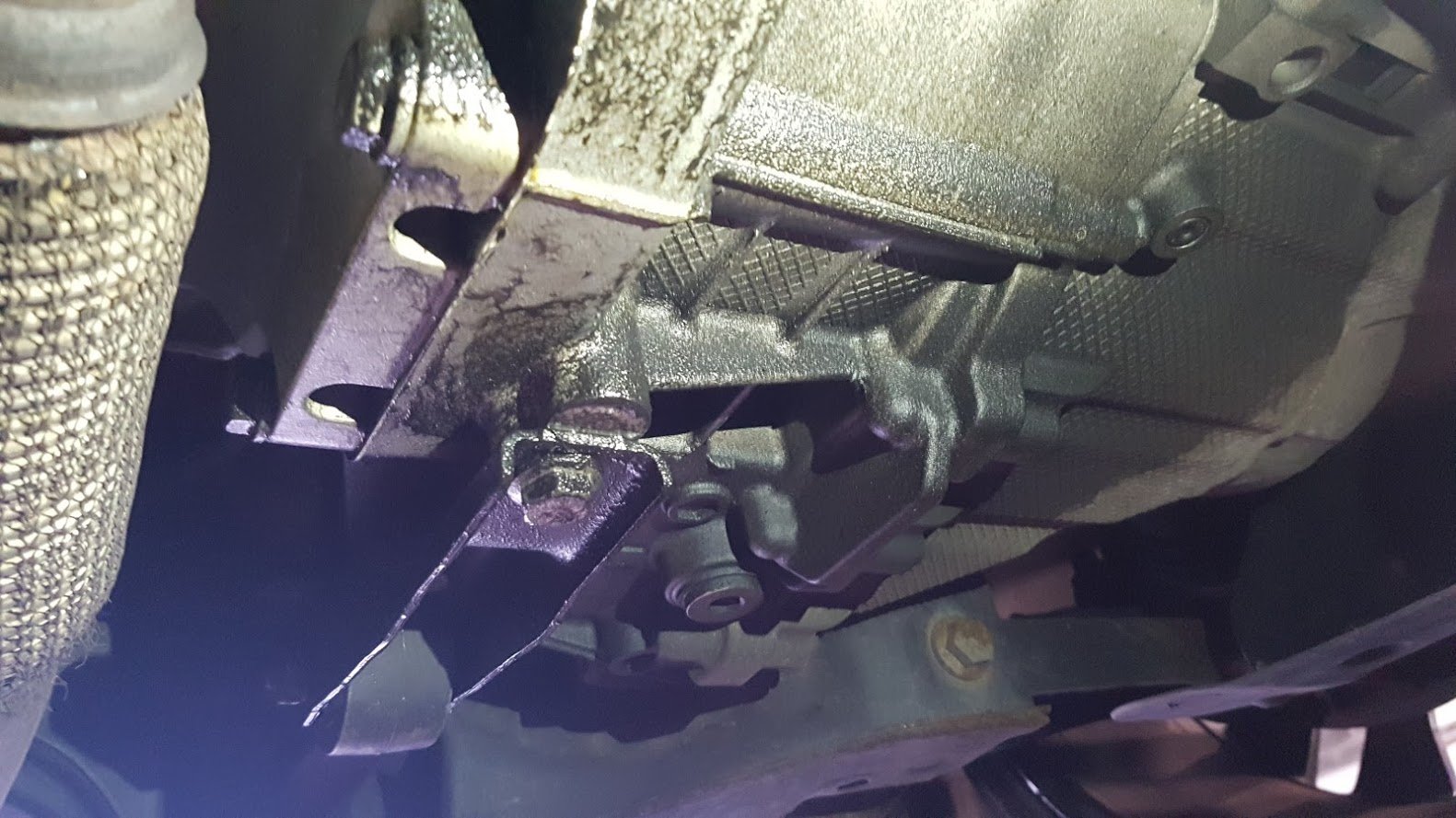

Thanks for all the information.  I rang the (independent) garage back that serviced my car and asked them for a price to repair the seal...but the guy couldn't remember my car (and hadn't written it on the invoice) and couldn't be sure if it was the gearbox or the driveshaft so he's asked me to bring the car back for another look.  Dropping it down later and he's going to put it up on the ramp and have another look.
Okay, so I went back to the garage and he put the car up on the ramp.  He showed me the leak.  He said it's the seal in the gearbox that is leaking.  Will be bringing it to Skoda next week.
So got the car back from Skoda...they said there was a very slight leak from the rear crank oil seal.  Said it would require the gearbox to be removed to replace the seal @ 9hrs labour + parts, it would be at least €1k.  They seemed to think that it isn't really serious enough to warrant going to all that expense as it's not using any oil....Not sure what to do

Find a very well thought of gearbox specialist and see how much they would quote for the same job?
If they're 100% sure it's not leaking from the mechatronic unit then it's not the worst outcome it could have been, replacing the mech itself is £1149 for the part plus vat plus fitting.
New engine fitted over 2 years ago.
Yet another crap one out of a crate it would appear.
Has the engine been cleaned yet to see properly where the oil is from?
Please do not go dropping oil on the road.
That's what has me confused..
The new engine doesn't use a drop of oil...I've never had to top it up between services and there's never any oil on the ground where I park...and sometimes my car stays in the same place for days on end as I cycle to work.
It never tales much oil or ATF or whatever to make a mess when leaking or getting forced out.
