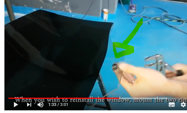

Hi - can anyone help me to locate the part number for the apparent x2 rings that fix either side of rear window, as per arrow  in picture?
The window dropped into the door and with much faffing with coat hangers I've managed to fish the window out.  However, these rings are missing.  Elec regulator system seems to be in tact.
p.s. screen shot is taken from this video re window removal (
Thanks
Edited by hwl100
Is it this one?
WHT003849
