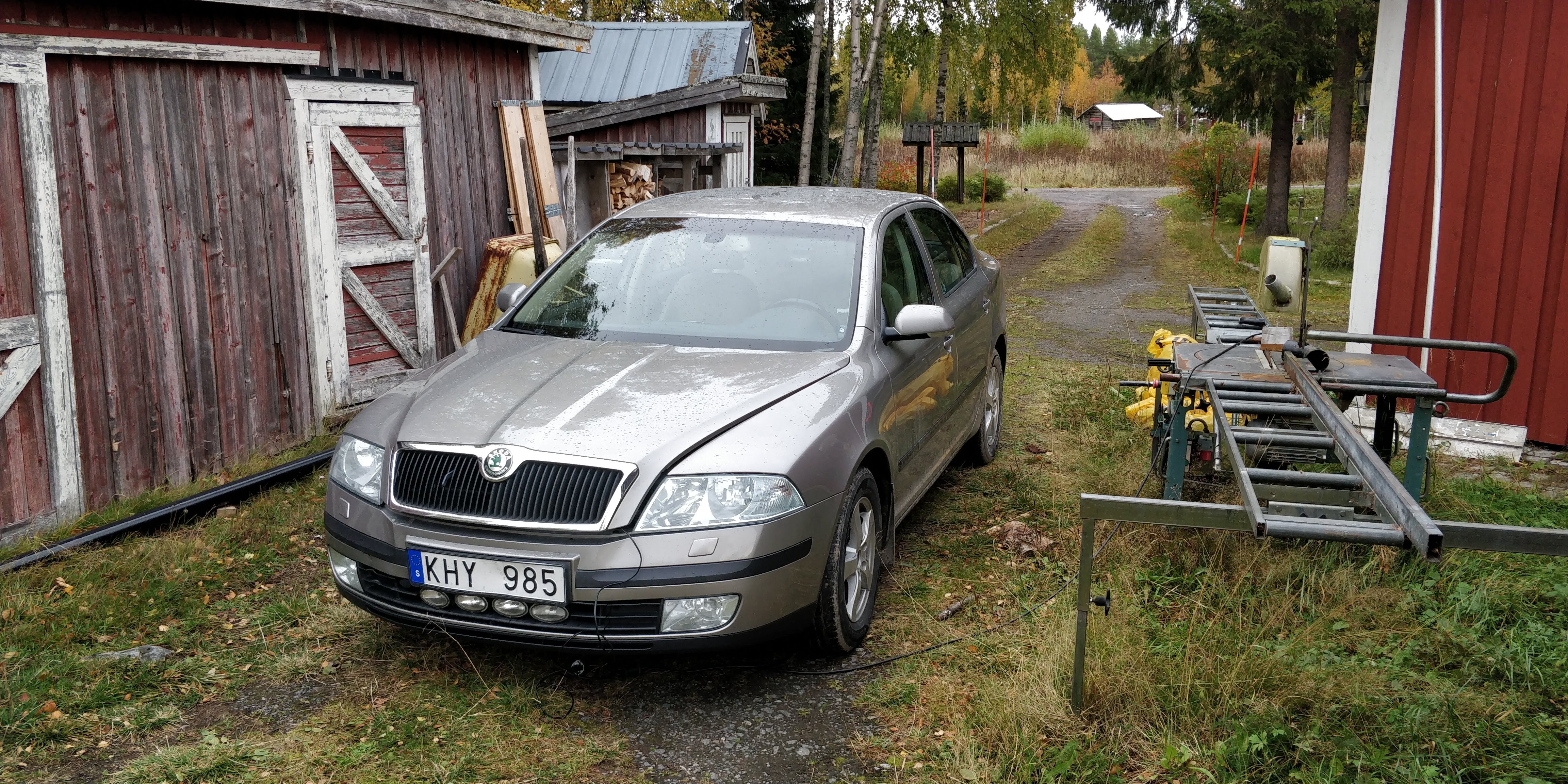

Heres a photo of it being recharged outside my house :biggrin:
