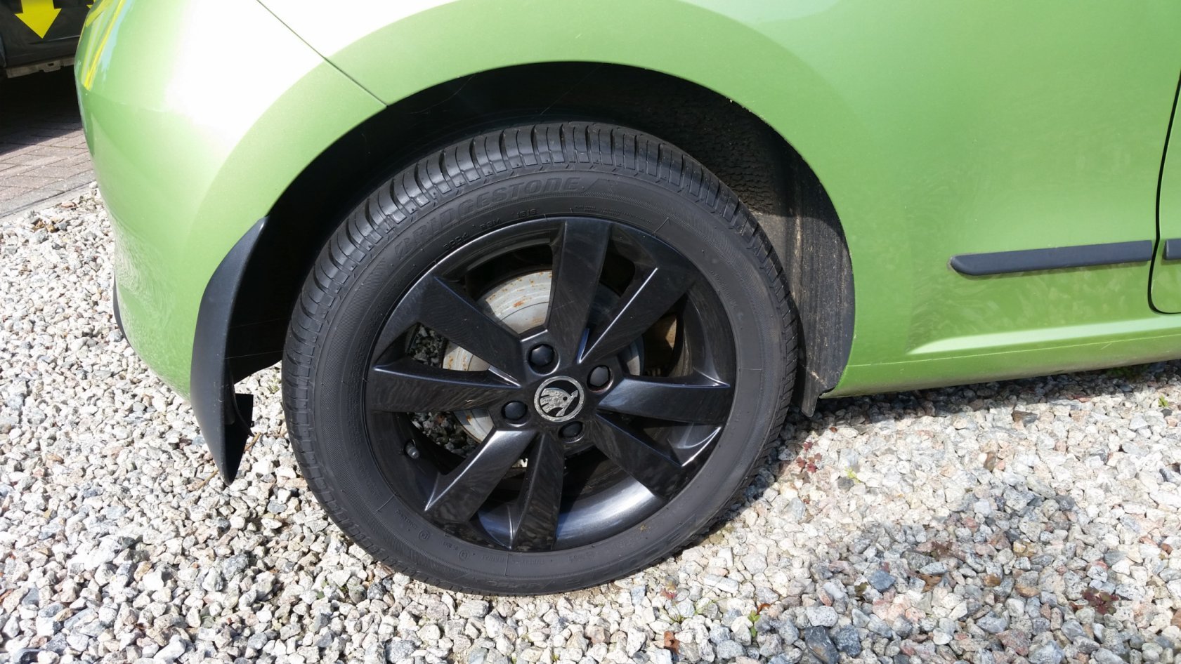

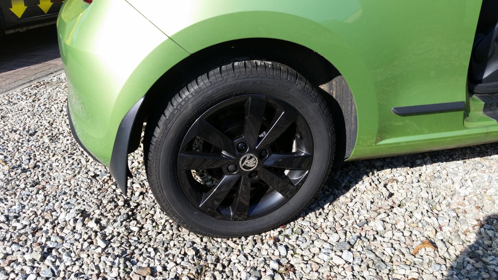

Painted brake drums this afternoon now I have black Aurigas fitted.
Before with grey drums;
After with black drums;
Looks much better I think.
Well worth doing that looks so much nicer in my opinion :thumbup: Paul n Tash

Or is it just a reflection of the stones on the ground?
Edited by Eltezz
Just a reflection of the gravel. Wheel centre caps are new.
