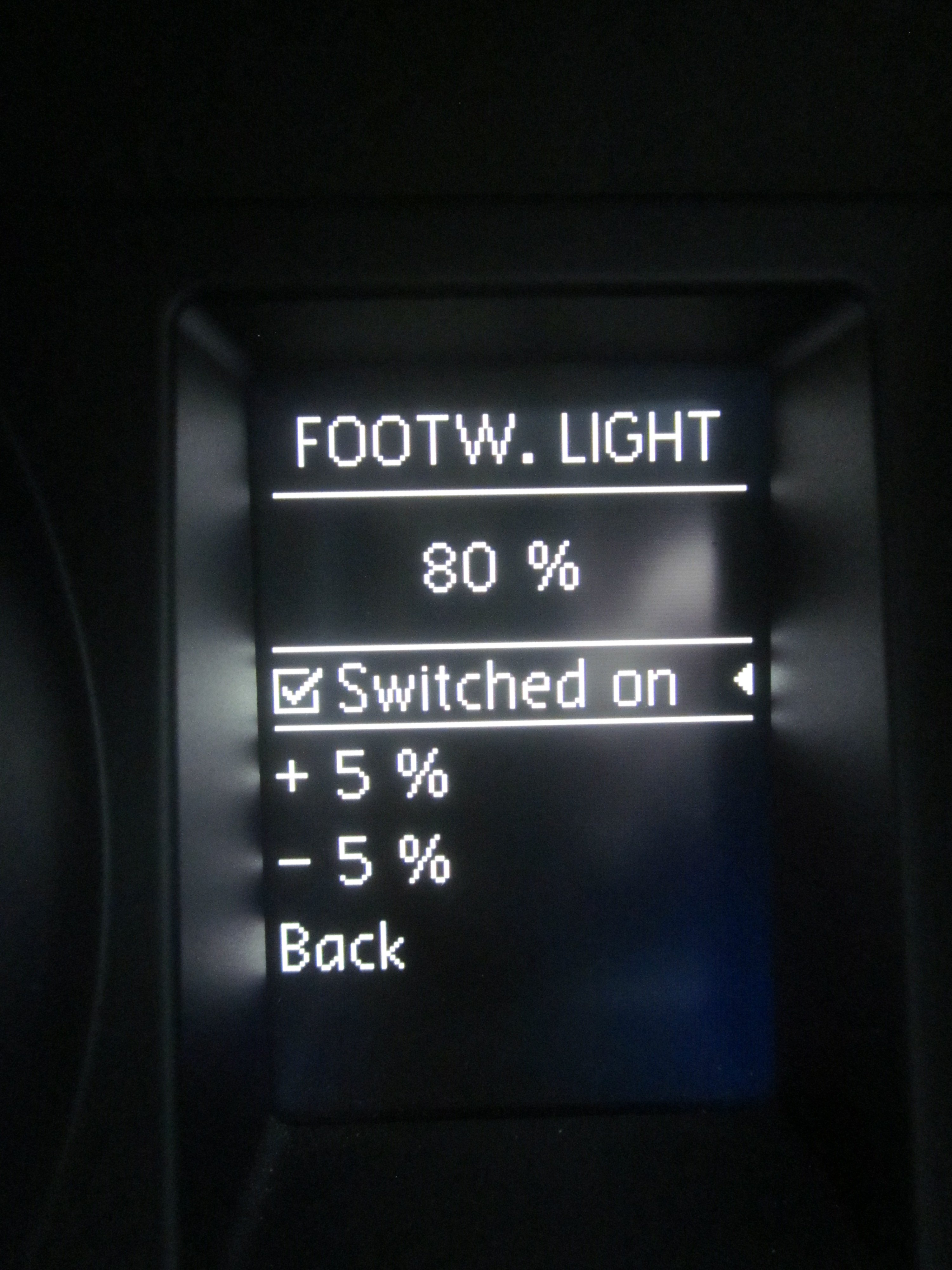

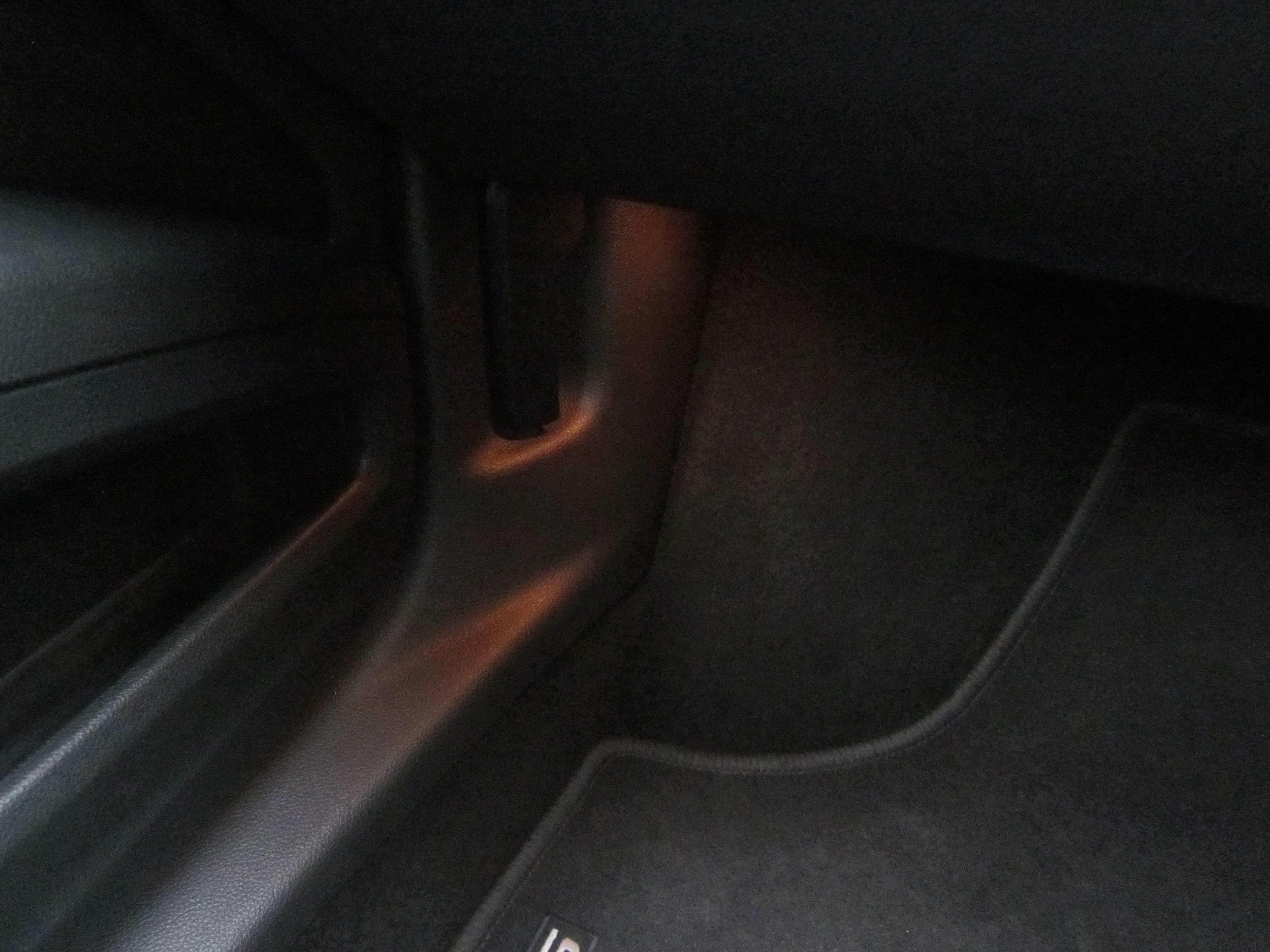

20 hours ago, MarkTB said:
This is only a coding thing, as I activated them on my 2011 SE through VCDS - this is the sequence I posted from the linked topic above:
1. Select control module from VCDS main screen
2. Go into '09- Cent. Electrics'
3. Select 'Coding'
4. Long Coding Helper (if you've not already saved a scan, take a note of the coding before changing)
5. Go to 'Byte 12' and select 'Bit5' (Footwell lights with Terminal 58d active).
Boom! A few clicks and my SE is now an Elegance wannabe!
Thanks to @MarkTB and @langers2k :thumbup:
Lol, welcome to the club! :rofl: Not a problem, happy to help. :thumbup: ;)

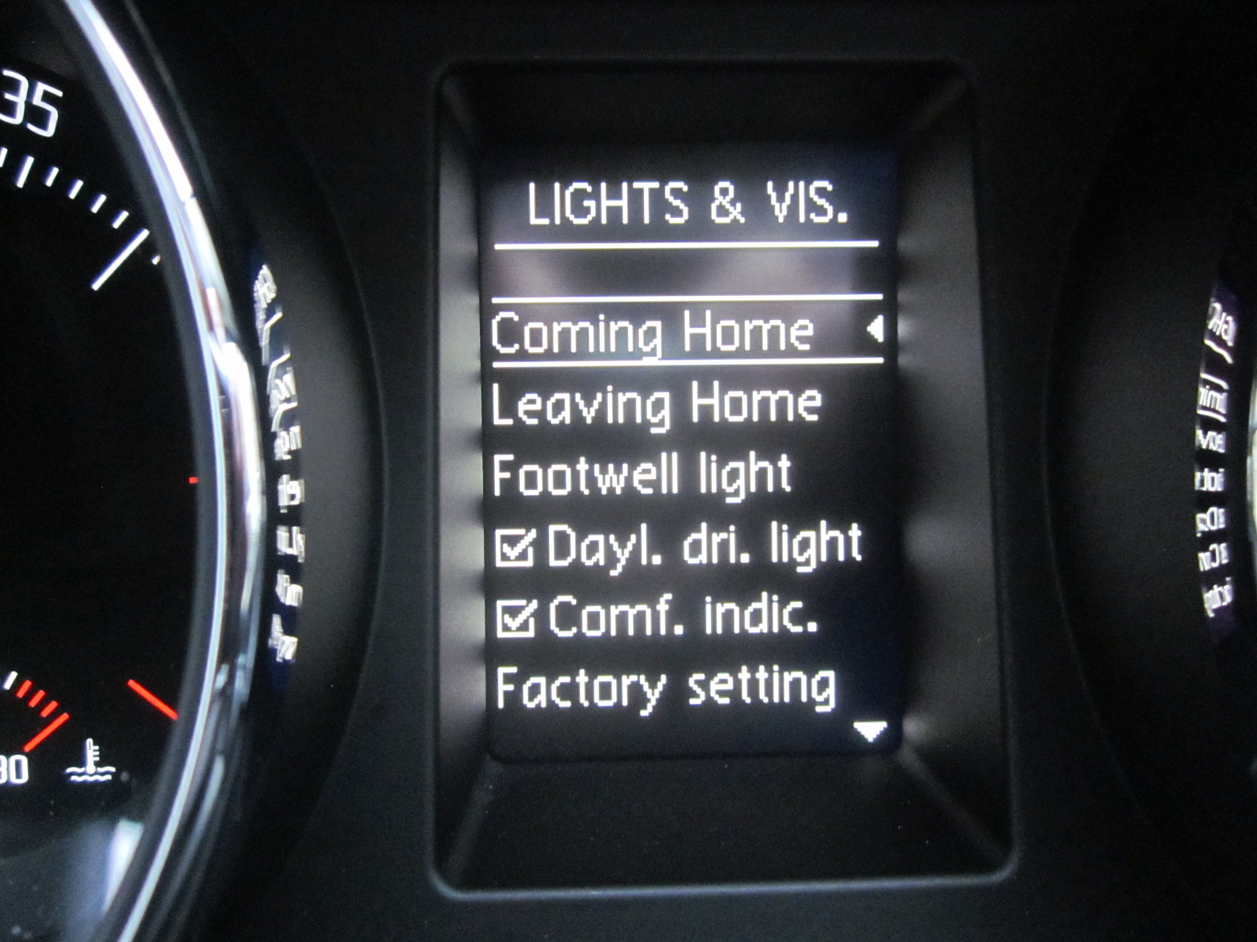

@silver1011 - Did you have the footwell lights option in the maxidot before turning on the Terminal 58?
No I never, I should have taken a photo, but 100% it wasn't there, I checked the other day.
I have it reversed, I have the option from when I got the car, but the lights don't work, unless the doors are open (believe me, I've tried every single option there is, and not only on my car) ... seems to me there are fine differences in the features because of the BCM module part no. (or, whether or not someone somehow updated the BCM's firmware - this is usually done at the dealership, if they have a recall or they're trying to fix some other issue on the car)
Mine is a 2011, I'm guessing the BCM is different?
