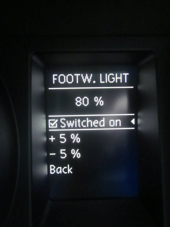

Hi everyone, I have an issue with my footwell lights. The thing is the lights are going on when entering and exiting the car but they never stay on while driving even tho the option on maxidot is turned on. Is it supposed to turn on only when entering and exiting the car? ( Skoda superb 09 plate)

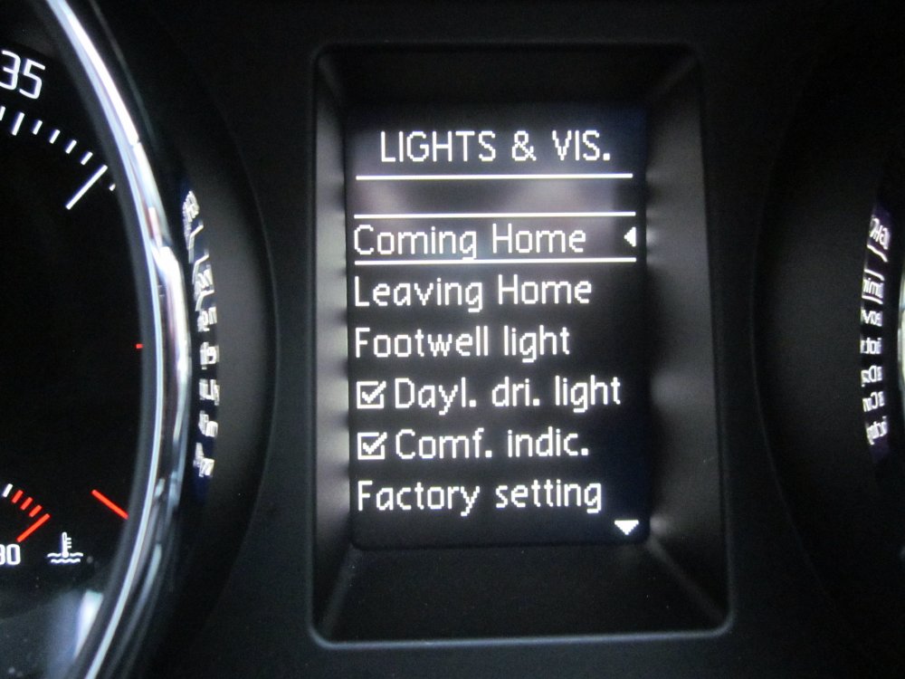

My footwell lights are on with the doors open or when the headlights are on. The menu shown by the OP controls how bright they are when the headlights are on, they are always full brightness with the doors open. It might vary depending which BCM is fitted.

That should be enough and then it can be controlled by the maxidot as per the first image.
I have that in the maxidot, but the selected light intensity only applies to when the doors are open - when they are are closed, the footwell lights go off.

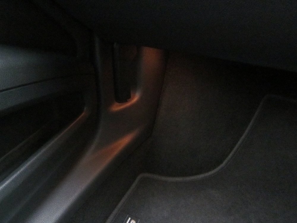

My footwell lights are on even with the door closed.
Footwell lights illuminated whenever headlights come on. MY (manufacture year) 2012

It's available on the Elegance too. Mine stay on at night with the doors shut but at a low level (MY 2012), along with the 'moonlight' LEDs in the overhead console and the LEDs in the interior door pulls. Just enough light to see stuff without being blinded.

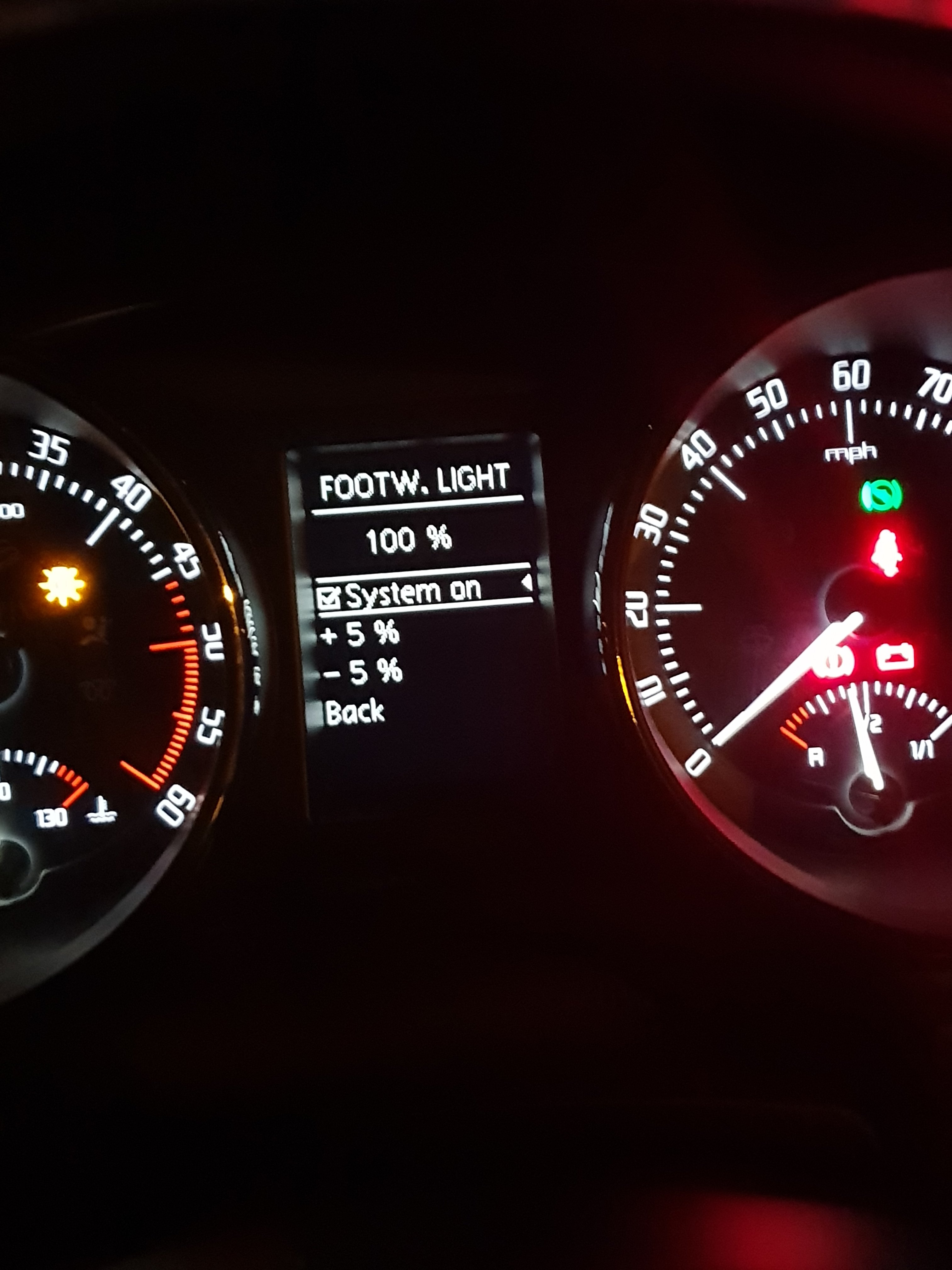

This is only a coding thing, as I activated them on my 2011 SE through VCDS - this is the sequence I posted from the linked topic above:
1. Select control module from VCDS main screen
2. Go into '09- Cent. Electrics'
3. Select 'Coding'
4. Long Coding Helper (if you've not already saved a scan, take a note of the coding before changing)
5. Go to 'Byte 12' and select 'Bit5' (Footwell lights with Terminal 58d active).
